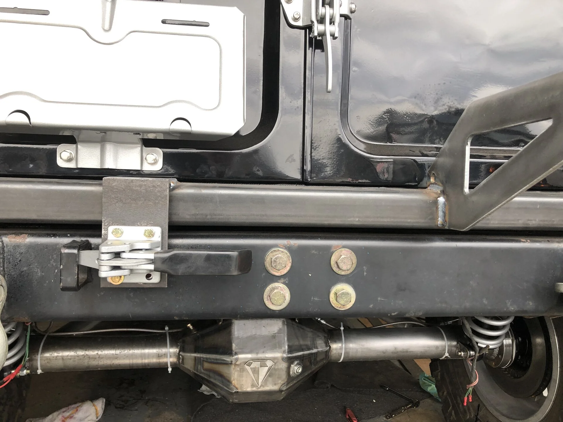

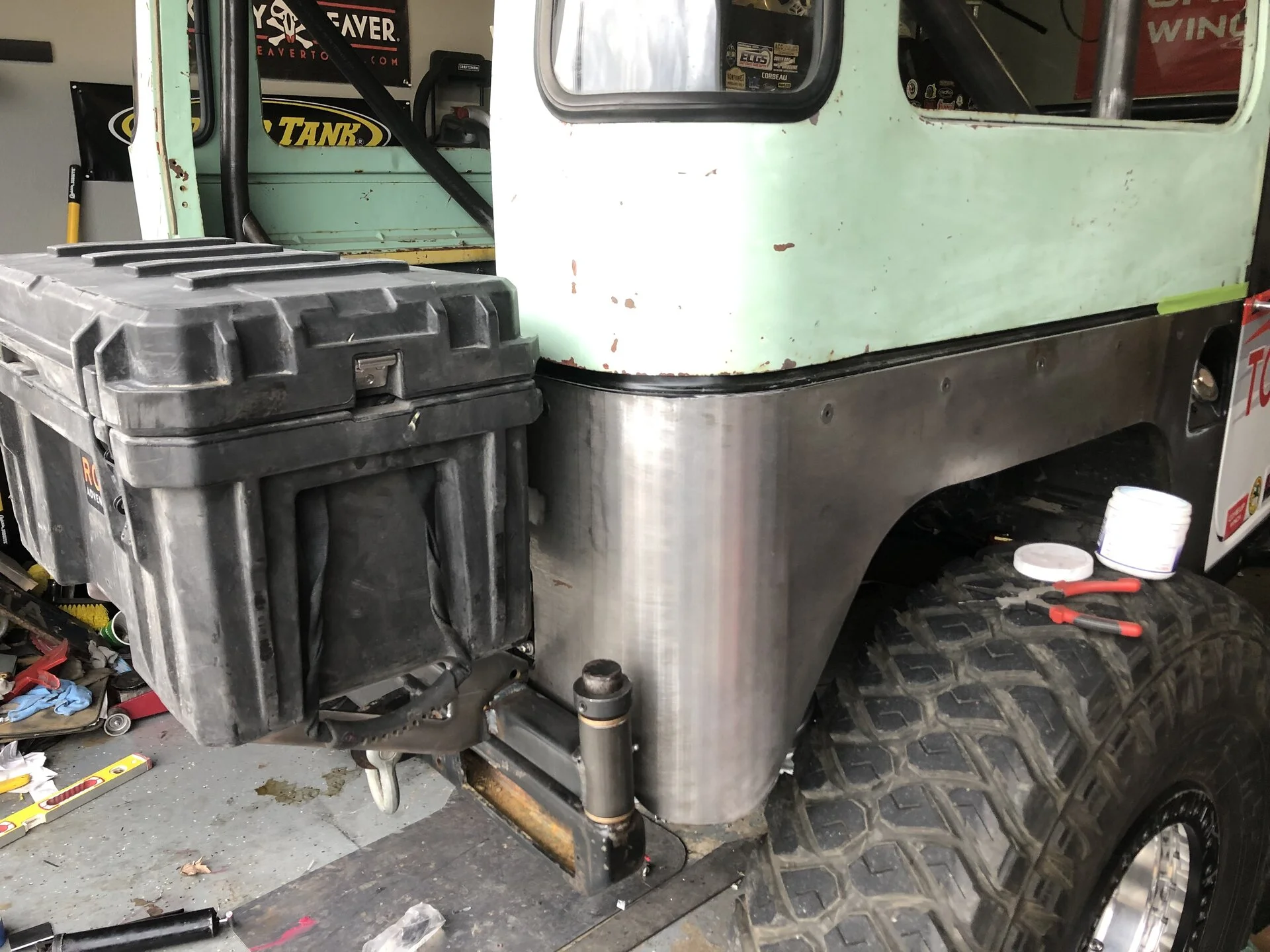

the rotopax
Oh ;). i was just setting it there to get ideas . No the basket holds 3 Gerry cans . i will most likely put my ARB fridge inside . Coolers do not work well on the Rubicon .
So I can run this a few different was depending on what trails I plan on doing. Can take the basket off in less than a minute and run a storage box. Or the basket with a cooler or 3 fuel cans.

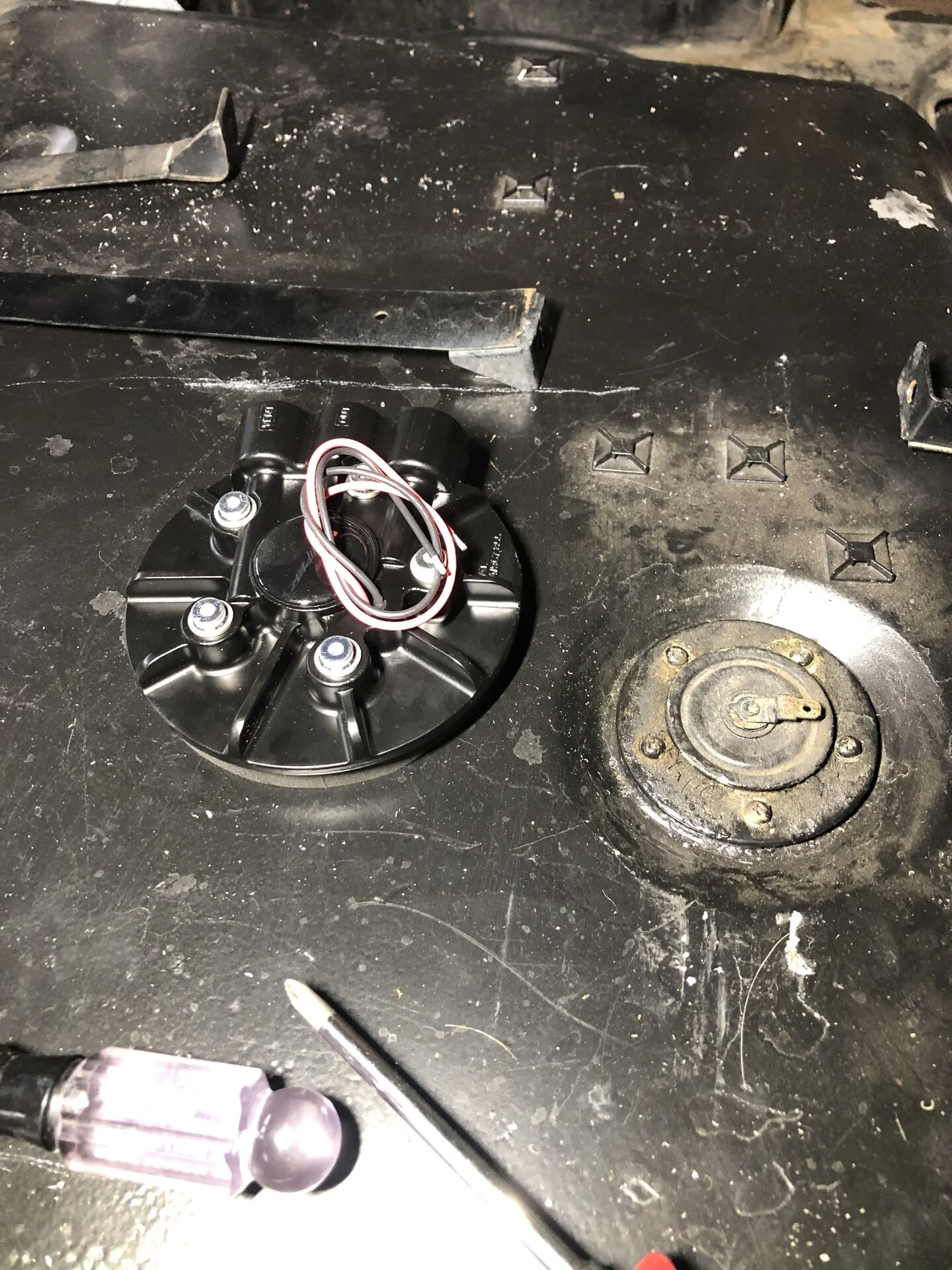

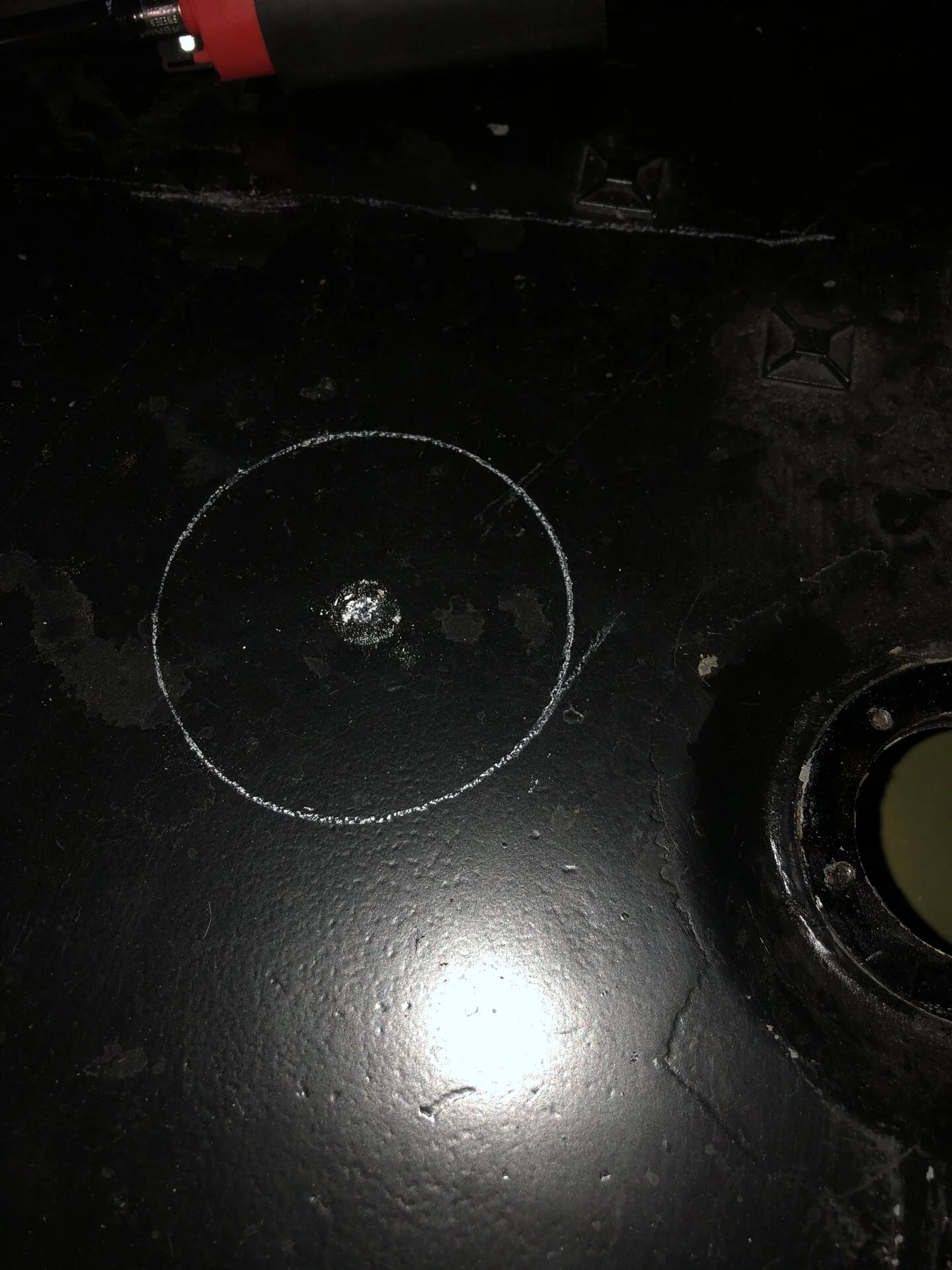

Fuel pump is in 😃

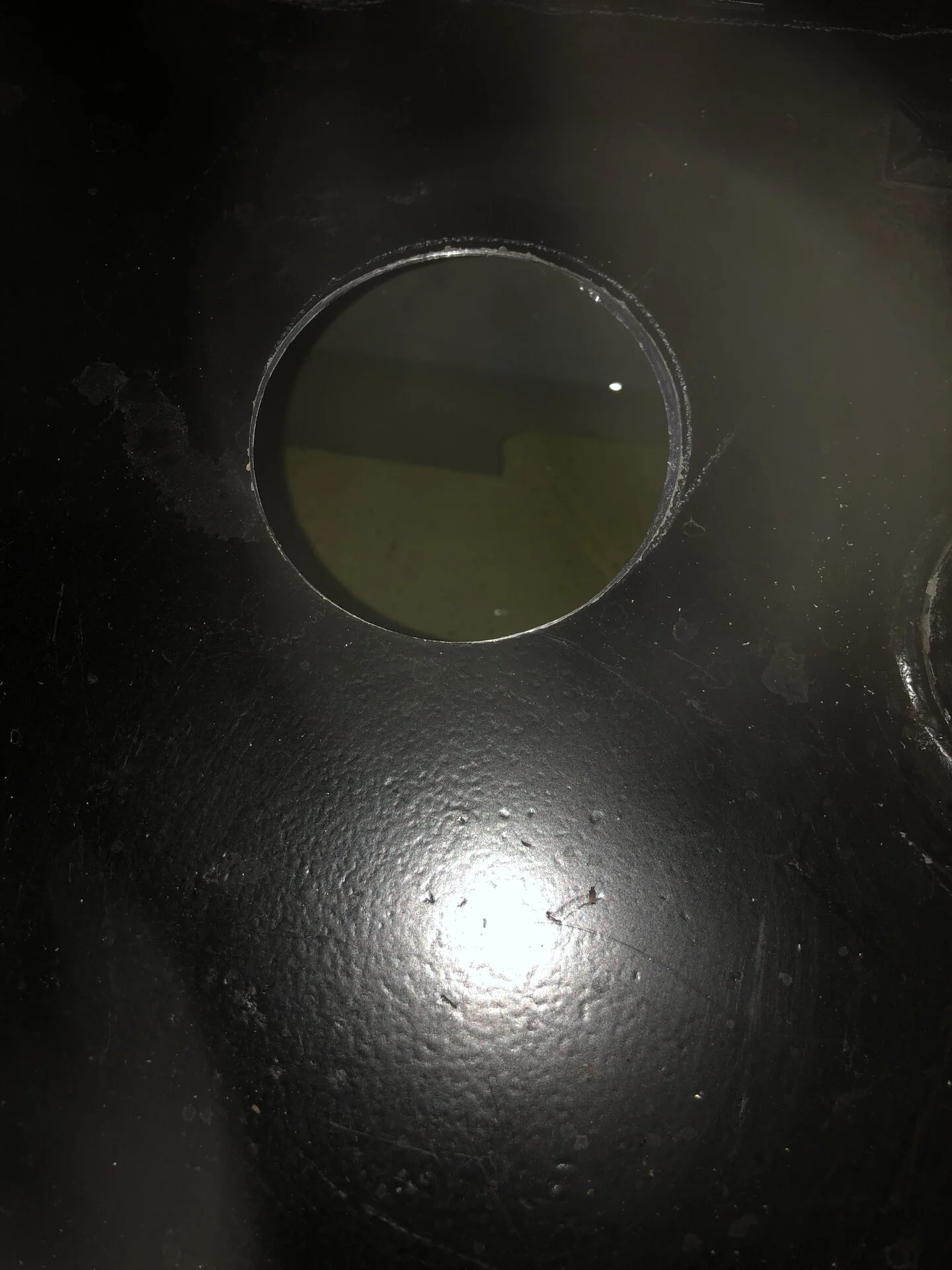

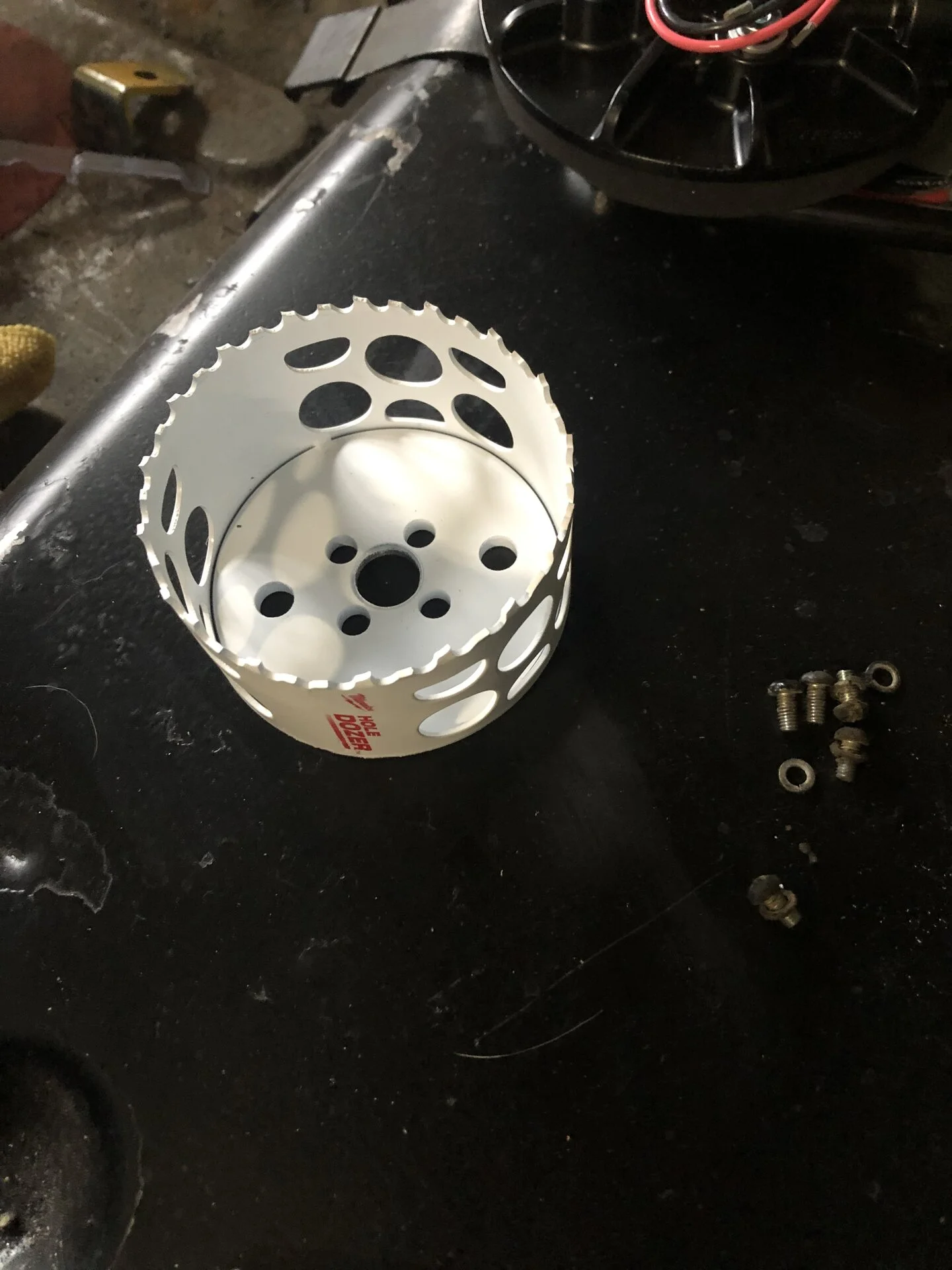

A few things to consider if you ever install a in-tank pump. . I went with the Returnless style so i only have 1 fuel line to run . Make sure you look in the tank to see where the baffles are . also make sure the fuel float is not going to interfere with the fuel pump . i pulled the float out and layed it out first . you want the pump pick up at the lowest part of the tank as well . Mine sits just in front of the drain bolt now . I have 4 wires to connect. that is it. Pos and Neg to the battery . 1 wire to a keyed switch. and 1 to my fuel pump. super simple . everything else plugs in . My 02 sensor is already in. had that installed when they did the exhaust

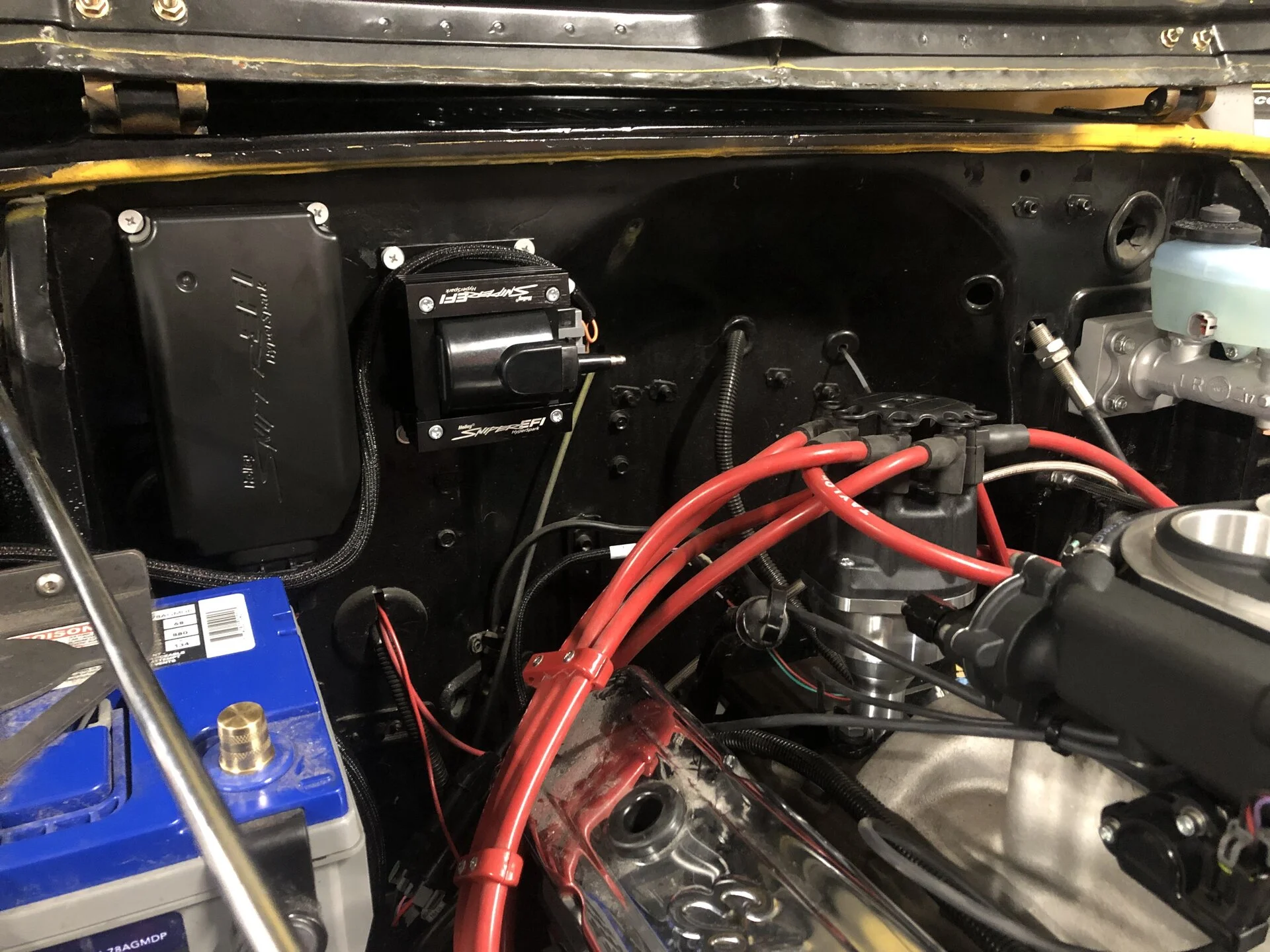

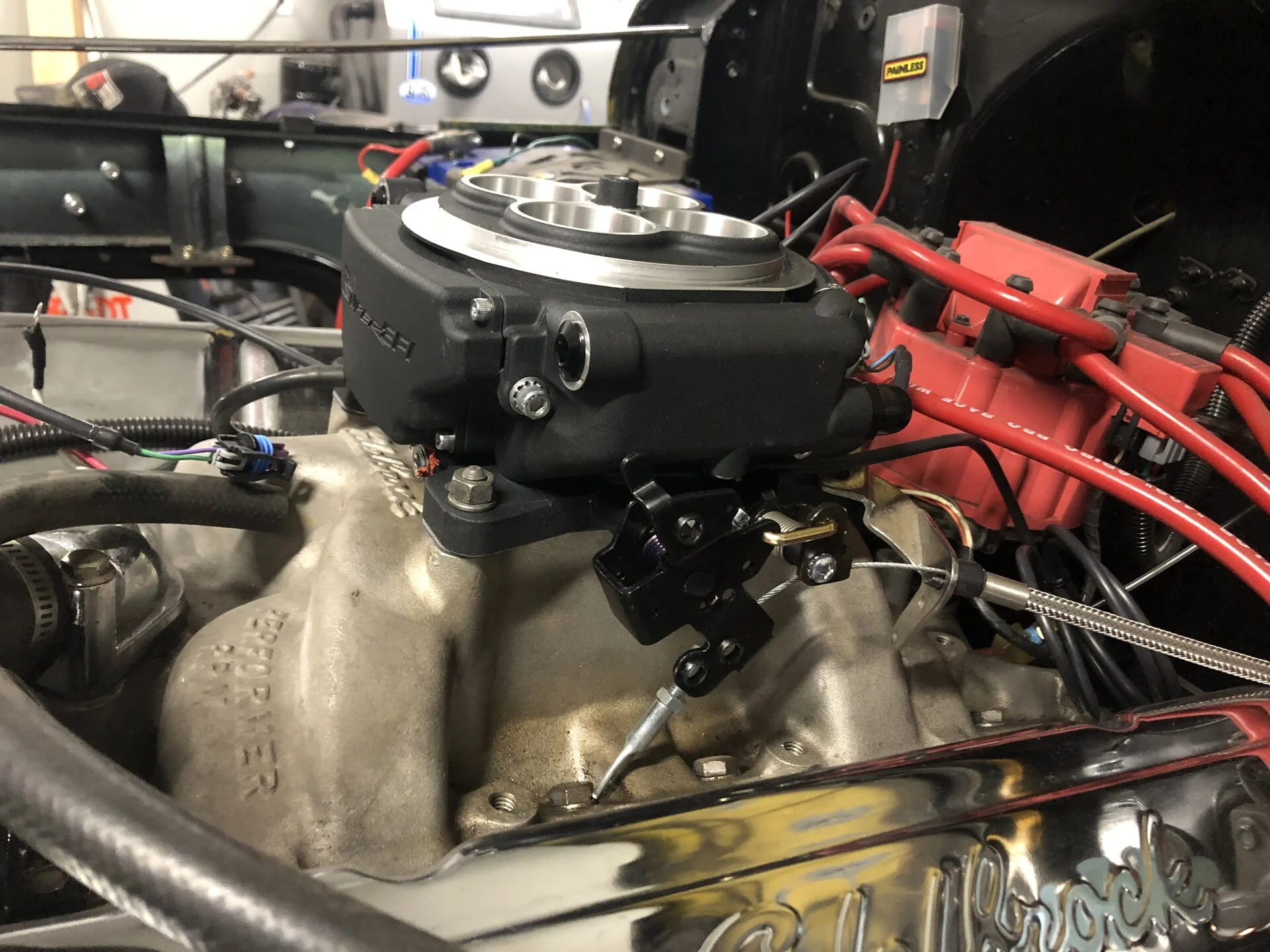

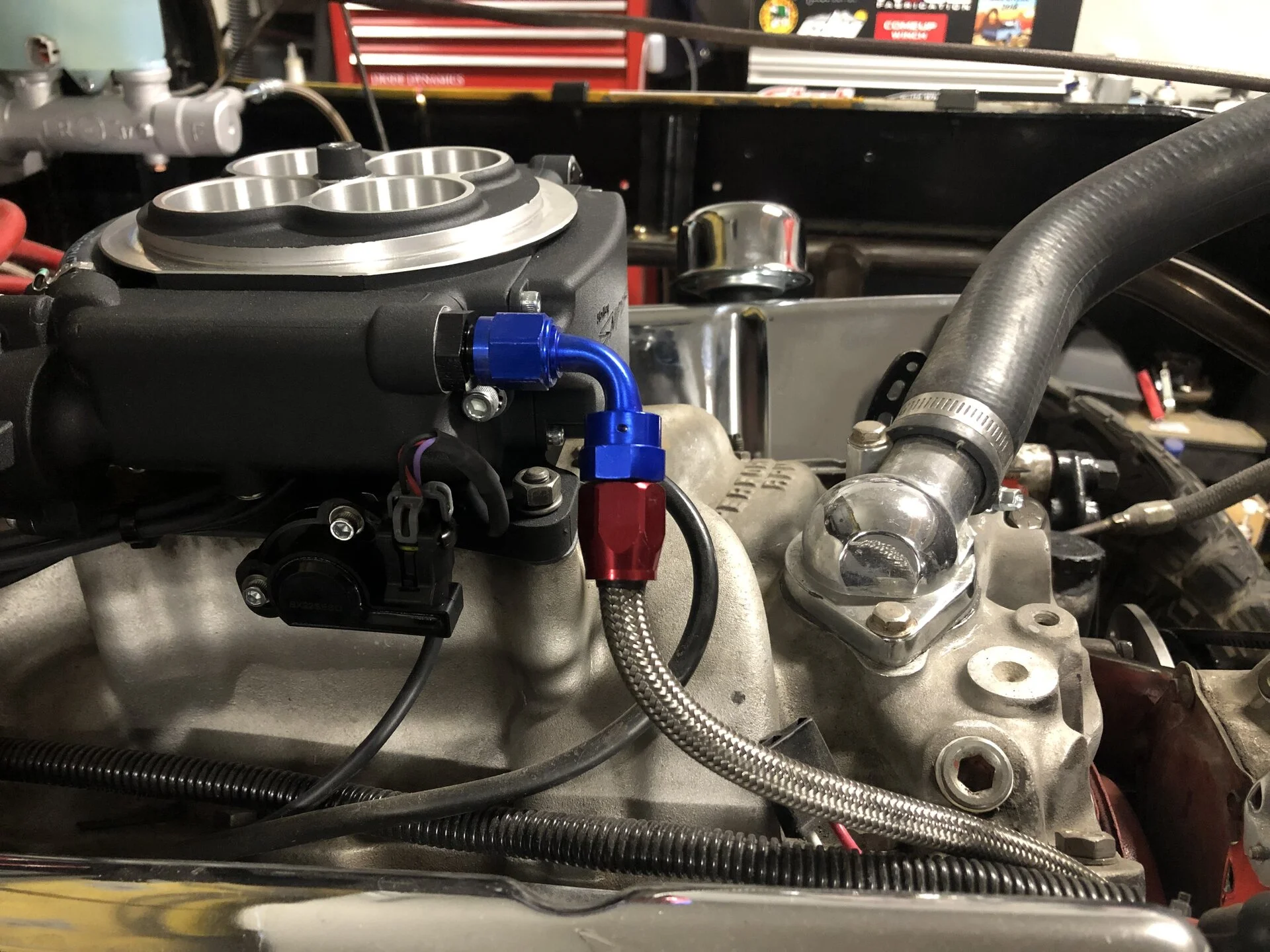

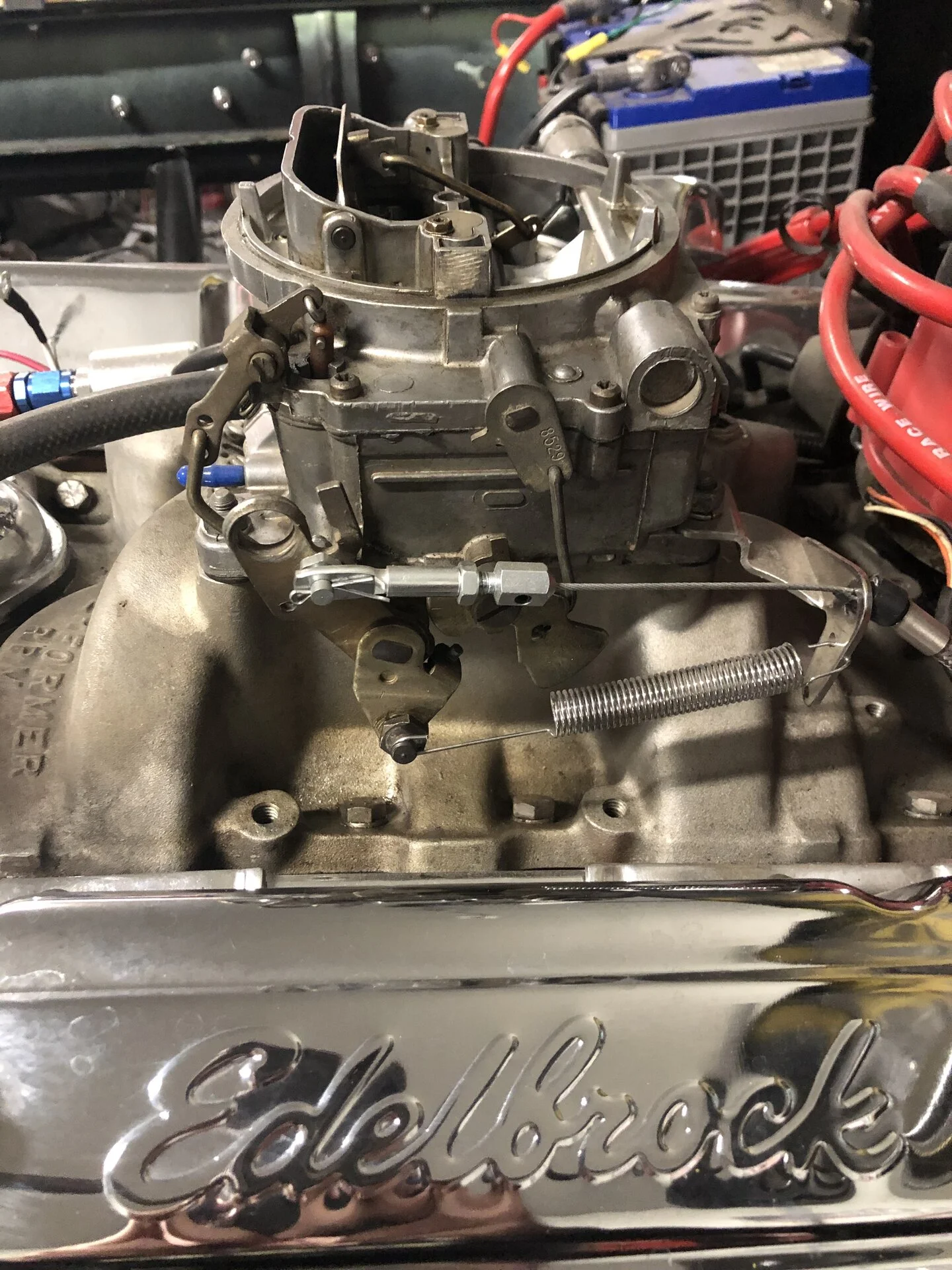

Spent a little bit of time on this tonite. So far so good . I swapped out the linkage for the progressive linkage that is supposed to help a lot with these . Normally the secondary’s open at the same time as the primary 🤷‍♂️ With the progressive linkage now the secondary’s will open at 40 percent throttle. Much better for crawling and better fuel mileage 👍.
Everything is hooked up 😃. Just need my coil wire and connect the throttle cable. Both will be here tomorrow 👍. Then I can do a big fat burn out in my neighbors lawn 🤩.
And that is a good stopping point tonite. She is almost there

I just finished a Sniper install on my F155 and I figured out that the poppet style PCV was creating some stalling issues.

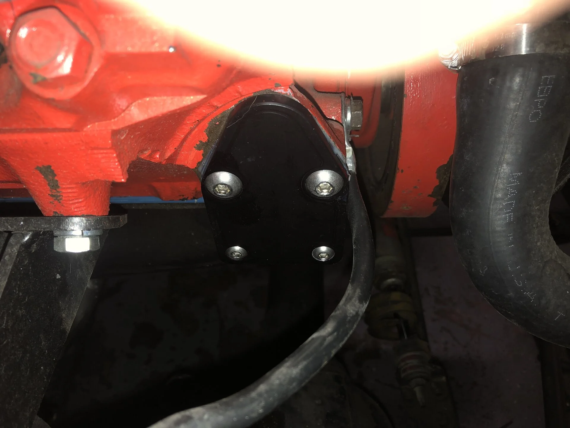

I see the big gaping hole in your passenger valve cover and I think thats where the PCV goes on your V8.
Anyway, I would recommend a fixed orofice PCV if you dont already have one. Duralast PCV1009DL is under $1.50 at Autozone.
Disregard if you were already aware of this!
Discussed here on post #49 if you want more information: Sniper Conversion - 72 FJ40 - F155 Engine - https://forum.ih8mud.com/threads/sniper-conversion-72-fj40-f155-engine.1304213/post-14882967
Be sure and use some thread sealant on the NPT threads for that fuel pump. I also have a Holley retrofit and had a heck of a time with leaks at the tank until I used some Loctite 545.

I have it i just had it taken out for more room to work .
