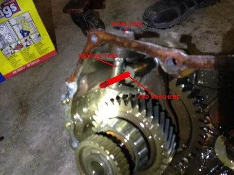

Here's my thought, FWIW.
If it was me I would look to eliminate that top shift lever altogether. Drill through the front of the case, add a rod to the front of the hi-lo shifter fork shaft, find a suitable oil seal and tap and plug the hole for the high-low shift lever. Like this :hillbilly:

How did it drop? Mine is set up very similar to the gold one from the looks of these pics and I don't want to find myself in the same situation.

From what Matt said last night, it's common once you twin stick it.
But the clamp came loose on the dowel and from there the dowel just drops into the case. Joey gone put a washer on the dowel and tack weld it, in front of the clamp. So it can be unclamped and case removed...
