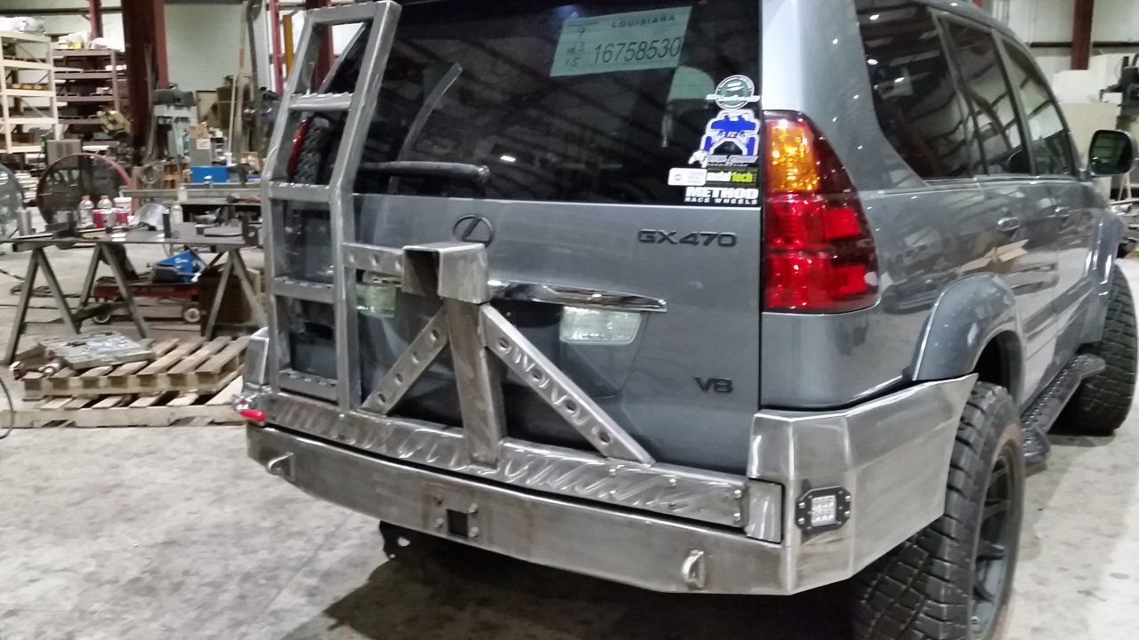

Well here ya go scat man ... work another late night ... starting to see the light at the end of the tunnel View attachment 1143869 View attachment 1143870 View attachment 1143871 View attachment 1143872
Only main thing left to do on the rear is the actual mounting ring for my spare tire ... but I seem to lost my stud bolt so I'll pick up studs and lugs tomorrow

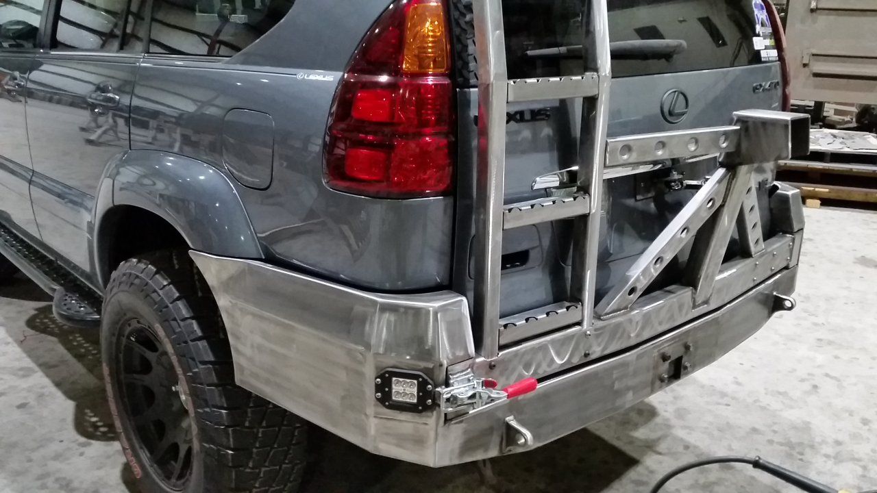

GX upright for the tire carrier is more toward the center of the truck to take advantage of the license plate area as the heim joint attachment point. This inhibits fitting two jerry cans. The 4Runner bumper is mounted more towards the passenger side so we can squeeze them in there.

we off set the tire for weight distribution towards the spindle and being off center helps the with the heim joint bc it needs to be off center to work with door ... aswell as giving room for the ladder
to move the tire any wheres else means hrs of re designing connected components that give the tire carrier strength

yes the current model is very similar to this ... when i built mine i completely revamped the swingarm design so that all components are now laser cut and formed sheet metal and plate steel instead of structural steel ... the only difference is dimpled bracing arms arent bent at a 90deg angle towards the truck its more of a 45deg angle ... and we only put one up brace towards the tire on the pass side instead of two... sorry our website photos havent been updated in awhile ... i'll see if i can find a customer photo to share ...

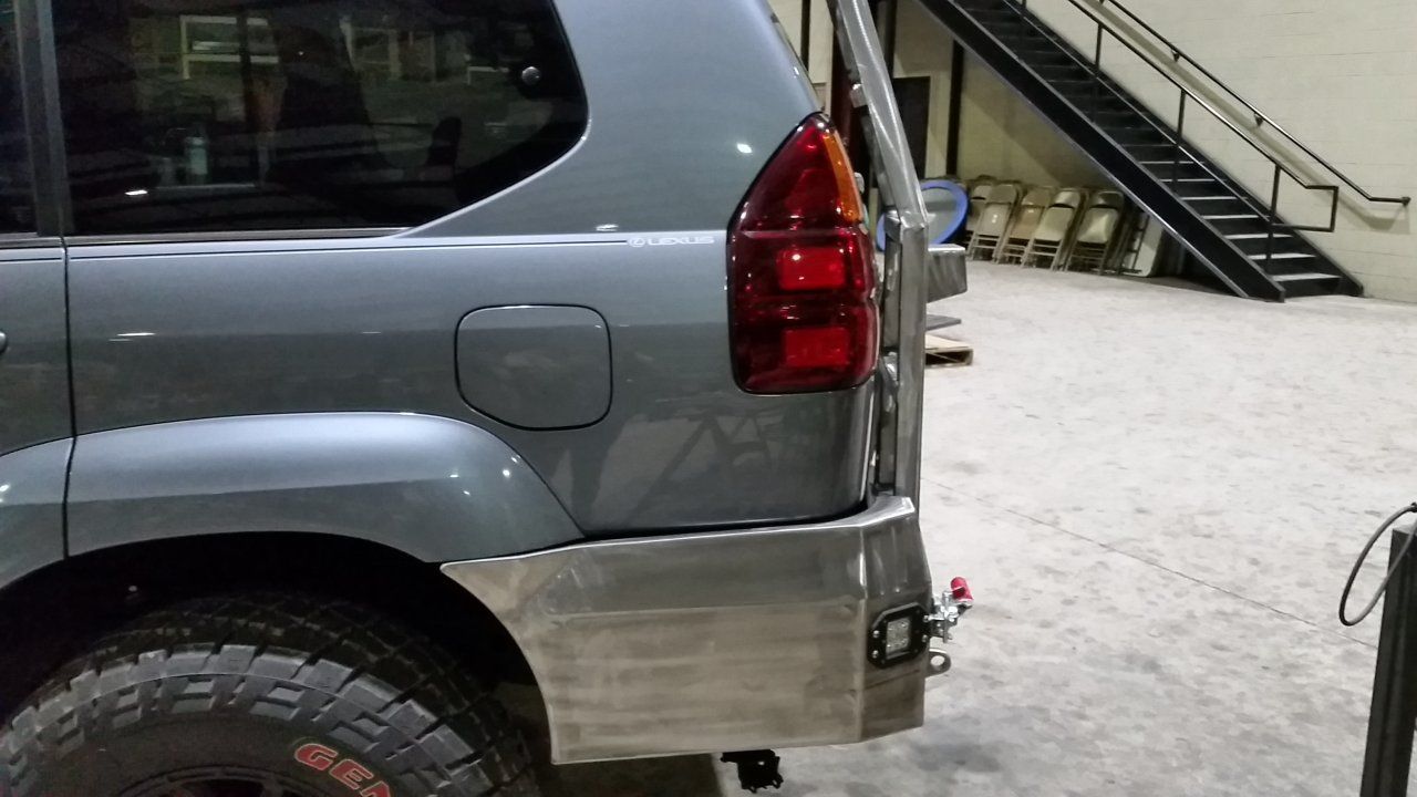

i cant believe i didnt post a pic of my rear bumper completely finished yet ... and i lost my phone over the weekend :(... hopefully they are in the cloud

Is there a latch to hold bumper open when opening rear door? or does it stay in place pretty well on it's own?
not sure i understand your question @ultrakill ... but the swing arm is attached to the rear door in a way that they open together just as you do now ... and you lock it down with the HD latch to add rigidity ... to i guess you can say the swing arms are double double locked for security and peace of mind ... no worries of it opening on its own
Yeah that kind of answers my question, I wasn't sure how it swings out (but could tell it swings out same way as door). I was asking if it will "push" the regular door shut if you are on an incline, or if it will stay open when the door is also open.
You kind of answered my question saying that they open together.
