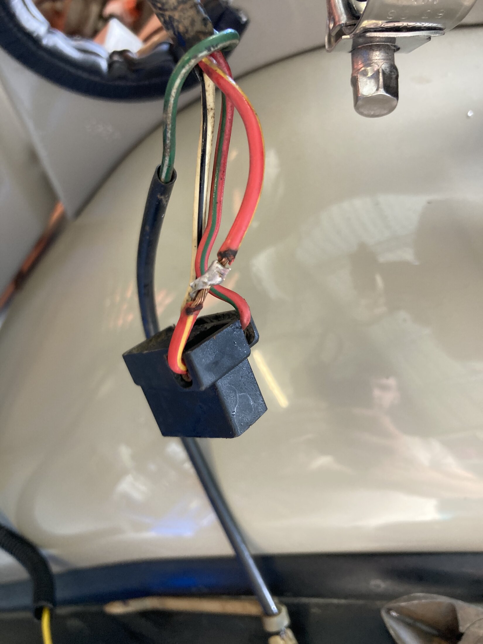

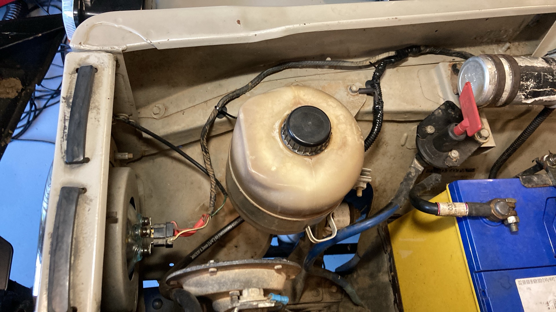

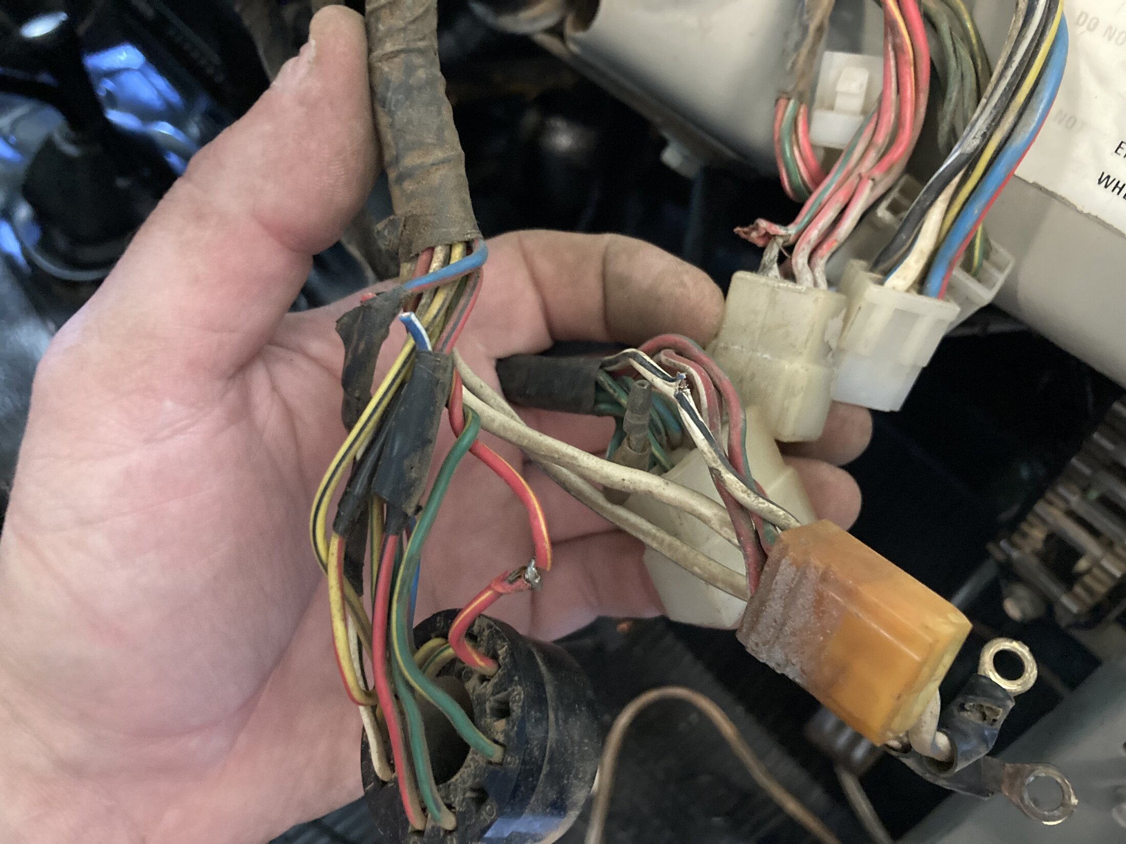

More butchery was done to the dash while adding a stereo and switches, the wiring job was very poor so I have stripped all the non factory wiring and will start again. There are also holes drilled all over the place, my guess is from various owners accessories over the years. Nothing unexpected for a cruiser this old.

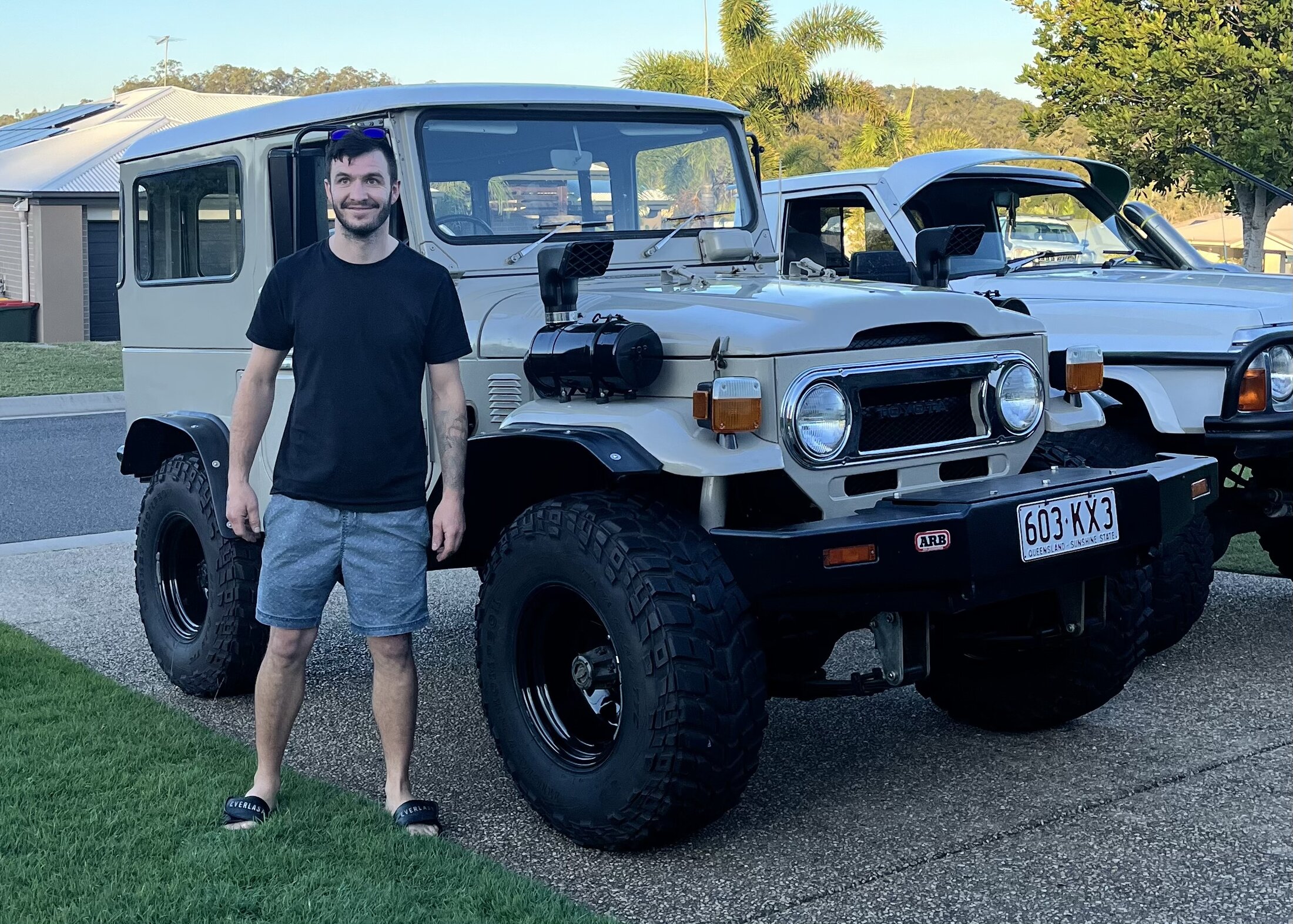

Do your dueling dorkles connect to the carburetor directly? Looks like a fun rig!
Surprisingly they do! Whoever put the carb and dorkles on made up a twin entry carb hat.
Looks like a cheap prop from an old sci-fi movie, I have replaced it for the moment with a standard round air cleaner.

Slow progress all week, I just kept finding more hack jobs on the wiring. I think I have it all sorted finally! My 1977 user manual has been invaluable, it’s awesome how much information they put in the old manuals.

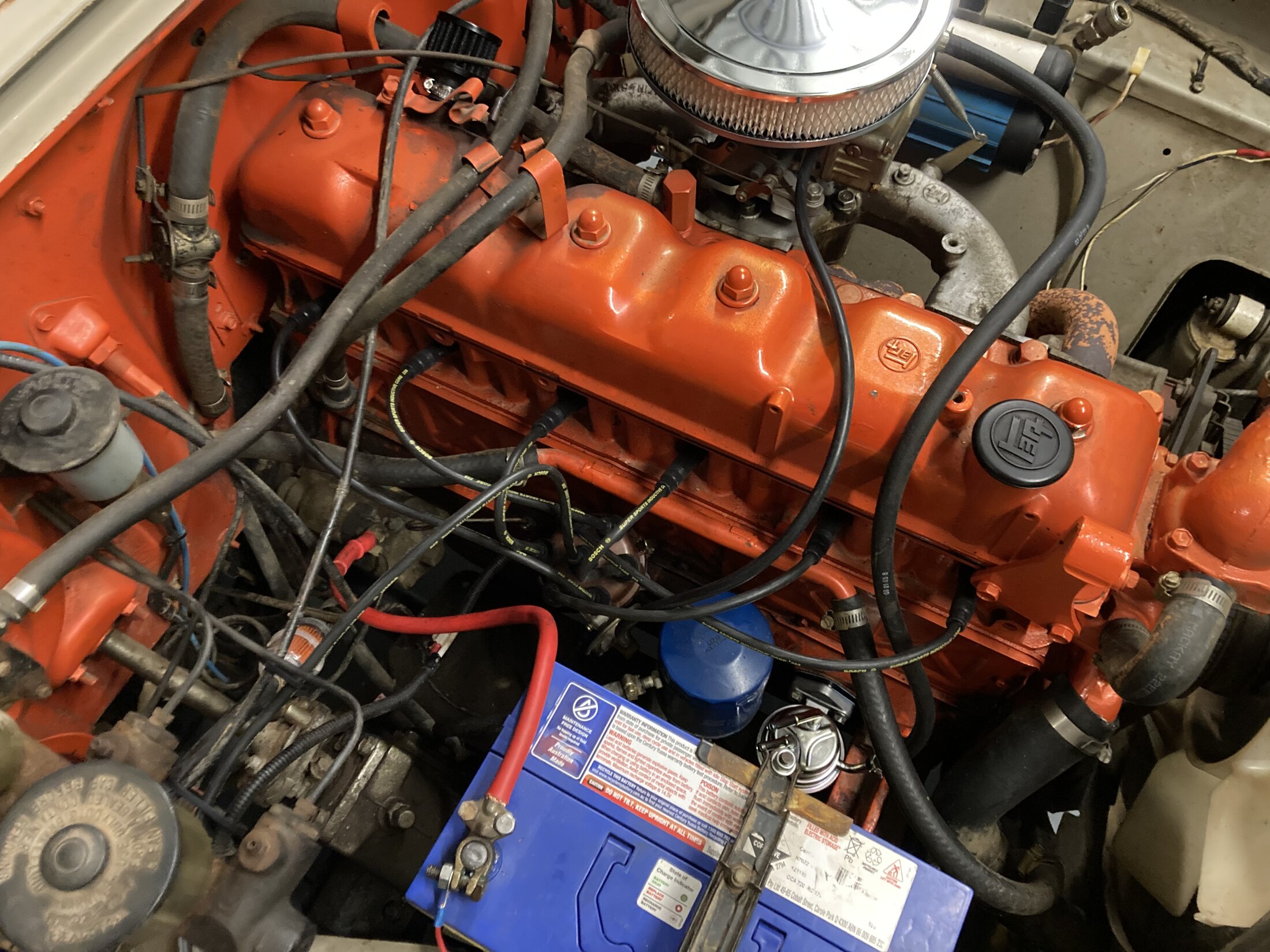

Finished off the tune up with dialling in the Holley as best as I could. I’m a diesel guy with zero carb experience and I’d never seen a Holley in person before buying this 40.
Then finally adjusted the valve clearance, and now it hauls like it should and sounds like it should!
PO had no idea what they were doing, some rockers were tight when they should have had clearance at tdc, others had way too much clearance, one was spot on and on one the adjusters was loose.

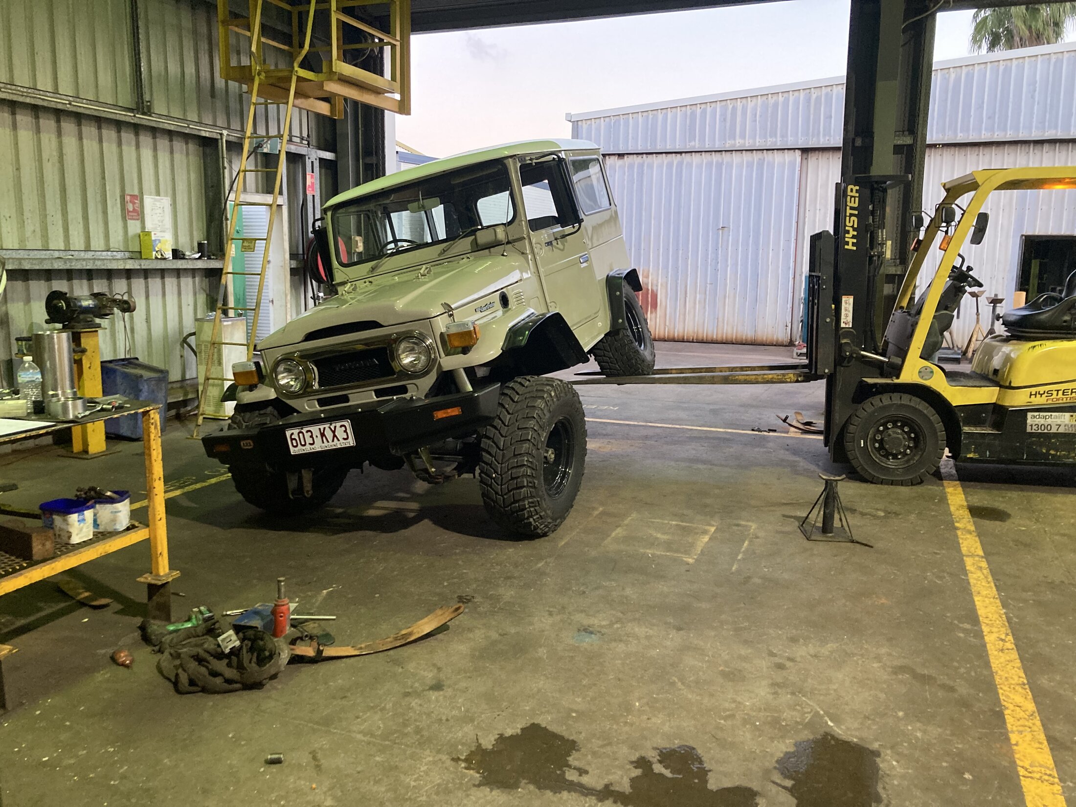

Pulled a bunch of leafs out of the packs which got it sitting 50mm lower, then had to do a poser flex shot with the forklift of course. Then the rear settled further and the tyres started rubbing.😂
So I left it there for the night, I’ll put another leaf back in the rear today and see how it behaves.

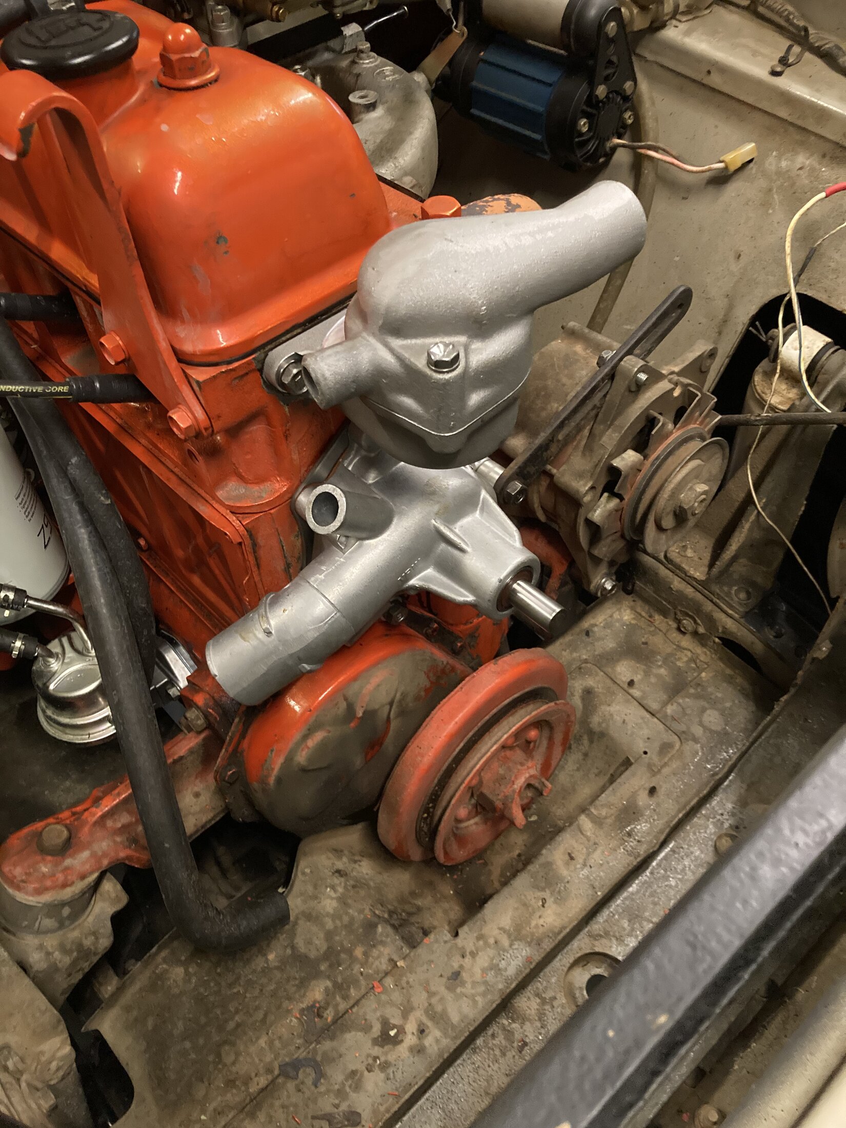

A big pile of parts arrived today! I went to flush the cooling system on the weekend but saw how muddy it was and decided to go all in.

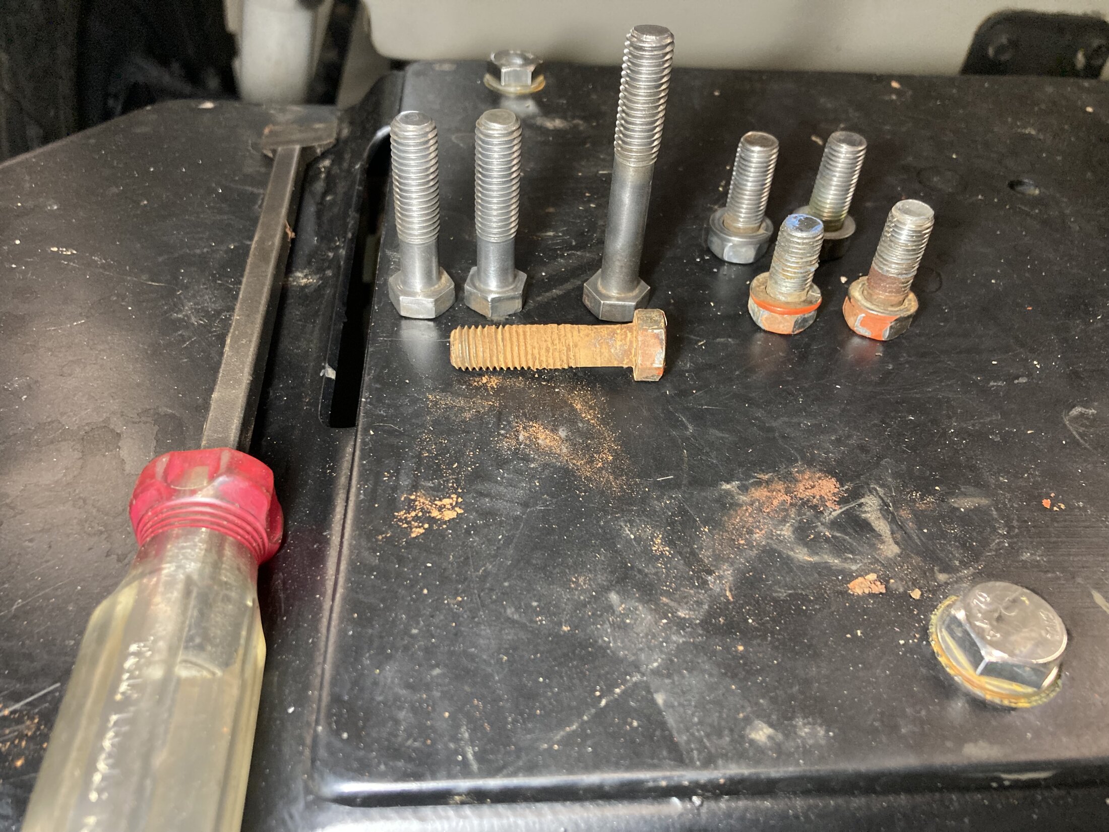

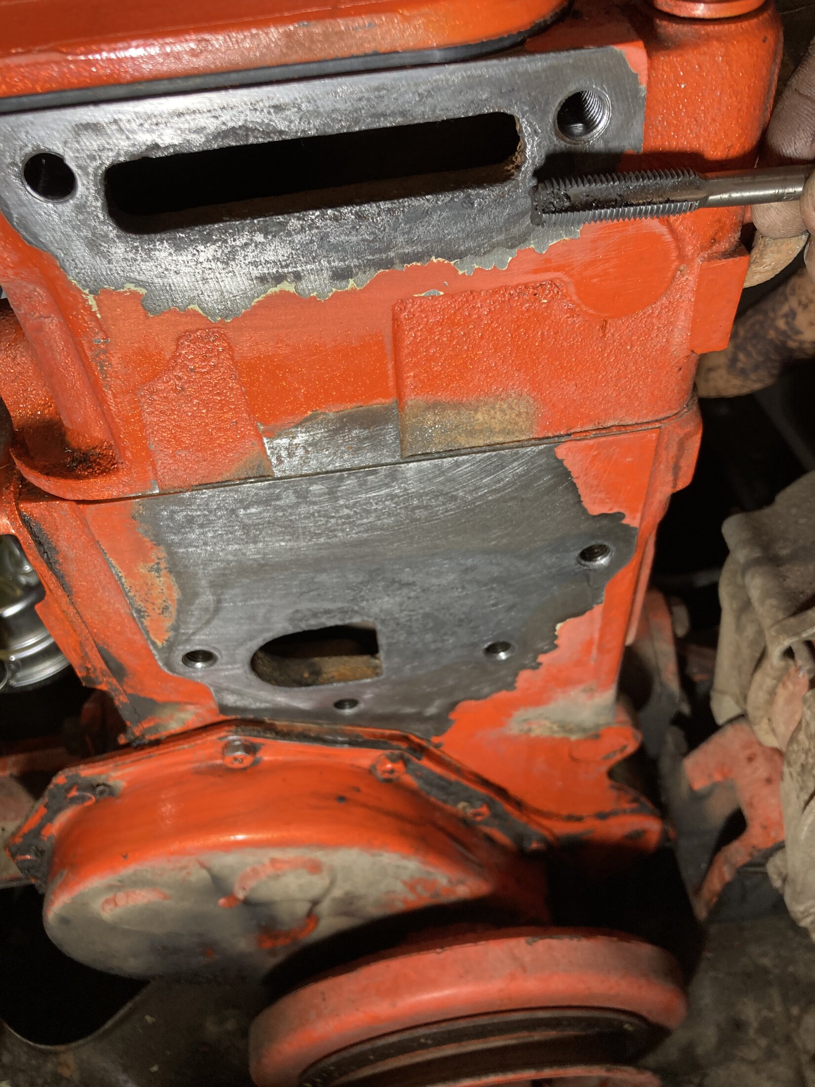

Got all the old stuff out of the way. Cleaned up the gasket faces on the block and head. I always clean up the threaded holes with a tap, these were all full of crud but otherwise in good condition.
Wire wheel on the bench grinder does an excellent job on the bolts. One day I’ll have to give zinc plating a try.

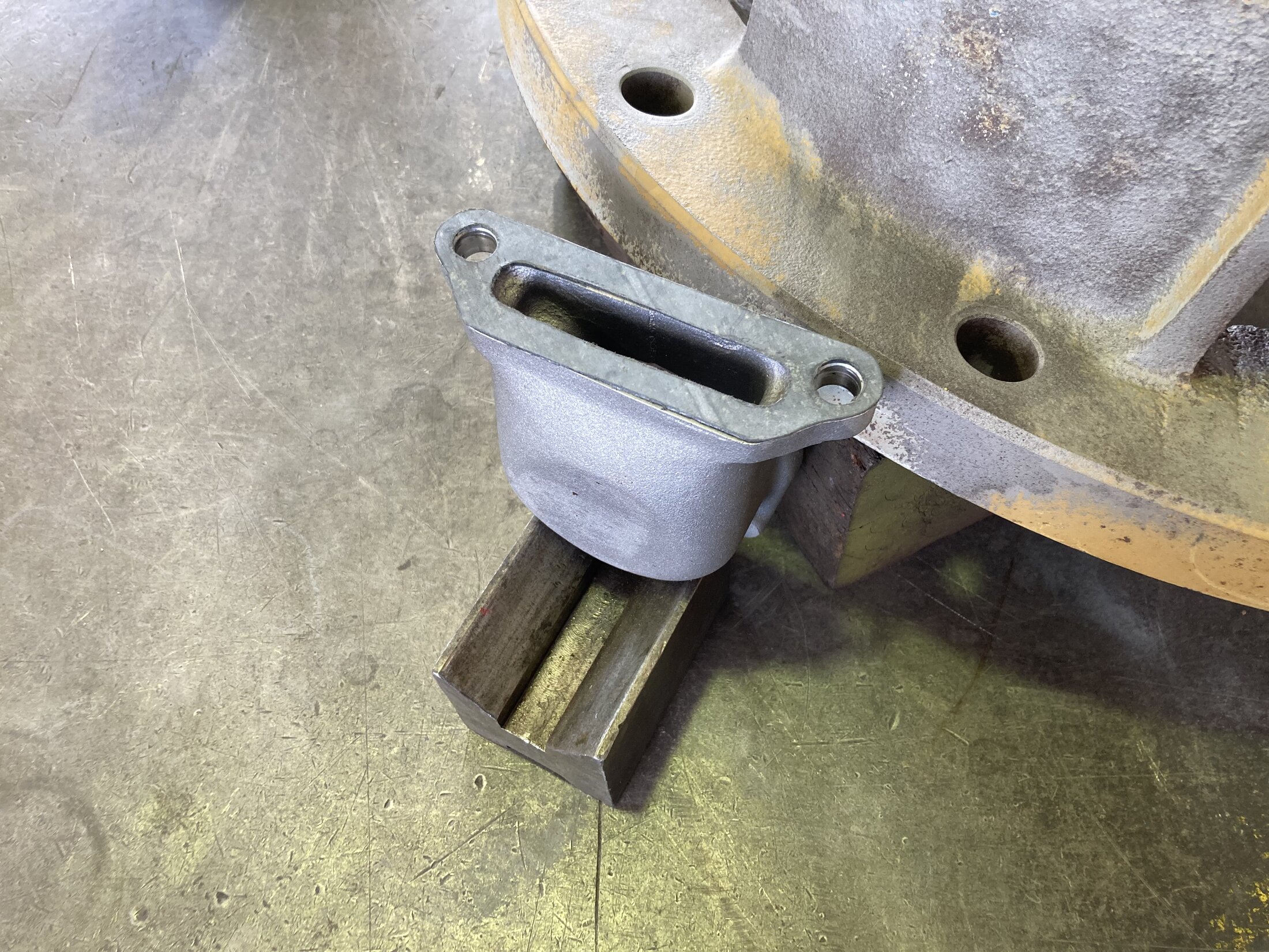

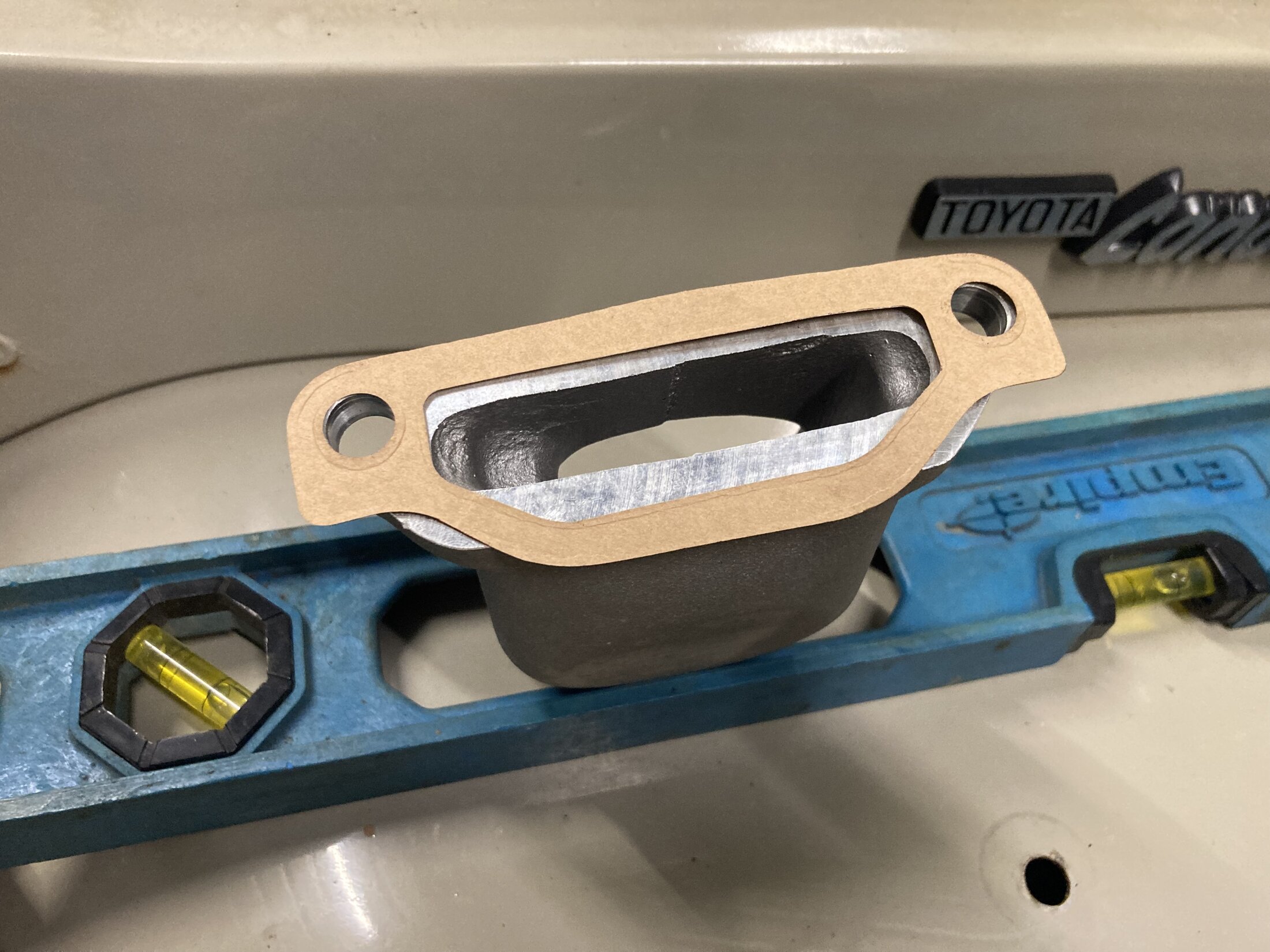

Got the new water pump on but progress for the evening came to a halt when I realised this aftermarket gasket for the lower thermostat housing is a poor fit. I’ll take the housing to work in the morning and cut out a new gasket.
New gasket is cut, it’s a much better fit!

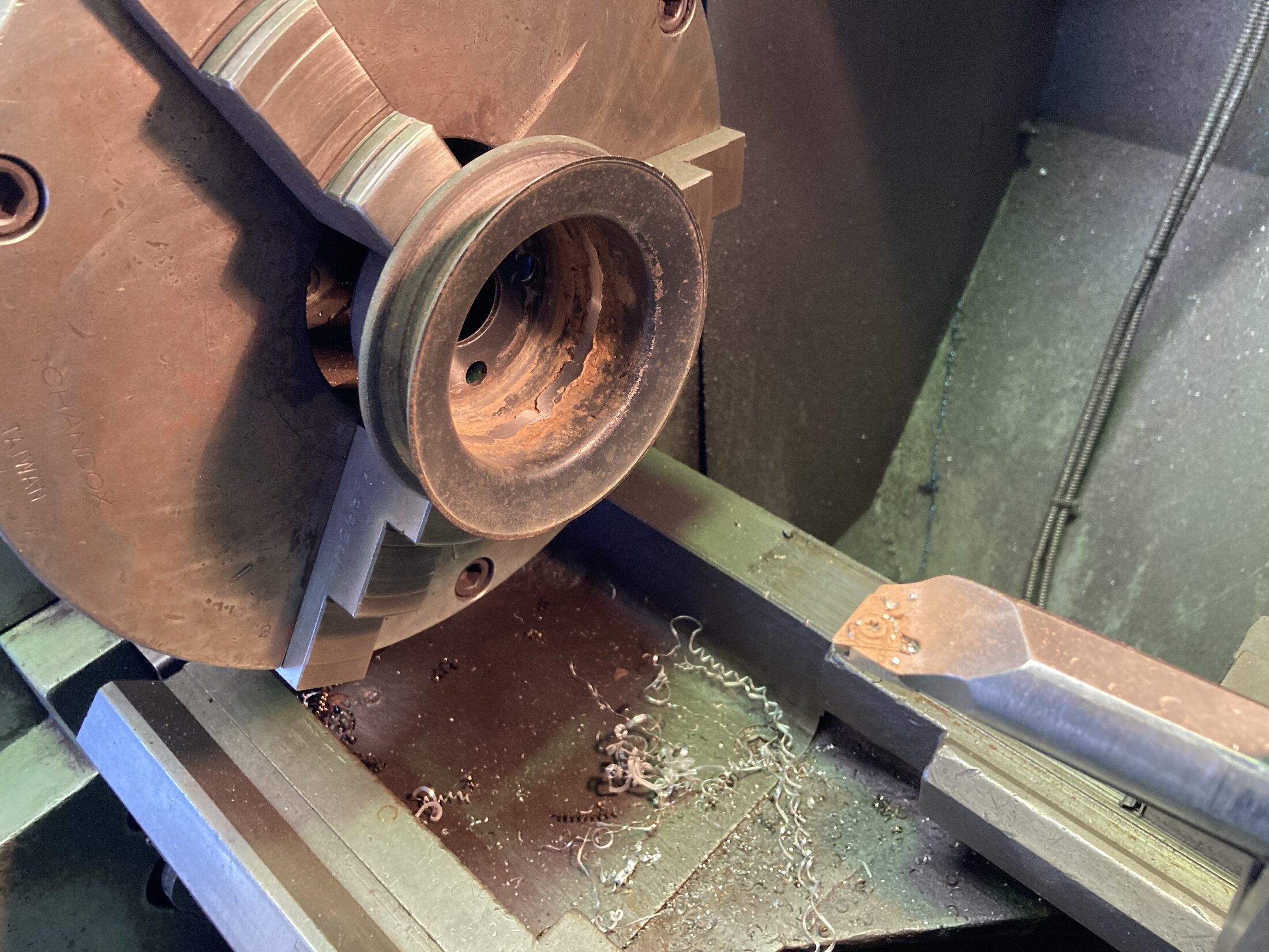

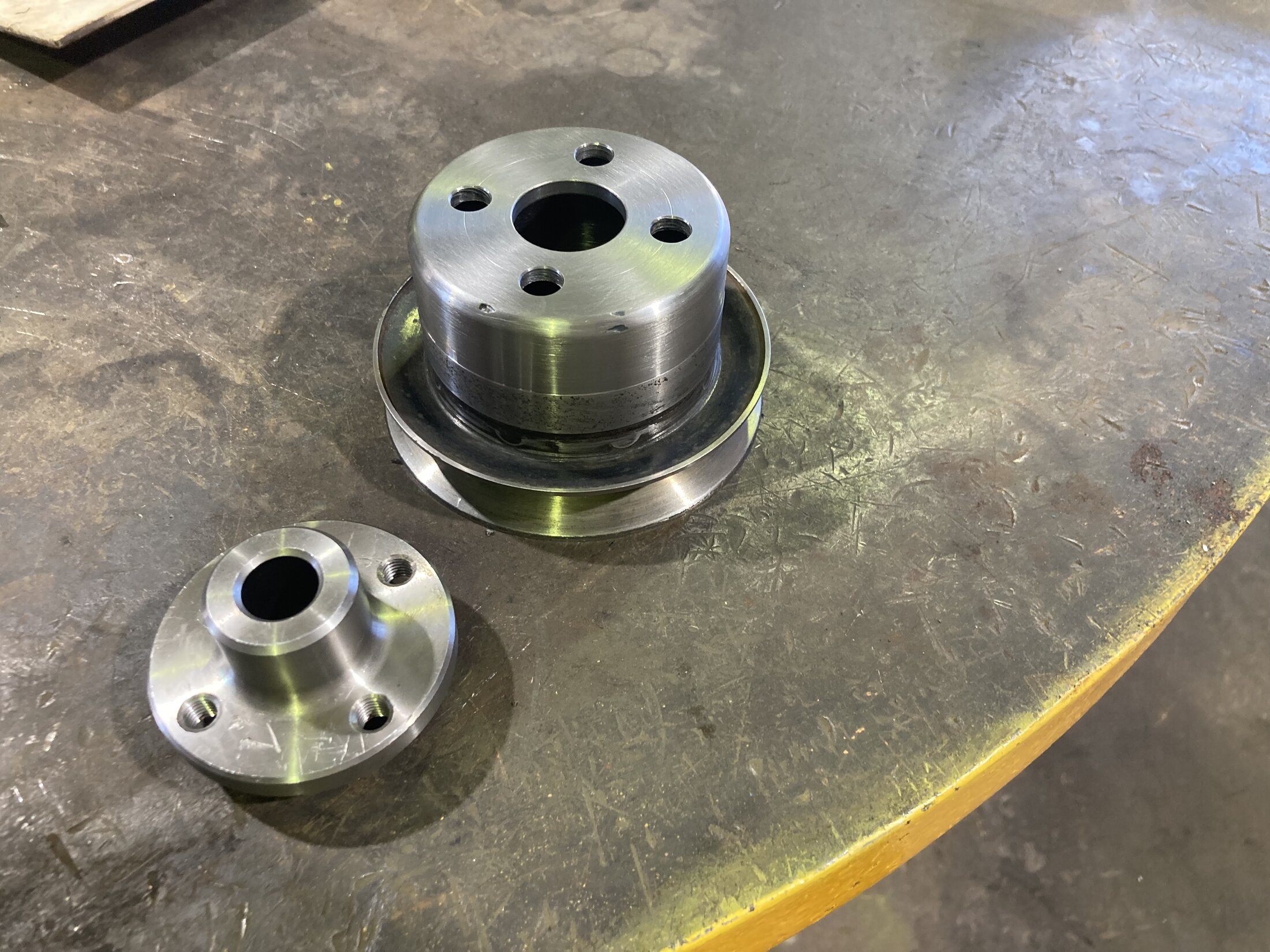

Put the pulley up in the lathe and checked the run-out as I noticed it’s been cut and welded, it’s 0.60mm which isn’t ideal. I machined down some of the weld as it made it difficult to fit to the hub, but then realised someone had shortened it to fit on the wrong pump for this year model. Now the pump pulley doesn’t line up with the others.
Short term solution is to swap the hub over from the old pump so I can fit up this pulley while I find a replacement or machine a shiny billet one.
At least the new parts look good.🤟

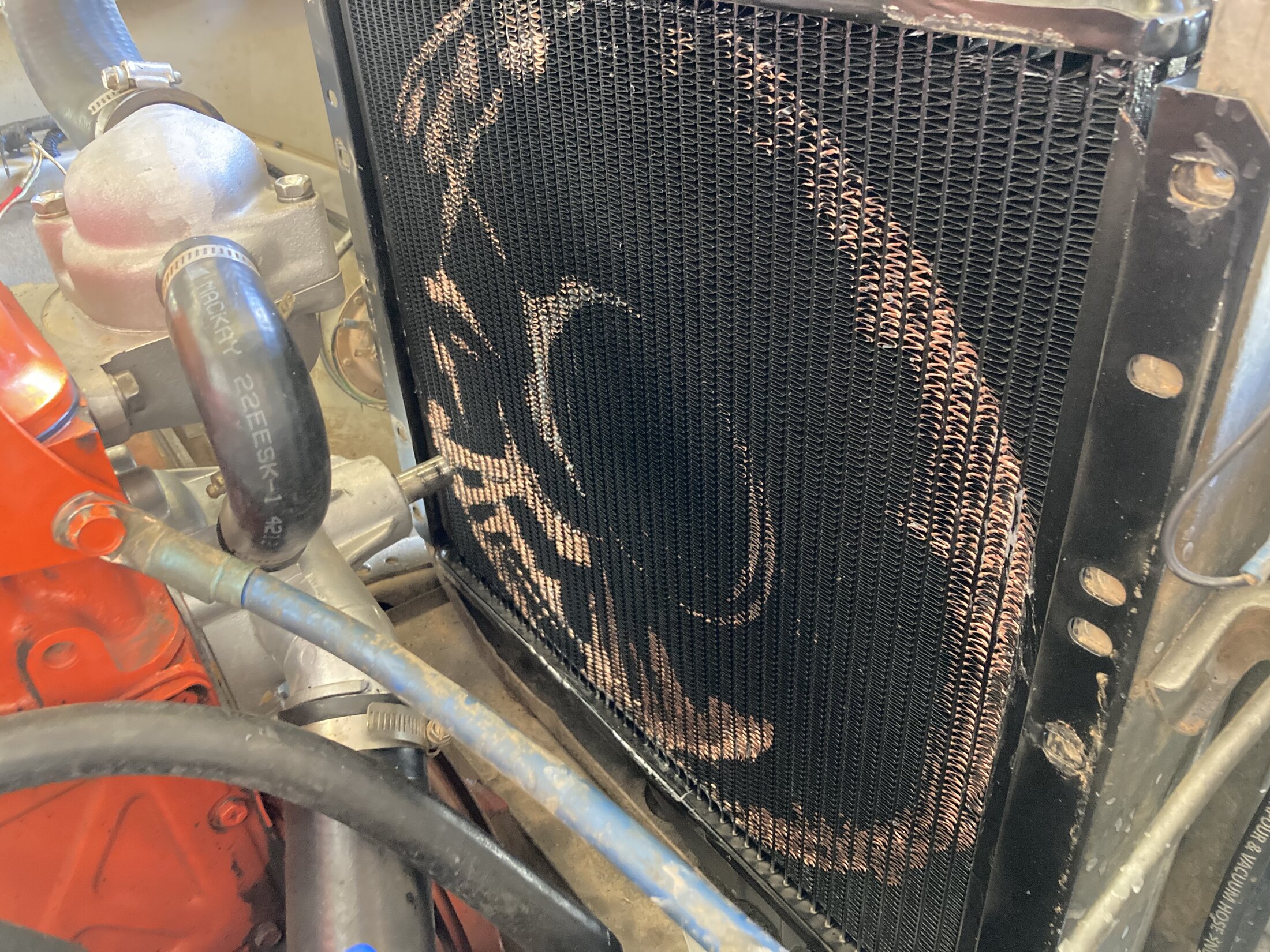

Well the hub walked itself off the pump shaft sending my brand new fan into my brand new radiator. At least it didn’t puncture it.
So I machined out the pulley, machined a new barrel for it, gave it a 0.10mm interferrence fit to locate it, welded it, then put it back into the lathe for a final machine to ensure it ran true.

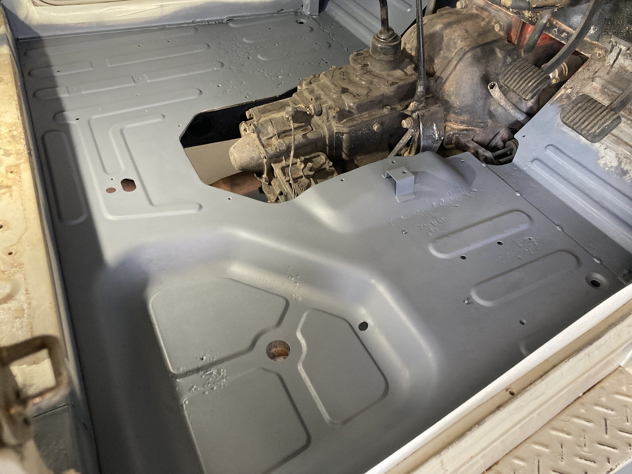

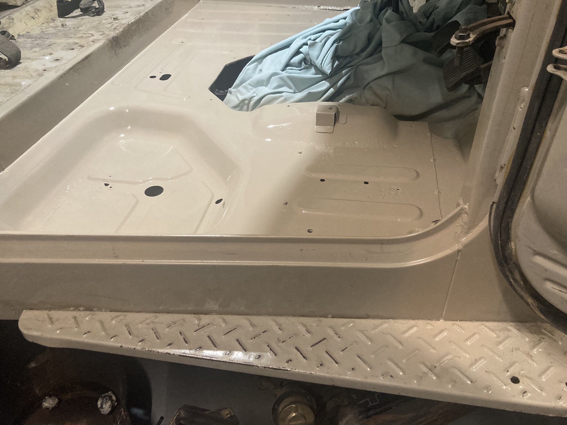

I’m still waiting on parts to get the Holley carb tuned so I pulled out the seats to have a little look at the condition of the floor.
I’ve seen worse on here but it’s not ideal.
Found the original gear knob fascia buried in all the dirt!
The LH side floor is the worst, pin holes everywhere.
I’ve decided trying to patch or spot weld the floor is a futile effort so I’m going to order a replacement panel, which will probably be a next year job. In the mean time I sealed it back up with some single stage paint and left the speed holes. Found a colour on the shelf that is a bloody close match.👌
