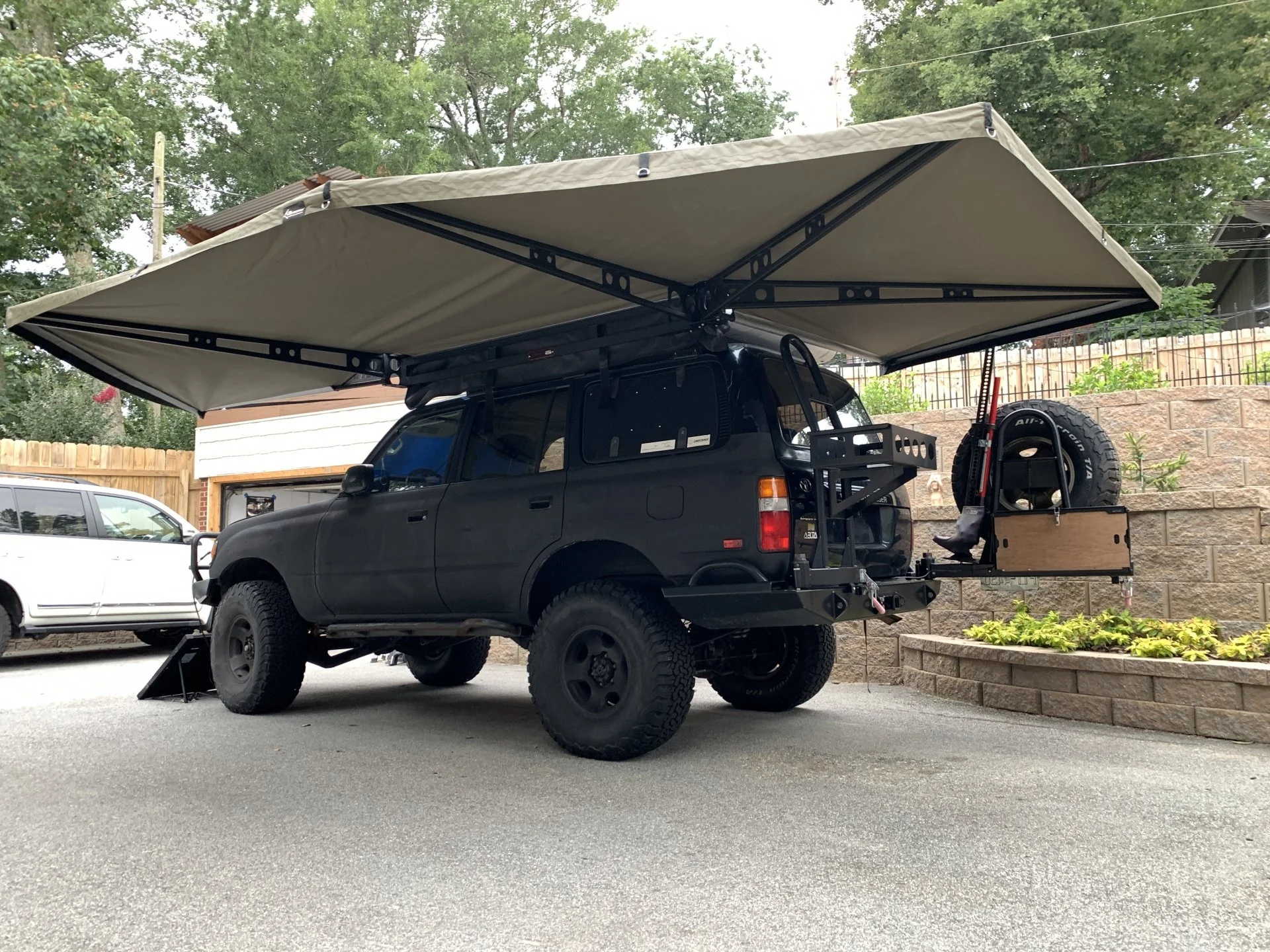

After at least a year of trying to decide on replacing my trusty ARB 2500 awning (it just works really well, add the screen room and it's hard to beat) or trying something new. After my last camping trip where it rained the entire weekend and I was cooking off my tailgate exposed to the rain, I decided to try one of the wrap around awnings.
After a lot of reading and research I felt like the bush company 270 was the easiest to set up, easiest to take down, provides excellent cover and doesn't need legs. So with that decision made, one showed up at the house.

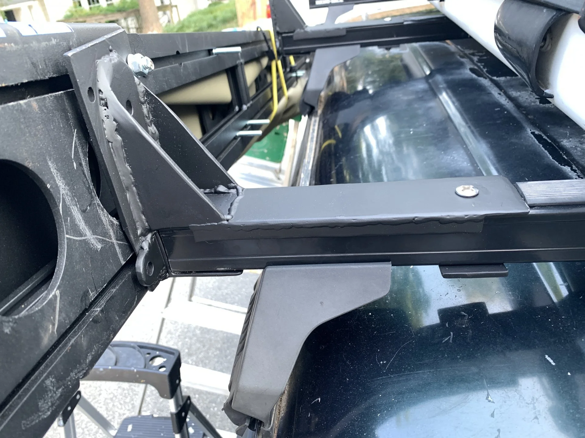

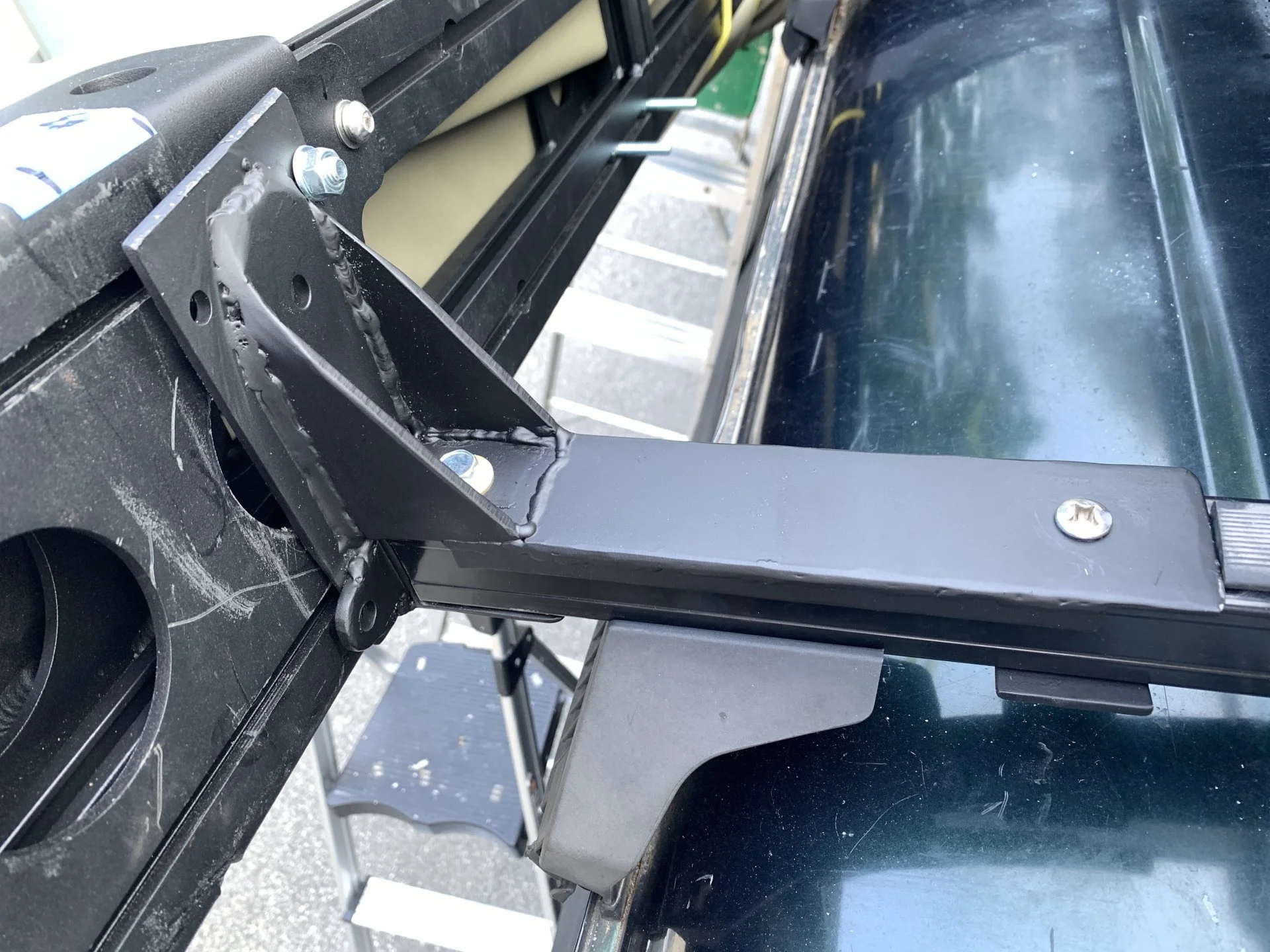

I'm running three rino rack HD load bars. This was fine for the ARB but the Bush Company awning places an amazing amount of stress on those bars. All the weight of the awning is pressing on the bars. So I had to fabricate some serious mounting brackets that could handle the stresses. I even added some boxed strength on the sides of the brackets and added one additional bolt further in. I think this will work as it's pretty stout but time will tell if I need another load bar or not. If you have a full rack then I think you will have no issues at all.

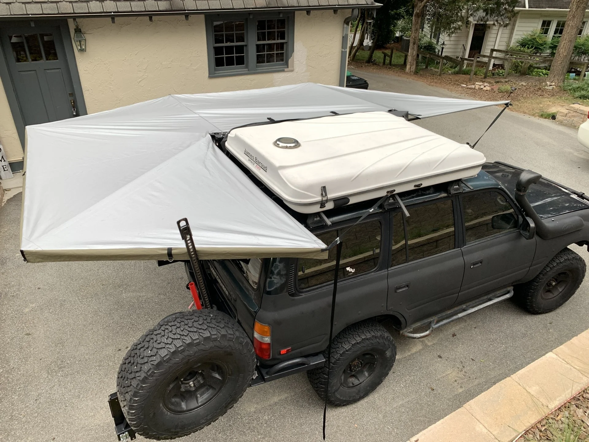

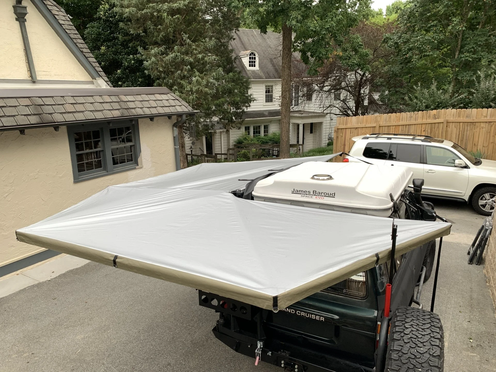

Here are a few pics of the awning installed and the mounting brackets.

First off, this is not a bolt on application! I guess if you have one of their RTT then it might bolt up easier but everything else will require some thought and fab work. I had to source the bolts and all hardware. I had to figure out and make the brackets. With that said, they do make L brackets that I could have purchased but I wasn't sold on them and I was even told that if you bought them you would need to add some gussets to them to strengthen them. This is assuming they are available since it seems like now everything is on backorder.
Secondly, the bag is a little frustrating. The bag comes with no holes for the bolts. So I had to partially mount, take down and fab, re-mount, take down, repeat about 5 times to get everything to fit right, then remove it again so I could cut holes in the back of the bag for the bolts. I understand why they did it since there are so many different ways people will mount the awning..... but ARB had a much easier solution. So I hope the bush company is paying attention to that.

Hey @concretejungle, how's the XT Max holding up? I just installed one on my 200. I totally agree with your comments on it being a bit of a project to mount. I've had it on and off about 4 times now and am still not done done as I need to fab some shims and drill some holes. Looks like you only used two mounting brackets? I used the three L brackets the kit came with but I'm thinking I may add two more. Videos I've seen show guys doing pullups on the arms. Maybe I'll be ok with 3 after I get it all completely installed.

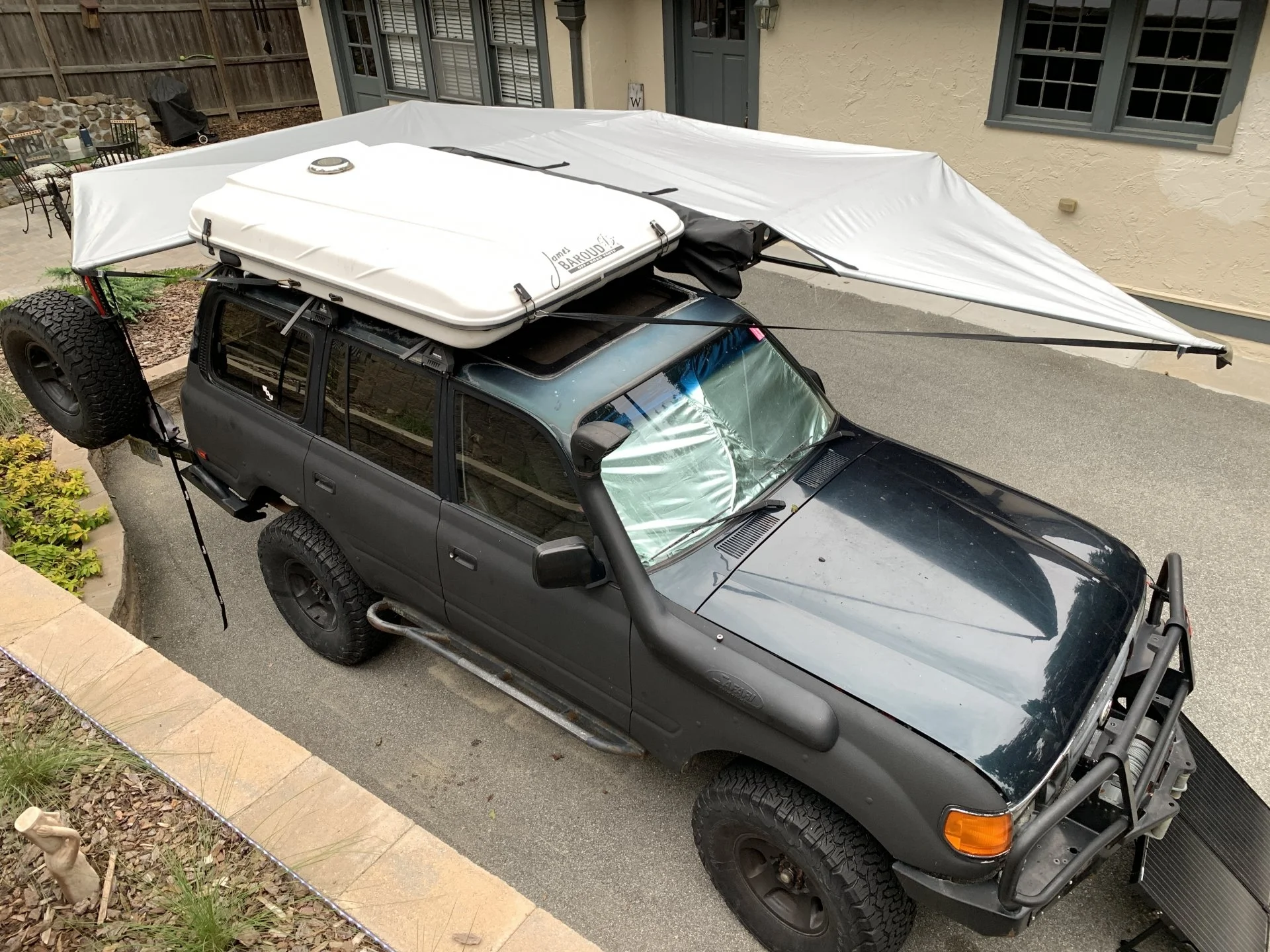

I did make a point to tell the bush company booth at Overland East this year that the mounting process for their awnings is the worst in the industry as far as I'm concerned. the guy laughed but agreed and even admitted that he hates mounting the awnings! He said they ended up having to do that because the original design was more like the other awnings with the mounting track and they were threatened to be sued, so they changed the design.
I should also add that right now I have their AX27 RTT and the awning mounted to the tent is super stout! I'm using two mounting brackets on the RTT and that is plenty. You just need to be sure that they are mounted towards the ends of the awning to support the loads.

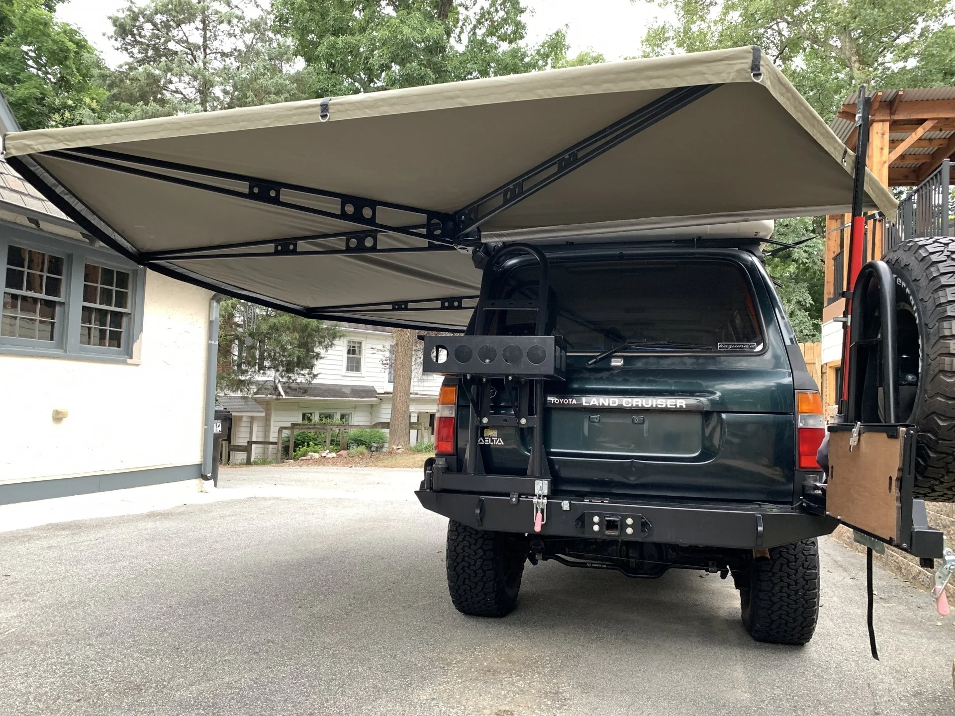

Here is a pic of the current set up with it mounted to the tent.
