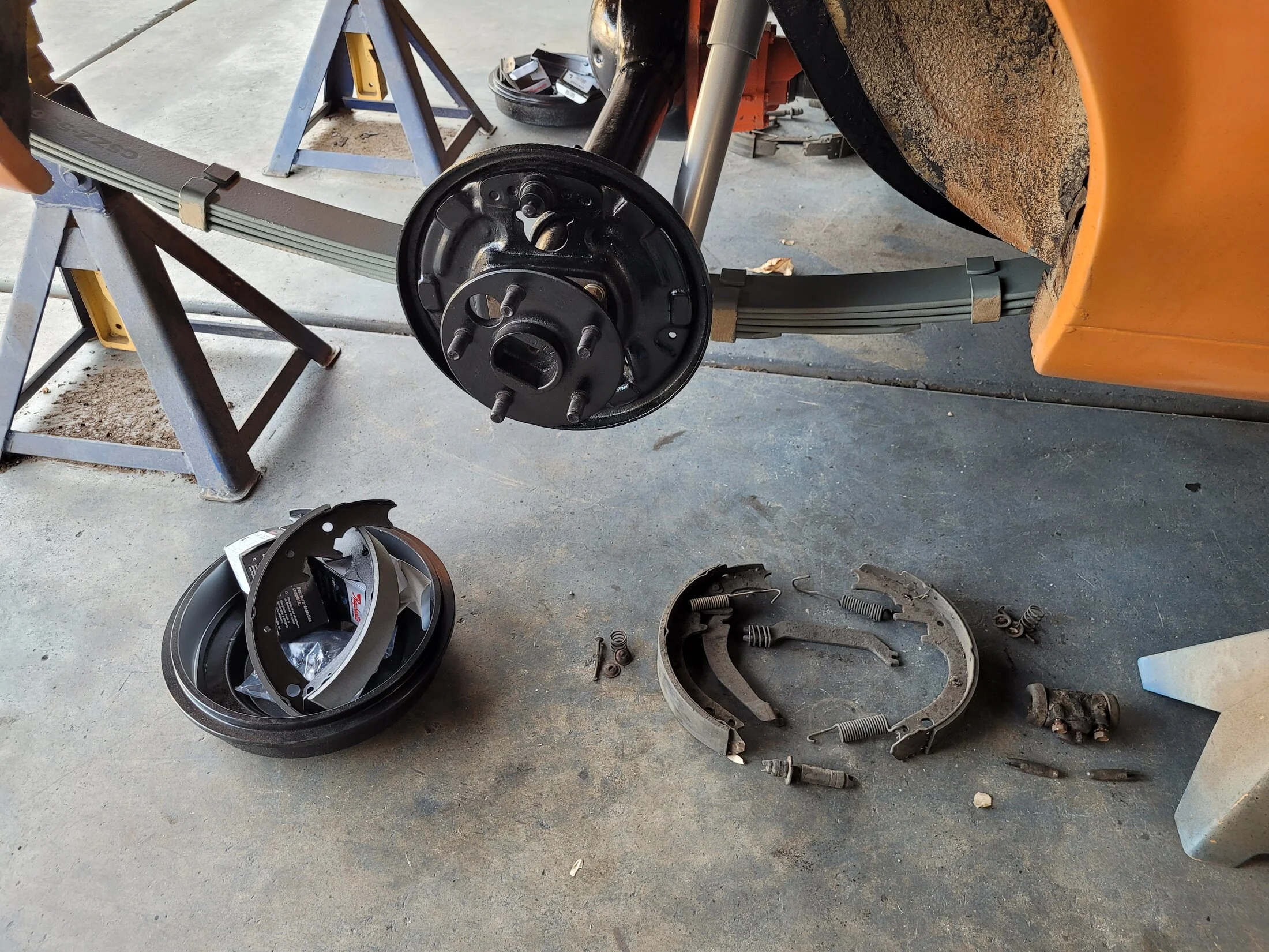

Also painted the rear drums. Need to get the correct wheels cylinders and parking brake cables before I can wrap up the rear brakes.

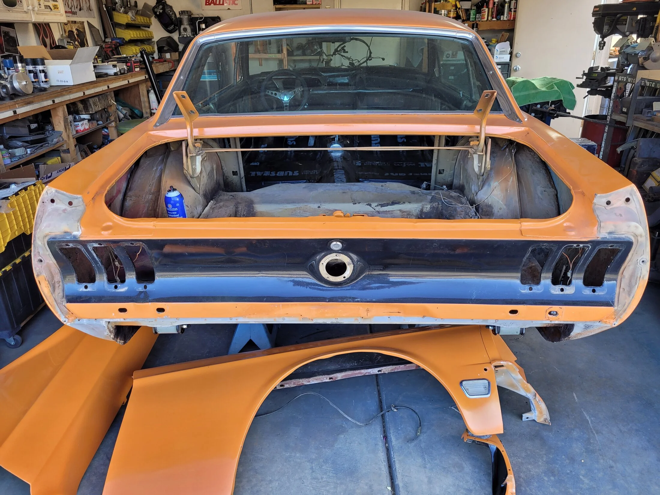

The orange and black is going away on this car. Tonight I replaced the instrument bezel and the gauge lenses. No more hideous orange. Unfortunately, I'll have to take this apart again as the gauges need some work.

Back on the 68, I revisited the rear brakes. I removed the self adjustment parts from the front and installed those on the rear. This makes the shoes adjust automatically with the parking brake.

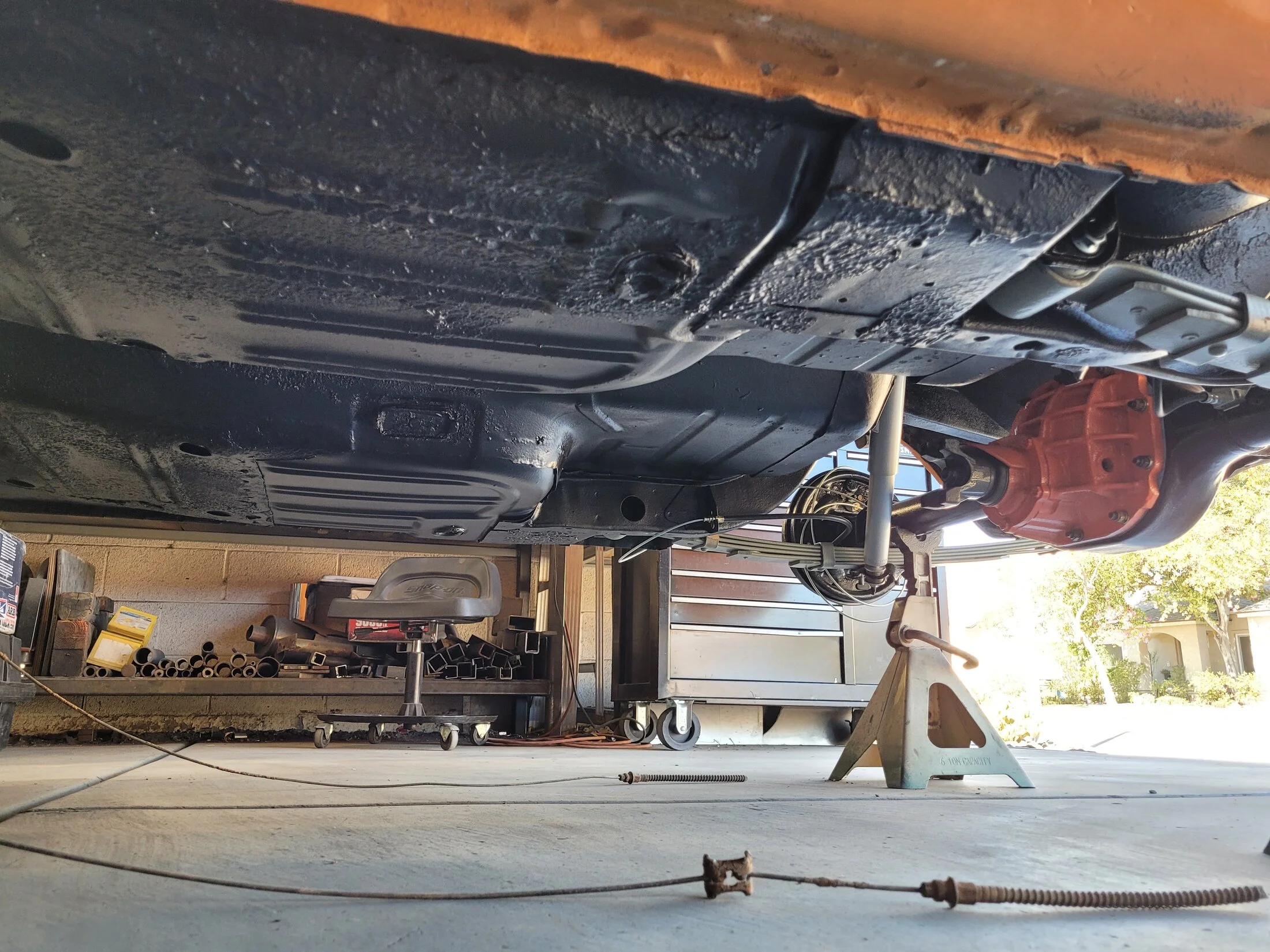

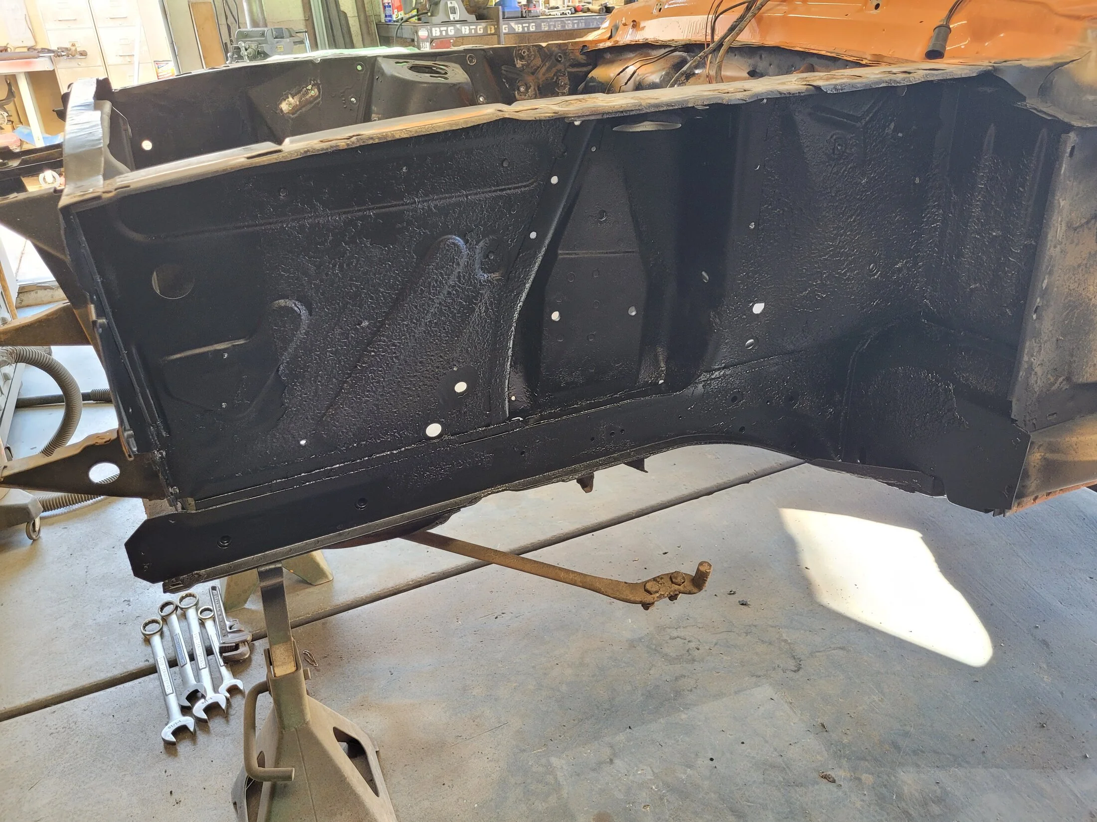

Then I removed the front sheet metal. I am surprised how solid this car is. I scrapped off a ton of loose under coating and road grime.

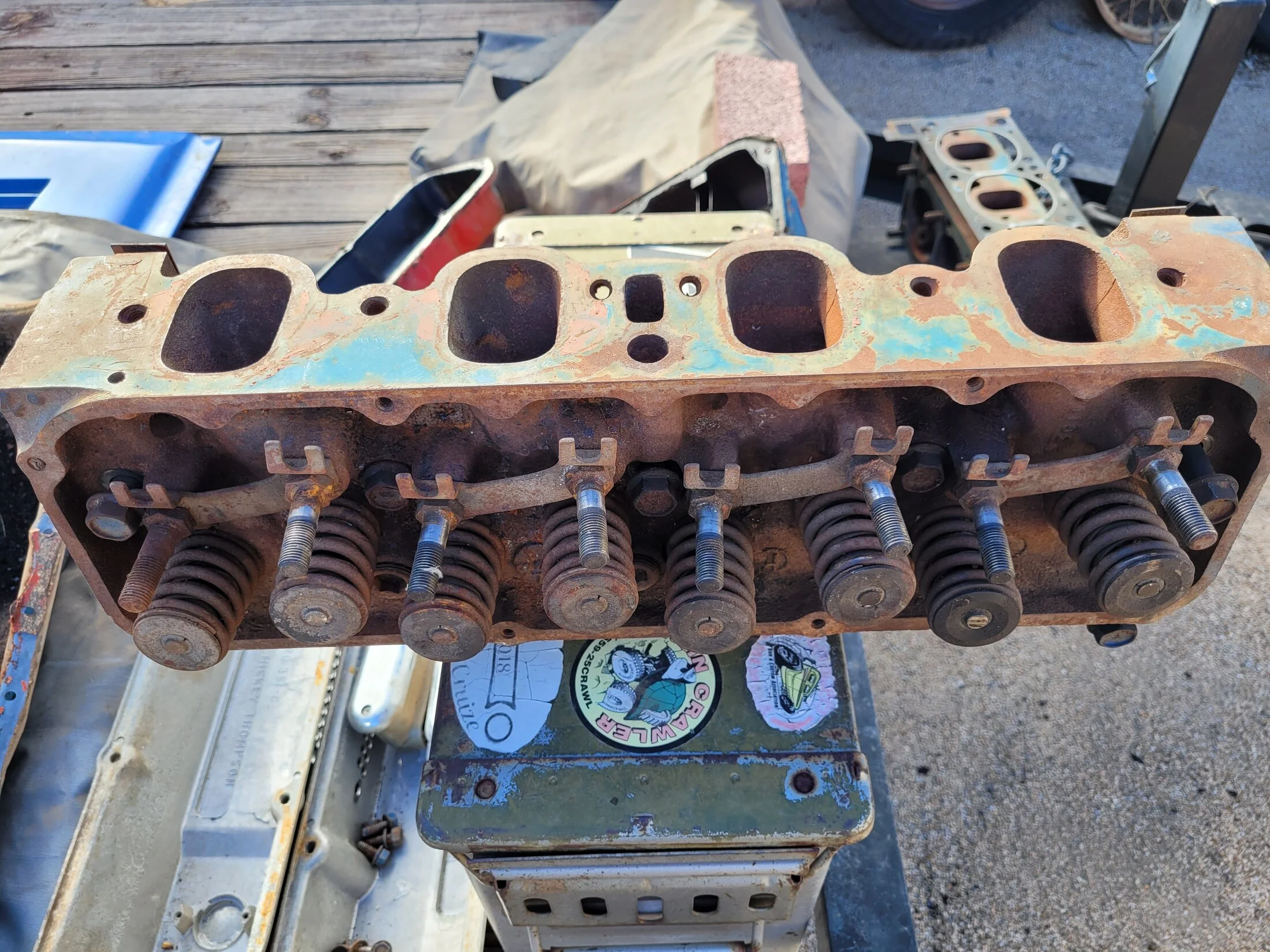

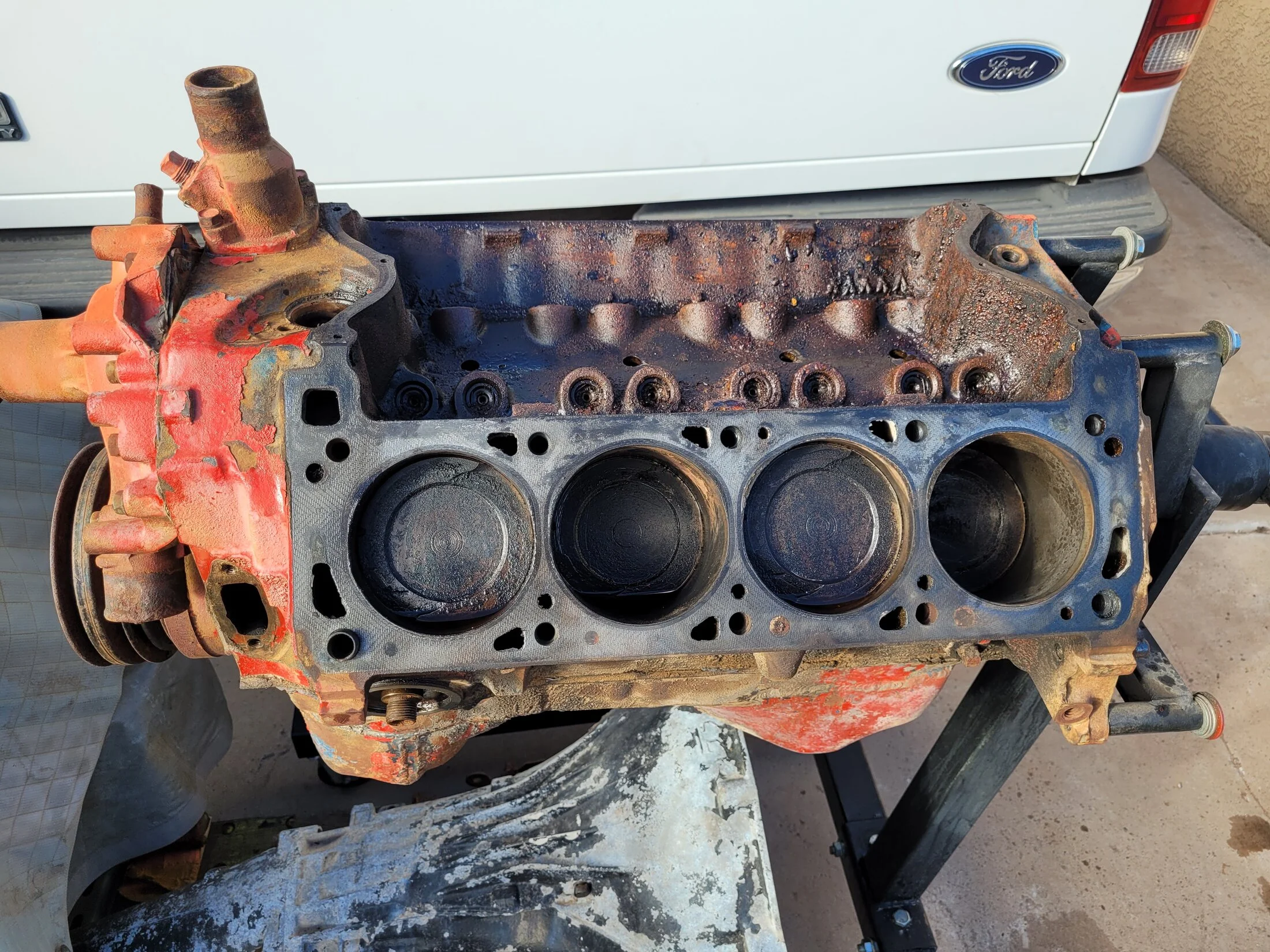

Part of the Mustang stash includes these two 351 Cleveland engines. Unfortunately, they have been left outside for many years. I really want to rebuild one of these as the future motor for the 69.
This morning I tore into them to find what I suspected. It was a horror show. Lots of rust and crud.
The blue one has newer 30 over pistons (although one of the 8 is different). It's heads are 4V open chamber and have screw in studs and guide plates. Has CompCams roller tip rockers and TRW forged pistons.
The red one is also 4V open chambers. This motor appears stock. No mods that I can see. It's also a disaster.....rust and alot of motor sludge. Had water in the oil.

I used Rust converter on any rusty areas. Then undercoating over everything. I need to weld in some new metal under the battery mount still. Then clean and paint the engine bay.
The area under the battery mount was rusted out. Surprisingly the reinforcement piece under there was still solid. I cut out the rust, welded in a patch, then welded in the reinforcement piece, then alittle filler and primer. Much better now.
