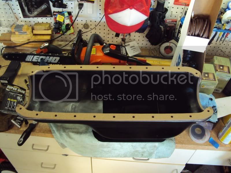

I put the gasket onto the pan, and used super glue about every 5 inches and in the four corners to secure it.
Used Black RTV in the corners and bearing caps. For sanity sake it wouldn't hurt to do a thin coat all around though.
Then I just lifted it onto the block and bolted it down.
It takes some time to get it to stop leaking. Even when you think it shouldn't be. Mine took about 4 re-tightenings. Cork is pretty weird material.
Pictures were before the first startup, it got a little messy after that haha
Good Luck!
Good Luck!
