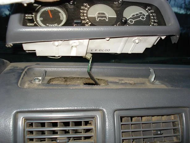

The point of my instal was to keep it as low profile as I could. The rear of the body is sitting directly on the metal of the dash under the foam which I carved out where it needed room. I trimmed the bottom of the face frame and cut off a large chunk that was sloped to fit the right hand drive dash board. I also modified the mounting frame, which was a full length peice that went under the whole unit and then up the sides to attach where I have it attached. I cut the original frame and just used the 2 "L" brackets to mount it directly to the dash. Once it was mounted I trimmed the rear cover to fit down onto the dash nicely for a factory look.
The wiring is very simple, just hook into the switched power of the dash lights (I used the heater panel lights as they were easy to get to) and ground the smaller wire. Note that there is a hole in the dash under the foam for the wires on the stock north american Clinometer/Altimeter that is large, ugly, and looks like a Tercel. :D
You can see a little of the rear cover in the right of this first pic.... and McGrew dust.... :D

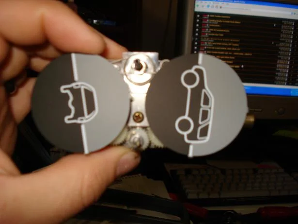

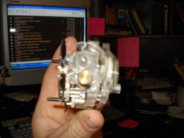

The Clinometer mechanism is interesting. Lots of little parts in there.... In the third pic the 2 curved blue lines are where I used a dremmel to make more room for the weight to swing, and the small blue dot is where there was a "post" coming out of the white disc that stopped it at the top and bottom of it's swing.
The new working range of the clinometer..... I hope to never use either of those to that severity....

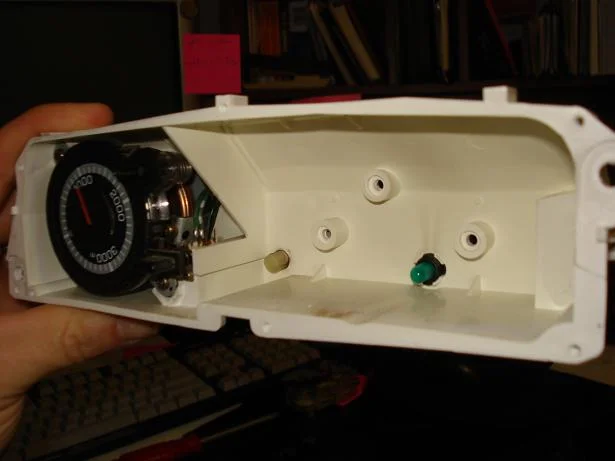

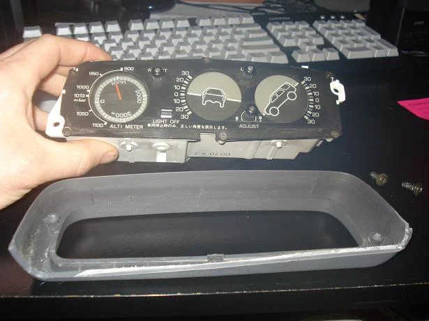

And a few shots of the Altimeter section while it's apart.
The inner unit is about 8 inches long, 2.5 inches high and 2.5 deep. With the case on it's 9.25 long, 3 high, and 3.25 deep as modified by me, the original dimentions are lost to me :D
