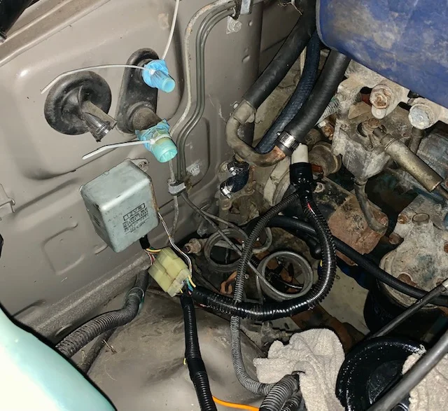

So good news, after many sleepless hours of reading and looking at electrical schematics I sort of get what the edic does and what all of the rainbow of colored wires coming out of it are for! ha-ha. It seems to me like a good system. A few members suggested I simply use a Toyota choke cable for shut down and I was going to go that way but only if Dave and I couldn’t sort the edic system out. Those diagrams you sent me really helped big time! The only wire that was a real mind bender was one larger black wire that said “unknown" on the diagrams but later we found out it needed to be wired directly to the positive (yup black wire) terminal on the battery. There is a low oil pressure emergency shut down wire too, but I dont have the sender on the engine, so I might just wire in a small 12v alarm later on. I included a photo of where we mounted it to the fire wall. It was sure exciting to see the arm move on the fuel control box on the engine and she fired up with one quick push of the temporary Wilson switch. She donest smoke and runs like an old farm tractor...purrrrfectly!

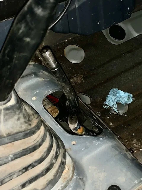

In case anyone ever needs a late model transfer case shifter assembly, I now know it is possibly to heat bend a older 4sp T-Case one into shape for the 5sp conversion! That’s working smoothly now too.

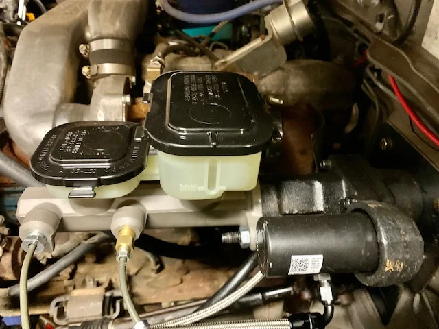

So due to the close proximity of the turbo, even if clocked, to the vacuum booster and master, we went with a Hydro Boost system. It seems to have more room for cooling from the exhaust side of the turbo now, but might have to add a small heat shield. This is still a work in progress but should have incredible braking power. All brake lines are plumbed in and are using an adjustable proportioning vlave system for balancing front to back.

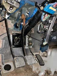

I found the manual transmission pedals in a parts truck and went out in a pissing down rainstorm to get them. What I didn’t realize after working for 2 hours and soaking wet is that the whole dash has to come out to get at the top plate bolts! I thought it was welded in there and would have to be air chiselled or drilled out. Duh! Once I figured it out I went back on a niceer day and got them out. They are installed and working like a charm.

Cool. More info on that brake hydrobooster. Very curious
X2
What hydro booster did you use? Did you get a P/S pump from a hydro boost setup with two return lines?
I’ve been studying up on Saginaw pumps… and have seen quite a bit about boosting pressure and volume. What pump are you running? Any mods for hydro boost?
Morning Cruiser pilot, I used to see them when I worked at the brake shop back in the day and now it seems they are getting to be a rare thing...except with race car guys. I remember that the Hyroboost produced a lot better braking on heavy trucks and they used them a lot on diesel powered trucks. The Hydroboost got popular again in the late 80s through to the 90s and where used on a lot of Ford Mustang GT and Cobras. I needed my lines to come out on the fender side and was lucky to find a very old stock one from a early 90s Astro Van (oh boy) and am using a detached adjustable proportianing valve to get the balance correct for and back to front discs. Here is a very good link with lots of info Hydro-Boost Brake System for 1979-1993 Ford Mustang - https://www.powerbrakeservice.net/new-1980-1987-ford-mustang-hydroboost-brake-booster.html
Hey brother, nope just plummed into the existing Toyota power steering pump and yes Dave made me a small adaptor to bolt the Hydrboost to the stock firewall location. I finally located and then purchased a stock HJ60 PS resevoir from Dan out at 4-wheel Auto in Alberta and thats in the stock mounting position, but its too mounted low and power steering fluid is backing up and leaking out the top a bit. Its getting relocated to a higher location this week hoping that solves things or might have to buy a Wildwood aftermarket resevoir. Its a bit of trial and error.
