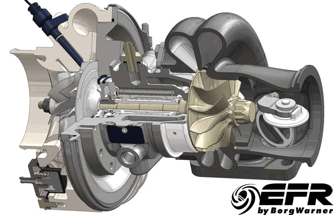

So is the curve in the blades (vs paddle wheel) intended to give a smoother gas flow as gases change direction through the turbine housing?
@Dougal
Would you put the eBay listed one in your "generation 3" category?
Yes. The used CT20B turbine wheel above looks like what I'd call Gen 3 high torque wheel. Comparable to modern Holset, Garrett GTX, Borg Warner EFR etc.
Here's a GTX from ebay for comparison:
Garrett & HKS GT2871R GTX28R GT28R Turbine Wheel Shaft
Borg Warner EFR cutaway:
» Borg Warner EFR – The Worlds Most Advanced Aftermarket Turbocharger
The paddle wheels are Gen 1. I see rubbish wheels like this all over ebay, even claiming to be genuine.
