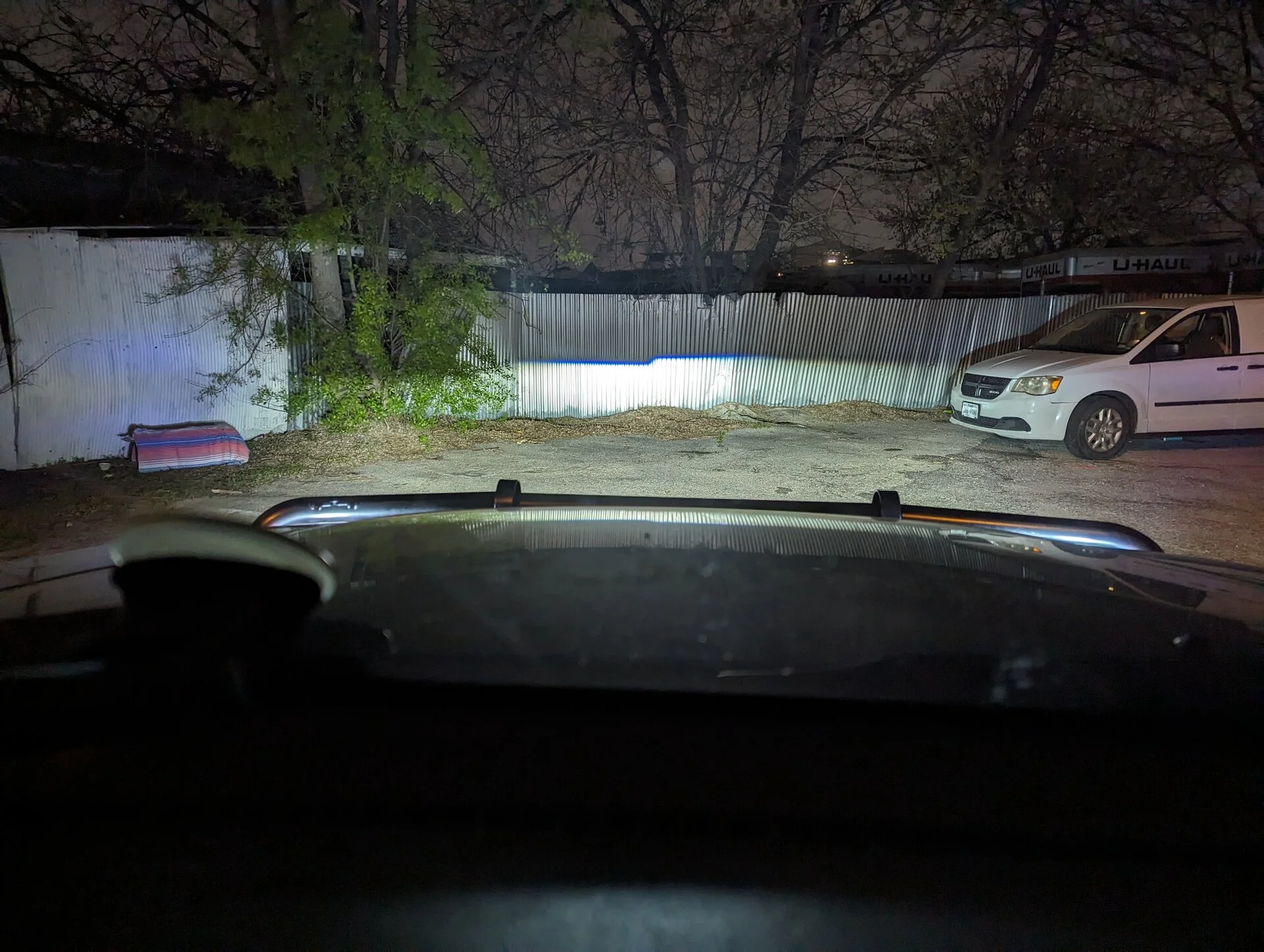

Can you please post a picture with the low beams projected onto a wall 30’-40’ away?
Is this what your looking for?
Yes, thank you! Output looks slightly different from HID’s but still sharp cutoff. I would have gone this route had I known about them when I bought my retrofit kit couple of years ago. Not sure if they were offering this product back then but glad we have the option now.
