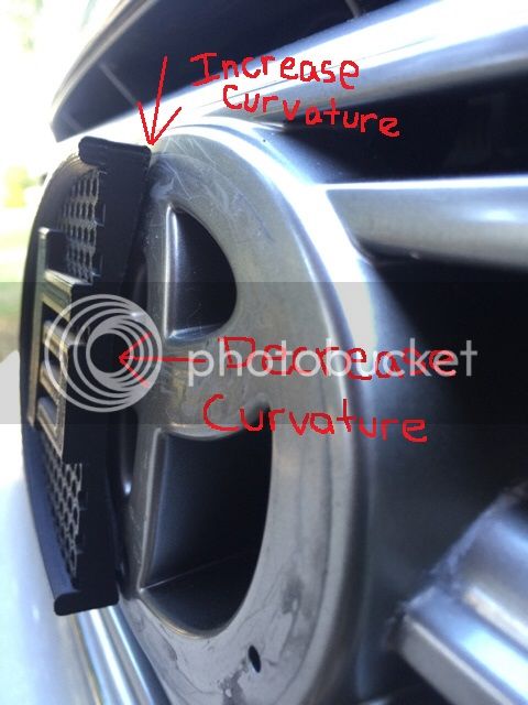

I wanted to give an update on the TEQ badge for the 03-07 100 series grill. It has been a little more tricky then I had anticipated. I have gone through a few prototypes with Nick and hope to have something dialed in perfectly soon. The back curvature has been given me all the issues. I have the height, width, and overall depth perfect but the rear curvature still needs to be dialed in so it will sit flush to the grill but still grab the adhesive properly.

Guys please be aware that this is a rough prototype printed at high speed for fitment purposes only. It looks like I need to decrease the curvature in the middle and add a slightly steeper arch at the edges to allow it to sit a little more snug. I will get to work on those changes today. That 1/2 piece was a good idea. I can now clearly see what needs to be changed.
Here is a pic of my thoughts.
Better than the first one but still not making great contact on the edges. I think that it needs to stay flat to allow the adhesive to press then bend into the curve. I took a picture to show you the width of the band for the outer ring of the sombrero. The adhesive through the curvature is still missing the contact.
Another idea would be to make it a little bit larger. That might give it some more adhesive contact area around the edges.

The edges are laying very nicely in this one. I think making it slightly larger than stock would help by giving it more contact area. Part of the problem also is that we aren't sticking this onto a flat solid piece. The cutouts prevent solid contact with the adhesive as well so there is less margin for error to get a sticky surface in contact with the grill.
Not having any attachment hardware other then adhesive is turning out to be a huge pita. I will ship you one 5% larger and see what we get. If it's still needs changes then I am really going to need a grille. I don't think the TEQ badge for the 03-07 100 is going to be a huge seller so i have to be careful how much I put into this project. At this point I'm getting close to my total possible profit. My guess is that I will sell 15-20 of these total. When I make about $5-7 in profit each; I'm only looking at about $100-130 in total profit on this little project. I have probably spent close to that just in filament, shipping, and machine wear and tear. Those numbers include zero of my actual time working on this. I would at least like to break even on this project and not loose money in the R&D step.
