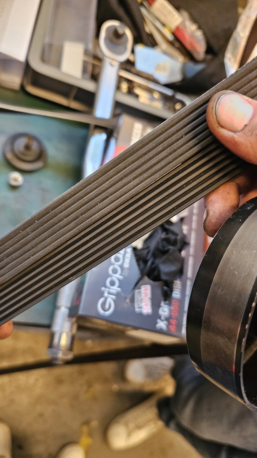

This weekend i replaced my tensioner assembly.
A new belt 90916-02596 - which is length 2240mm - did not fit my engine. This new belt is provided by my parts store (LC specialists) is basis my VIN number - and they swear its right one. When i stretched out the old belt next to the new belt they appear to be exactly the same lengths. The old belt still fits on the engine with the new tensioner assembly - as you said it would Hoser. Unfortunately the old belt is too worn to read it's part number. I'd like to replace the belt in case the old one with unknown years of service breaks. My guess is that the ribbing between the two is the problem - see photo - new belt 90916-02596 at the bottom with a more square/deep ribbing.
Should i just wing it and get a 2245mm or 2255mm belt? Or how to find right OEM belt?
I'm seeing 90916-02586 as the correct part number for the belt (2001LC). Edit, I see @hoser got there first.
