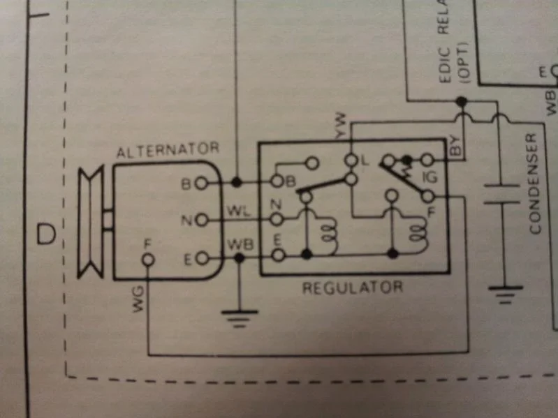

Nice diagram, now what's the question?

OK, I've read your other thread and your question is: What do I see here?
Here is the same diagram but now a bit more easy to read and understand.
Rudi

by the diagram you post ( thanks ! ) after key is ON that close the circuit and allows B voltage going to the charge lamp at dash .. and if I got it right since E port on Alt going to the VR it's grounded the light will go on .. which means alt it's not charging maybe coz it's not running ( engine off ) or it's damaged .. ( despite running it's running or not )
What I don't get it's how the V Relay play in the game ..
V relay is only for switching on the charge lamp.
When the key in "on" but the engine not running the lamp is between + from the key and - (ground) via the V relay. So the lamp is "on".
When the engine is running and the alt is charging, there is a voltage from the N terminal that activates the V relay. The V relays goes to the down position and now the lamp is between + from the key and + from the battery. In other words the lamp is "off". When the alt is not charging for one or some reason (there is no current flow) there is no voltage at the N terminal so the V relay goes off (to ground) and the lamp comes on.
Rudi

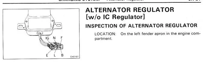

got how it works .. and would need to find that L wire here .. ( VR Box plug )
attachment.php

From your diagram:
B=Battery White
N=Null White/Blue
E=Earth/Ground White/Black
L=Lamp (Charge) Yellow/White
IGN=Ignition Black/Yellow
F=field White/Green
I don't know if these colors match the connector you're showing. Maybe you have the wrong diagram.
A diode is not a resistor. A diode is a rectifier (to make DC from AC) or a one way port/valve (the current can go only one way). The typical voltage drop over a diode is 0.6Volt. So two in series makes 1.2V and so on. Diodes come in different Voltage and Amp values. Depending on what your plan is you need to pick the right one.
Rudi

Is this what you're looking for?
L is bottom center.

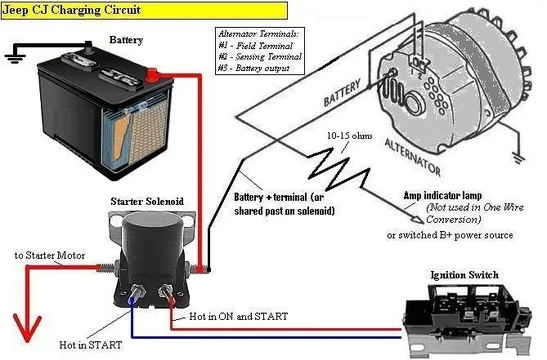

well I've been reading A LOT ! :eek: about this and for the kind of Alt I'm running ( which I dunno why needs between 1.5V and 11V on the L port to be activated ) looks like I'm going to end with 2000ohm resistor ..
What I'm trying to locate it's kind of one that can be used in out intended application .. I mean hold on temp, dust, water etc ..

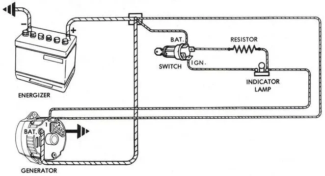

I think you're looking for this:
Just Google for "GM alternator wiring diagram" and select pictures.
Rudi
