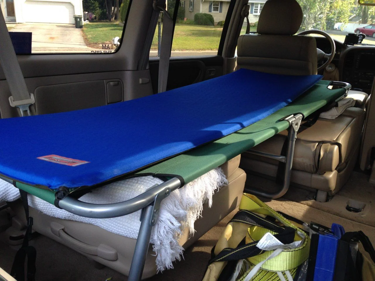

Temporary Sleep Platform
can the grab handles really handle a 200+ person??
I thought about that after pic; used my climbing rope slings between both grab handles upfront and used the 3rd row seat belt anchors for rear. I'm 150lb and it was fine I needed more tension cause my butt rubbed the 2nd row seats folded down but it just was not for me.
After reading the posts, I experimented a bit with my camp cot. I think this setup will be perfect for my needs. I have 2 of the 3 cot legs down and the third one folded and lying on the middle row. Everything folds up and could be setup in just a few minutes. Though, since I'm heading up solo, I'll just set it up before I leave.
Thanks for all the feedback guys.

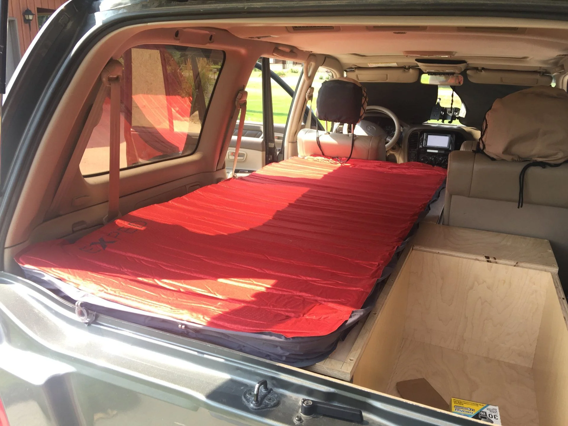

I did this... a quick removable panel off the front of the drawers over the 60/40 seat. It just rests on the seat back.
And with the most comfortable mattress on the planet...

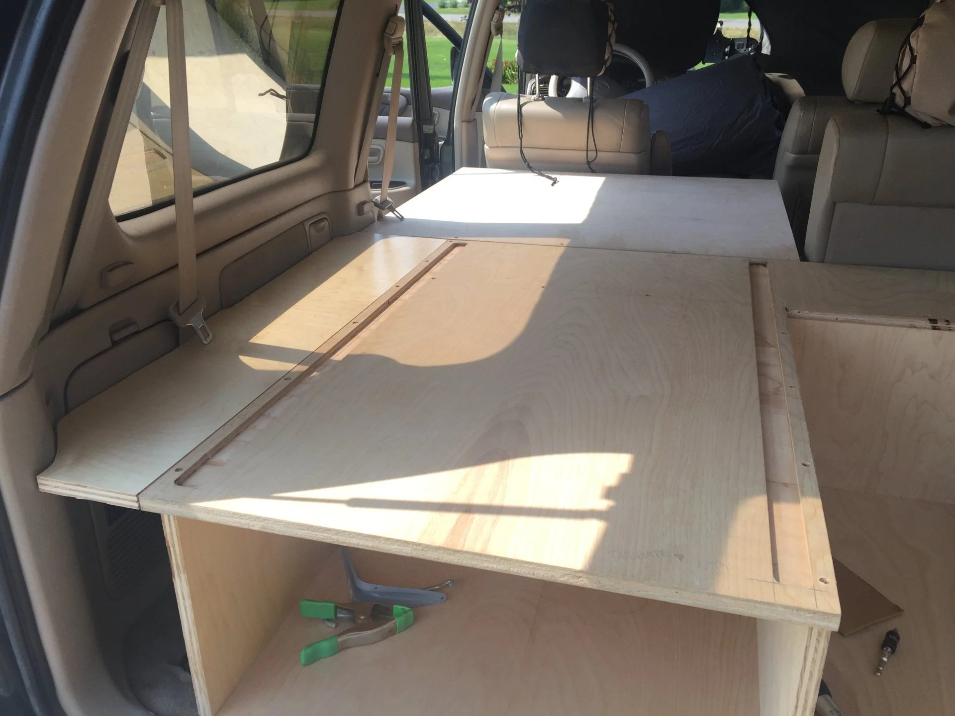

I've been thinking about building a one side drawer / platform with a flip top to complete a sleep platform. Has anyone executed that specific idea?
I have a fridge in one side of the rear, it would be a sleeping area for one of my kids, I'm too tall to sleep inside the car with the second row seat installed .
Can you give us dimensions and how you built it/price/etc.? How difficult was it to do, and did you need any specialized tools or could you get the pieces cut custom at a place like Lowe's/Home Depot?
There is a whole write up in my signature link, however this is not an easy project. If you know a wood worker that likes a challenge then go for it. It likely wont be significantly less than the commercial units when complete but it'll be the way I want it. This is not a few boards cut down at Home Depot, it is pretty involved... that said, ANYONE can learn how to make stuff. Just gotta jump in, use what you have available, buy some tools and practice.
Link to drawers... HERE
Hey @ozmannyy how'd the cot work out for a temporary sleeping platform? Is it a certain cot that fits? What specific cot do you have?
Anyone know if this would work in a 200? Looking for a quick 1 person temporary sleeping solution for next weekend:)
