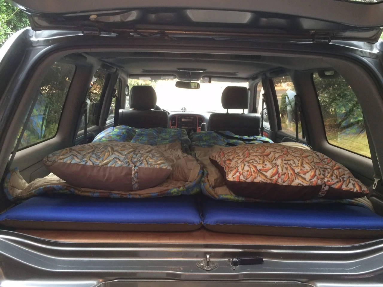

I'm 6'2" and wanted a camping platform as well. My Solution: 3/4" plywood cut to 6'4" long placed on top of the half-folded middle row seats, and supported by the tailgate with two small jackstands. The 3/4" doesn't bend under our weight, I rounded off all the sharp edges. Gives about 13" of space underneath, room enough for stove, camping box, smaller cooler, etc. When cut to 6'4", I can leave the bed set up with our seats in our normal driving position while we're driving. At night, just move front seats forward for a bit more footspace. Cut a screen for each rear door window, hold it on the outside with four magnets - plenty of ventilation with my Weathertech deflectors. I have Thermarest luxury pads, much thinner than an air mattress, and a lot more comfortable, particularly with two people, no bathtub effect from an air mattress. We find there is enough "headspace" above us to get in and out very comfortably.
Thats pretty interesting and I would have never thought to use jackstands. Do you pad the underside of the wood with anything to protect the leather?
