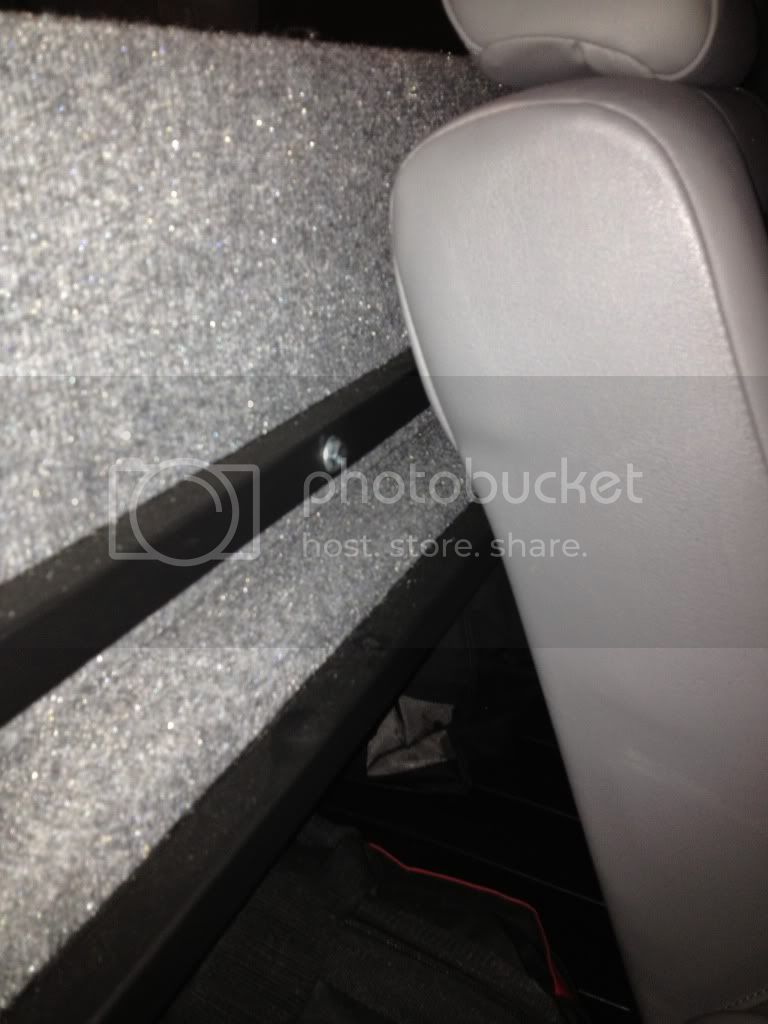

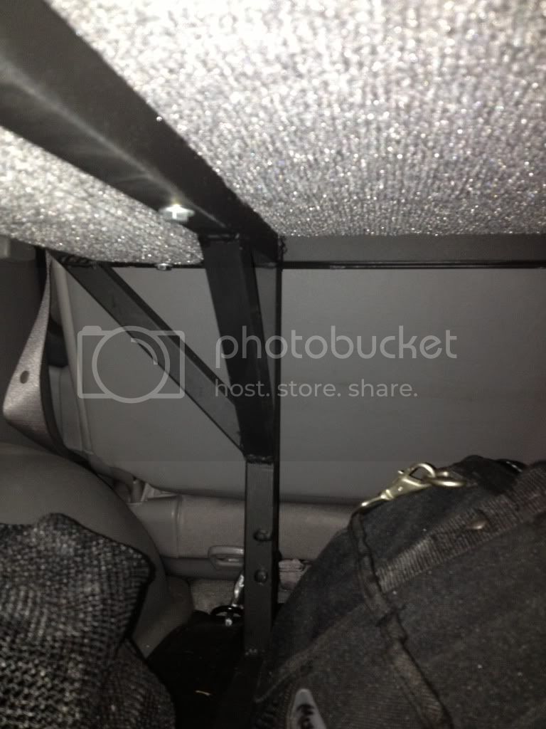

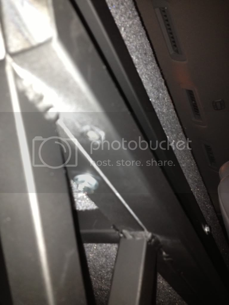

Sorry it took so long for this. Here are some crappy pics of the platform. The tubing is 1" and there is some angle iron along the sides to hold the upright in position. There is also a couple of short pieces of flat bar also for the upright section. I used 1/4 inch t-nuts throughout and a couple of welded nuts on the angle. The basic dimensions are as follows:
Bottom platform layer is 51"w x 38"l
Top platform is 53"w x 31"l
Upright is 53"w x 8"l
All 3/4 birch ply
The metal frame essentially makes a box, and the upper pieces overhang. The "box" section is 33" front to back (outside dimensions) and 36" wide. It is 15" tall (14" clearance underneath).
Since the upper platform is 2" wider than the lower, there is clearance for the 1" angle iron that is mounted to the underside of the upper platform. This has welded nuts and is the support for the moveable upright. The metal frame has two pieces of square tubing welded together along the forward upper portion. The rearmost tube is bolted to the forward edge of the bottom platform, and the forward tube is available to bolt to the rear edge of the upper platform when it is slid forward into place. Clear as mud?
Also, I'm 6'1", all leg, and with the platform extended (with the upright still up) I have plenty of legroom driving. When you stop for the night you can slide the forward seats forward and lower the upright, giving you a platform length of 77". Add in the little extra space on both ends and there's plenty of room.
