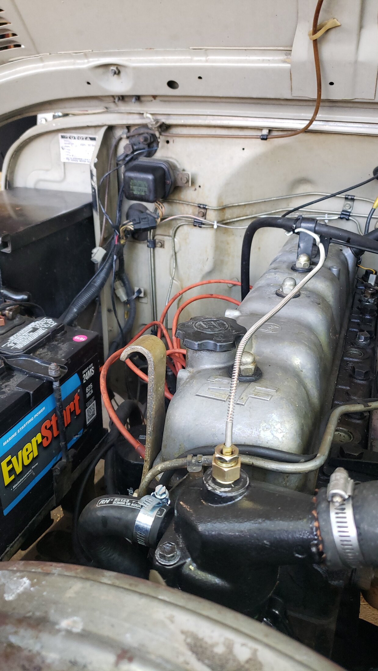

1973 FJ40 Stock 1F. Vehicle sat for a few months since last driven. At idle the temperature gauge is going all the way to the left within 10 minutes. I took out thermostat and tested in boiling water, opened fine. Replaced the sending unit - no change. Ran motor with no thermostat and cap off. The water was circulating but not a lot. I took my heat gun after it had been idling for about 15-20 minutes and got these readings: Water temp at radiator with cap off 175, Radiator 180, Hoses average 170. Heater hoses 160-180, Thermostat housing 181, Right side of head 176, Right side of block 145, Top of head where manifold connects 220-250, sending unit 225. I think the water pump is OK, bc it was circulating. Maybe bad gauge???

Start by measuring the resistance of the sender hot and cold.
if that checks out then check the feed voltage at the temp gauge - should be regulated to about 7V. maybe your fuel gauge needs a clean up?

If you measure the resistance of the sender when it's hot and cold, then you'll determine that you have the right sender, and you'll be able to establish if you're running too hot.
I assume that you have an electrical multimeter given that you have a 40 ;)
If it's misreading, then it's most often the gauge and it's supply voltage, but this is independent of the sender resistance.
