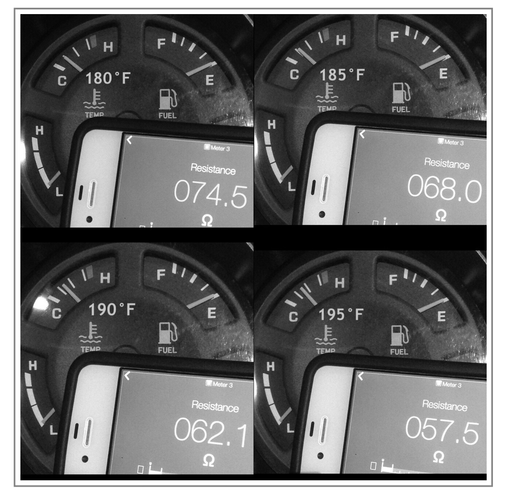

Your gauge may be fried but the napa replacement sender is more the suspect.
If you place a 60 to 70 ohm resistor between the gauge sender wire and body ground, the needle should move up a bit into the dial.

Resistor inline is definitely a possibility to try and save the factory gauge. It's nice having it there as a quick reference while driving, Sniper as a backup if I need a more accurate reading. I'm wondering if melting the wire caused a short to ground with enough current, which in turn bent the (I assume bimetal?) tabs that heat up and cause the needle to move? I do remember right before the needle dropped out of sight it did peg well past the overheat (I checked the Sniper and had normal readings and wasn't concerned). Probably too delicate to try bending back into place.
Thanks for the reply OSS, I had read the article with that picture in it, I'll have to go back and re-read it now with some possible intention of wiring the resistor in.
Clark
Connecting a resistor inline to ground is only a test to see if the gauge works. It’s not a fix.
High resistance = needle in the cold zone.
Low resistance = needle in the hot zone.
