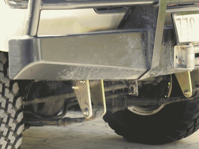

tell me about "anti-inversion" shackles?
there is NO hole for a third bolt...so I dont know what you are looking at Mace..
But anyways...since there is no third bolt hole it appears that they arent anti inversion shackles afterall...well I guess the pic proves that anyway.

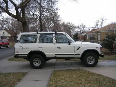

I have an 87 fj60 with OME heavy springs in rear and med springs in front with stock shackes. My problem is that the front end is lower than the rear...how can I correct this? I want the vehicle to be level and am thinking of installing 1 inch (over stock) front anti-inversion shackles? good idea?
got a pic of the cruiser and do you carry around anything heavy in the back of the cruiser

I am using the cruiser off road primarily with a load in the back (extra fuel, gear, 4 people) I will try to attach some photos to illustrate my problem. The front end is much lower than the rear. the pic shows the vehicle on a sloped drive way...which doesn't help with the illustration.
attachment.php
I have 5 leafs in the front pack and 8 in the rear
I measured the front shackle bolt to bolt = 3 in
and the rear shackle bolt to bolt = 3 1/2 in
You would be better off with a add a leaf or some new springs in the front.
Don't you think a 4 inch shackle repalcement in the front would be ok?
How about if I replaced the two front with anti-inversion style shackles?
which size add a leaf? I have OME on the vehicle now...should I have a spring shop do it?
i think an add a leaf in your case would be a much better solution. i dont know about different size add a leafs

Mine from MAF look very similar to the ones on Toy60's rig. The 3rd bolt is
about the same size as the others. They call them 4+ now but back when
I bought them they were just anti-inversion shackles.
