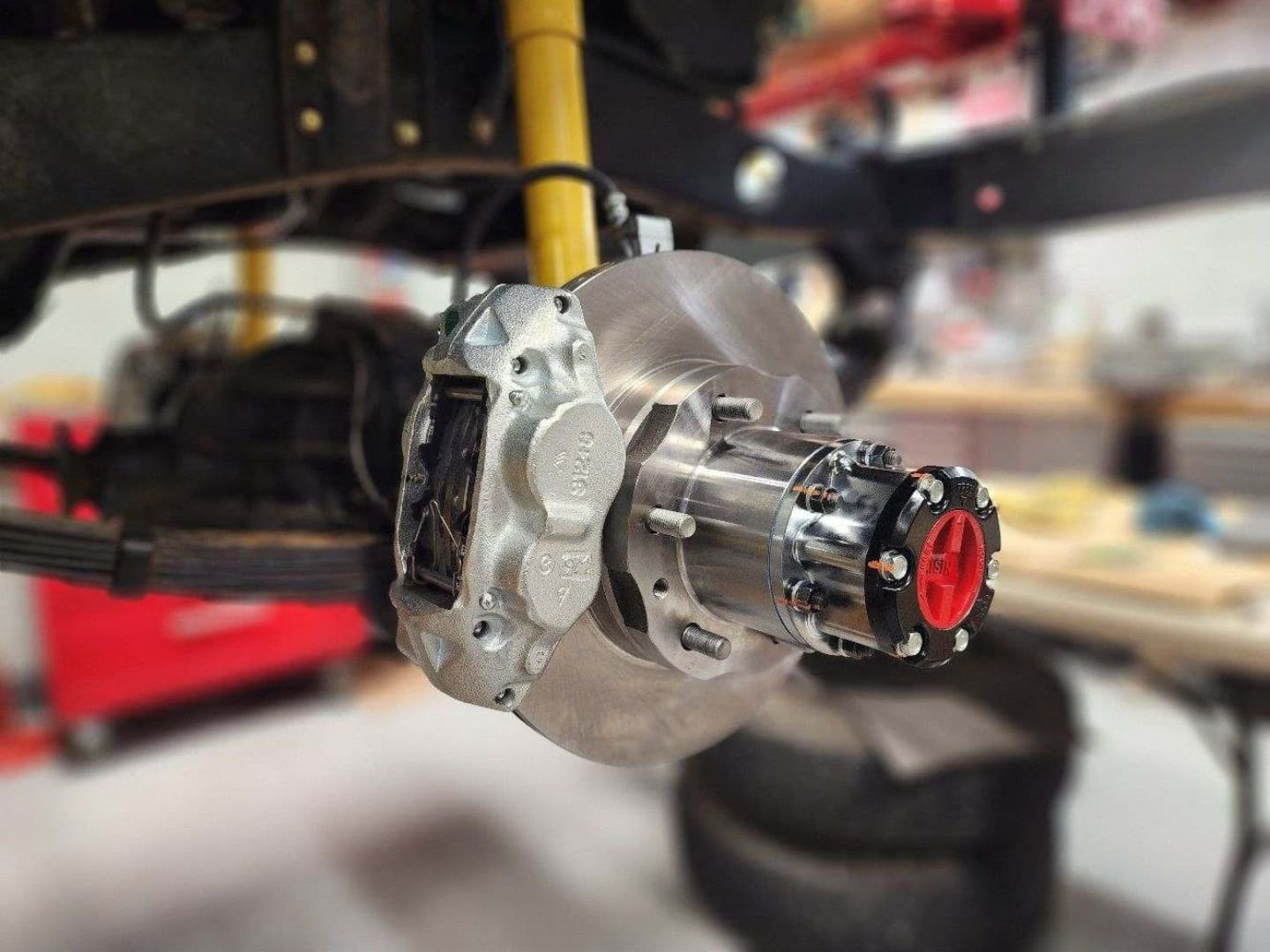

We've sold and installed hundreds of disc brake conversions over the years, here is one we recently did here in the shop :cool:
Skip anything that has you reusing course spline birfield outer axle and uses adapters to fit GM calipers and rotors. Like hard pass skip. These require you to re-use your course spline (low strength) outer birf joint and free-wheel hubs, both of which have no options for upgrades. If you have a 1958-10/67 4x axle, you'll also want to upgraded your entire front axle assembly not just the knuckles/brakes. The 1958-10/67 axles don't feature an inner axle seal (can be overcome with a conversion seal) but also have smaller diff studs, course spline inner axle shafts, etc. You can find inexpensive 68-75 front axle housings and differentials that will be great recipients for the disc brake parts. Likewise 1958-7/1970 Land Cruisers have a smaller 9mm brake line system, both at the master cylinder and the hardlines, hoses and wheel cylinders. Any disc brake upgrade is going to be 10mm fittings and thus you'll either need to convert from 9mm on the frame to 10mm on the axle OR upgrade your entire vehicle to the 10mm lines. This will also hold true for the master cylinder. If you choose to upgrade the master on your 9mm fitting 1958-7/1970 Land Cruiser, it too will only be available in the common 10mm fitting, so you'll need to address that as well.

Source a donor axle from a 9/75-1/90 4x/5x/6x/7x Land Cruisers or a 79-85 PU/4RNR with factory disc brakes. Generally speaking the later the parts, the better, bigger steering arms, better brakes, etc.
Armed with the core axle, a good rebuild kit and some minor conversion parts (depending on the source of your donor parts) you can swap all of the disc brake components from the disc axle to your existing drum axle (so long as you have a 1968+ axle housing) and it stays all Toyota.

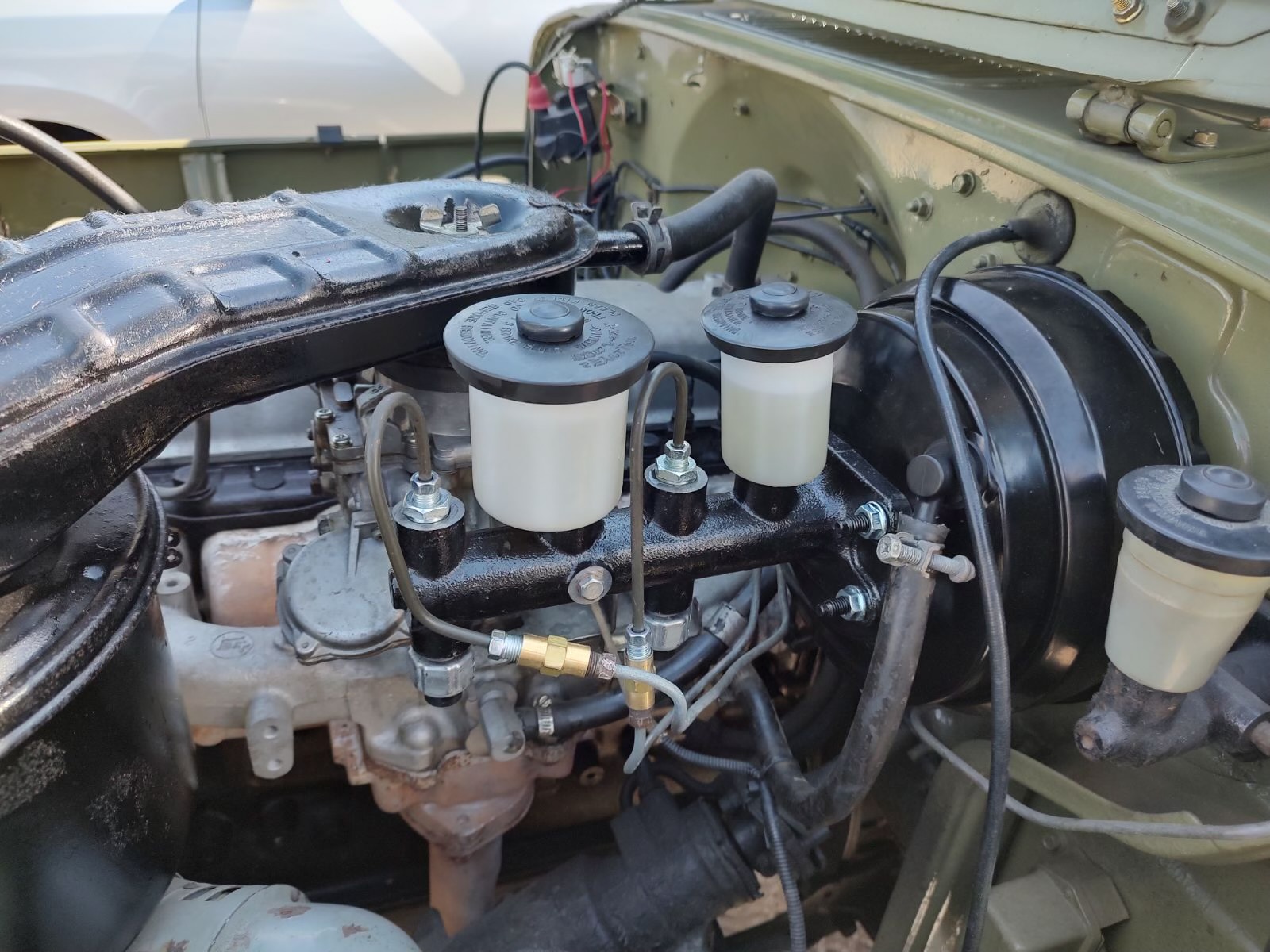

Don't forget to address your master cylinder by either modifying the front circuit to work with the discs (delete residual valve) or replace with a new cylinder, the FJ80 cylinder is a popular option. You may also consider adding a vacuum brake booster (though not mandatory), all 1958-7/70 Land Cruisers will have a rib on the firewall that will either need to be removed (not always ideal) or use a brake booster adapter to mount a common 6x/7x/8x booster. Some engine conversions will make the longer booster/master tough to fit.
All in it can be done for $500-1000 depending on parts needed (Can the used rotors be resurfaces/turned? Are the used calipers serviceable? Wheel bearings in good shape? Etc). Perhaps even cheaper if you get a good deal on an axle and it's in good shape.
Consider your donor axle:
9/75-1/79 4x/5x: Easiest as parts are a direct swap, no grinding, no conversion steering arms or shims, no swapping inner axles on the disc birfs. Downside is a less common birf, small knuckle studs/pattern (but the same as your current drum axle pattern so you can reuse your current hardware, steering arm and bottom bearing cap if needed). You will need everything from the birf outward (birfs, knuckles, spindles, hub bodies, calipers, free-wheel hubs). Combine this with a knuckle rebuild kit and minor parts and you're ready to convert your front axle.
1/79-1/90 4x/5x/6x/7x: Bigger parts but a bit more swap work, you need to grind the inside of the axle ball (super well documented), convert steering arms and swap an inner axle shaft with your original if using the longer 6x stuff. As these are far more common (6x in particular) this is likely the best solution and gets you birfs that are easy to upgrade/source should you start pushing them hard. You can also upgrade brake calipers to the 89-95 V6 PU/4Runner with some minor backing plate trimming. You will need everything from the birf outward (birfs, knuckles, steering arms, bottom bearing caps, spindles, hub bodies, calipers, free-wheel hubs). Combine this with a knuckle rebuild kit, tie rod end shims (Part# TRESHIM) and minor parts and you're ready to convert your front axle.
79-85 PU/4RNR: Requires grinding, steering arm conversion and swapping both inner axles with your current ones (nothing to be afraid of). Worth upgrading these rotors/calipers to vented while you're there. Same birf as the 79-90 Land Cruiser too. You will need everything from the birf outward (birfs, knuckles, steering arms, bottom bearing caps, spindles, hub bodies, calipers, free-wheel hubs). Combine this with a knuckle rebuild kit, tie rod end shims (Part# TRESHIM) and minor parts and you're ready to convert your front axle.
