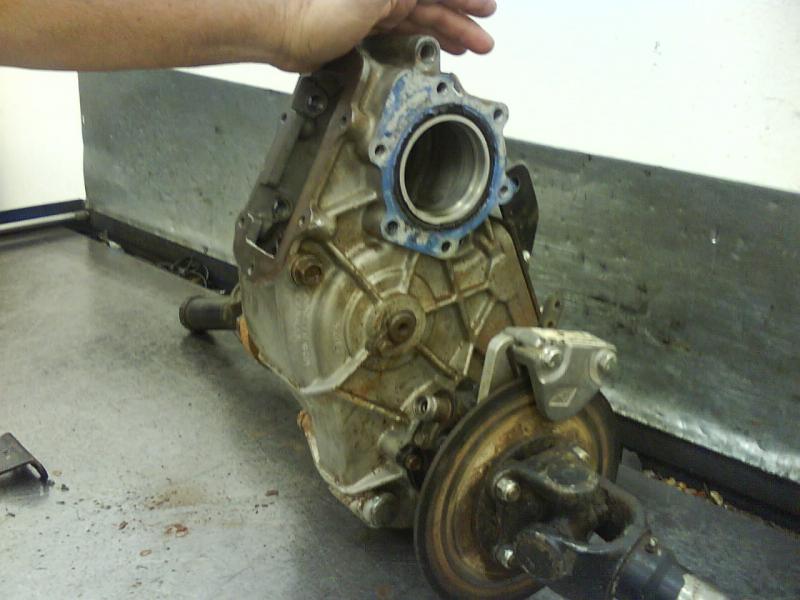

Marlin Transfer Case HELP!!
I broke my input shaft on my transfer case. My transfer case was built by Marlin Crawlers in 1996 (stamped Marlin Crawler #014) using 3.64:1 gears.....I called Marlin today and they no longer make that gear so I :
1. Need to find a input shaft that someone has and is willing to sell
2. Find an alternative input shaft what will work with my transfer case without having to change the gears
3. Change the gearing and get a new input shaft. (any suggestions on what gearing ratio I should go with would be appreciated). I am currently have a SM420 transmission with the Advanced Adapter.
Any info would be greatly appreciated...
What t case?
I like the 4.7 in my mini truck case.
Can the gear be pressed off and just replace the shaft?
Yes, all I need is the input shaft (clean break). My transfer case was built by Marlin (1996) and when I called them they acted like I was from MARS and that I would have to change all of my gears becuase the 3.64:1 input shaft was no longer available??
besides being a MC what model T case is it?
Not sure, I am heading to the shop in the morning to inspect it. I may have been incorrect as I was looking thru my file and it appears that it may be a Toyota Transfer Case with Marlin Gears and not a Marlin Toybox. I will inspect and take pictures in the morning to upload and see if I can get some help finding what I need--Thanks...

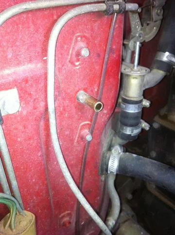

Hose to no where... or from no where.
Found hose attached to firewall on passage side going no where. Searched and only place I could find to attach hose was the distributor. Hoping for some help: What is this hose attached to (firewall side)? Depending on answer, what does it do?
<img src="https://forum.ih8mud.com/attachment.php?attachmentid=569799"/>
<img src="https://forum.ih8mud.com/attachment.php?attachmentid=569800"/>
Vent drain tube it suppose to be open :)

Thanks LL.

It's all that BS draining when you go over that big rock.
I did; just took it off for the picture. What is draining? Should I have an opening in the diff cover?
It drains the cowl vent. I had water leaking on the floor of my 70 model one time and under the dash I was missing the hose that went from the vent drain out through that hose in the firewall.
You should not have an opening in your diff cover thats not good, it must be at the top or you'd have a messy leaking diff cover.
