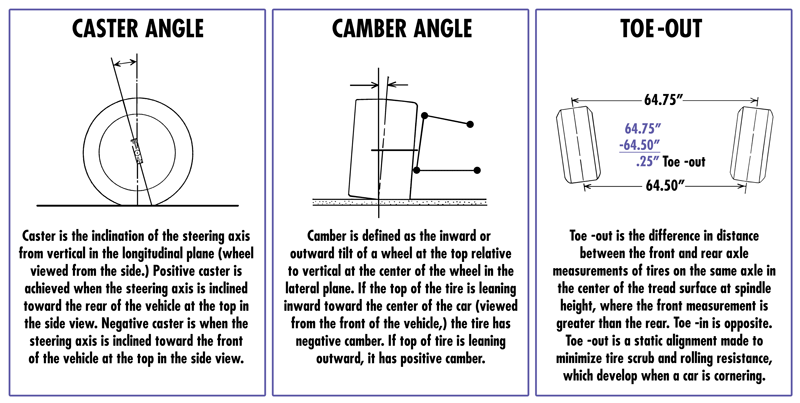

Long story short.....
Don't worry about camber with a solid axle (unless it is bent, lol)
Tow in will give you better tracking and help with tire wear
Caster will keep your wheels tracking forward. On a toyota, your knuckles need to be (don't quote me) 1-3 degrees positive (toward the cab). If you go too far negative your positive, your wheels will wobble like a shopping cart.
I have a question. Where do you measure for caster at? I mean where could I put my angle finder on what part of my front axle to find this measurment? Thanks
Got an update.Got it worked out. With big bias ply tires that will not balance, worn spring bushings , and no type of track bar I have been having some trouble with “death wobble” for a while. I swapped out to some street friendly radial tires and have no trouble with the truck, but put on the 34” LBT’s or the 36” IROKS and everything starts shaking at 25 mph (not fun and scary as hell).
Well made some time to address this and changed out all the old bushings ( only five years old ) on the springs front and rear along with the frame bushings with Energy Suspension polyurethane bushings with some four degrees steel shims (single hole that bolts to the spring pack, not the slotted type) Difficult to find a place to check the degree of the knuckles but for the time it’s cured. About to put the 34” on because in just a little time you can see the IROKS are wearing down.
Having too much play in those bushings can definitely set the wobble in motion. I found that the caster shims helped me a lot. I still get a tiny bit of vibration that smooths out quickly. However, the tiny vibration I get at lower speeds is nothing compared to the death wobble I used to get and may be due to the balancing beads in the tires not working at lower speeds or possibly due to differences in tire pressure (still haven't changed that pesky valve stem).
Any chance you know what helped the most bushings or shims?

I would have to say the shims. The bushings I had in there were not chewed up , yet I replace all of them while I was at it so I would not have to disassemble the truck a week later.
But I can say the biggest contributing factor is the tires. Those balloons tires .
