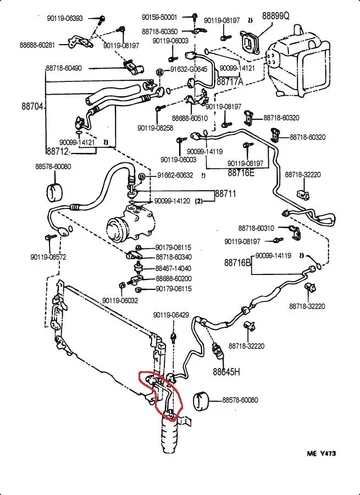

Does any one know the part number of the line I circled?
what year is yours ?
should be 88716-6A421
