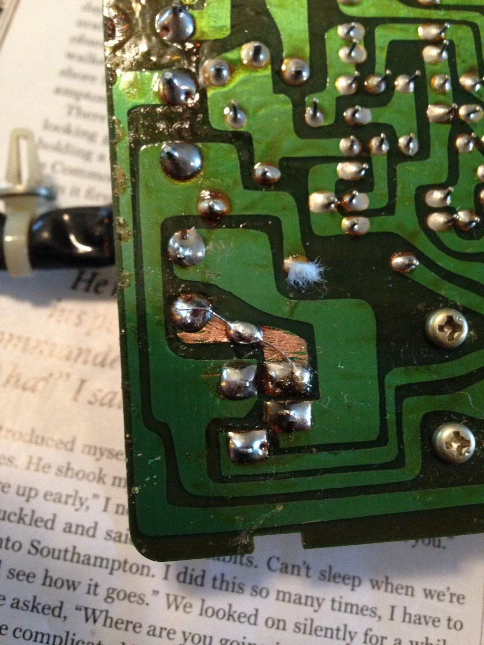

can you attached small alligator clips to each blob prior, to ensure the circuit is open/closed after and before soldering?
I did a soldering job on the circuit board. I did a wire and I put a little solder right over the area in question. We'll see if it helped. If not, I'll take the board to an electronics guy to trouble shoot. The pic shows a little lint from my rag I used to clean the board with; I didn't notice when I took the picture but I did clean it off before I put it back together.
The top left solder needs a retouch. The wire is on top instead IN the solder like the other two.
Good job! :clap:
Rudi
It didn't solve the issue, so I'll check the relays and take the controller to someone who can check it out. Oh well.
Damn! :censor:

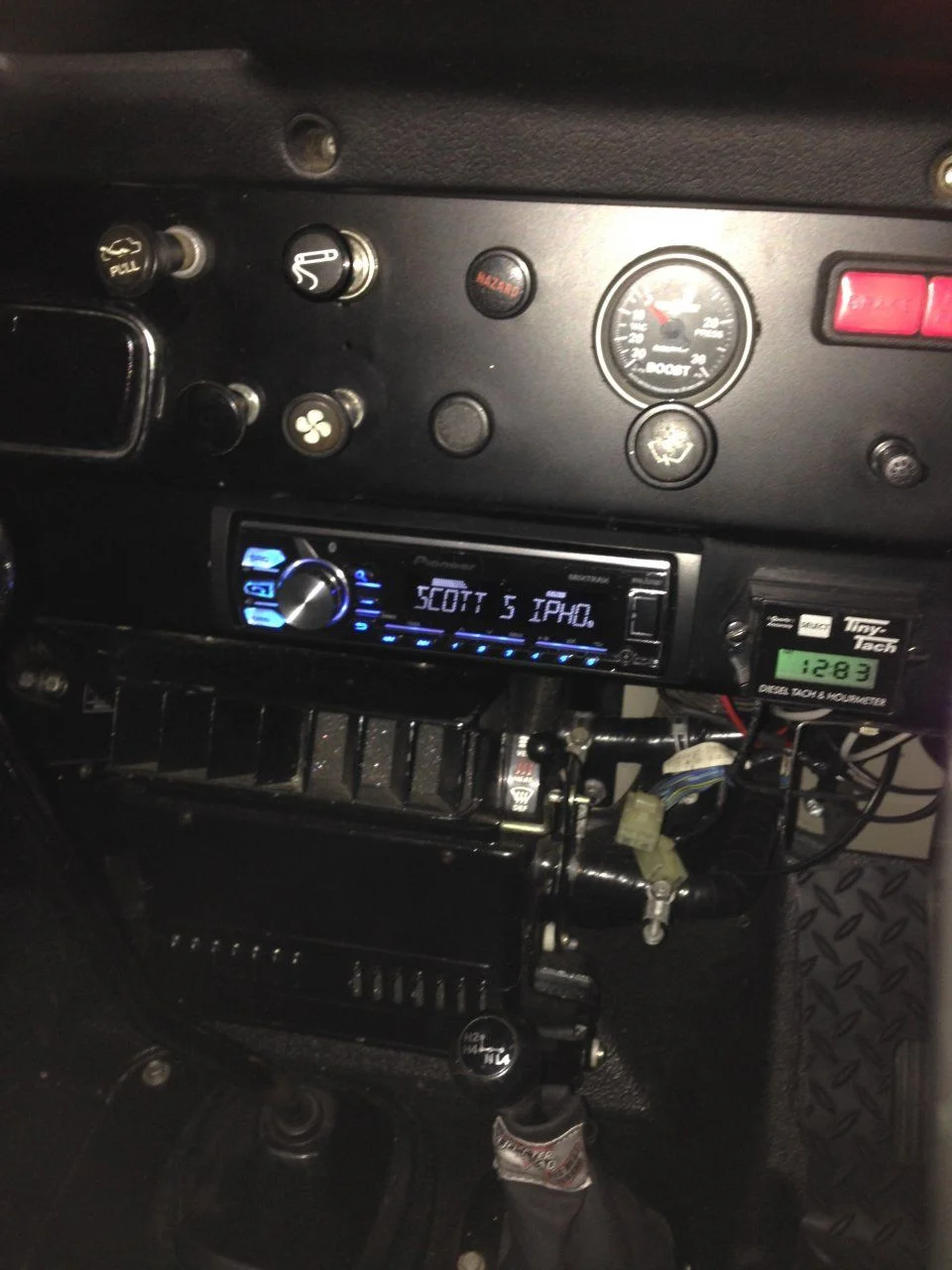

On a more positive note, I got the stereo in and it plays well. It has good volume which is good since the 2H can make some noise with the open exhaust. I'm driving it to work tomorrow for the first time in over 4 years; a big milestone!
That will be a great feeling, mate!
Nothing better than finally driving something that has taken the skin off knuckle's and bulk cash out of wallets!
My tip is you'll enjoy the drive (even if minor) immensely.

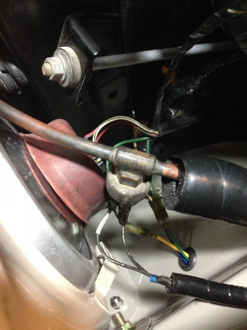

Is the pressure switch we're talking about the inline switch that is on the refrigerant line? It has a 2 wire connection (both black).
Is the pressure switch we're talking about the inline switch that is on the refrigerant line? It has a 2 wire connection (both black)....
Yes, don't know if it is high or low, the other one is likely mounted on/next to the dryer.
Hi Scott.
The "low pressure cut-out switch" is in the suction line which is
  • the only line that gets cold during operation (and this line is often covered in insulation as we see in your photo although sometimes people also insulate the "liquid line" in the engine bay too)
  • the line that's most often larger in diameter than any of the other refrigerant lines in the engine bay (and NEVER smaller ... unless an idiot installed your AC)
  • one of two lines that connect directly to the compressor
I doubt you have a high pressure cut out switch .... so hopefully the above information enables you to confirm this switch in your picture is indeed your "low pressure cut-out switch". (And that would mean, in my view, that it is the switch that is mislabelled at "oil switch" in Rudi's diagram.)
:beer:
