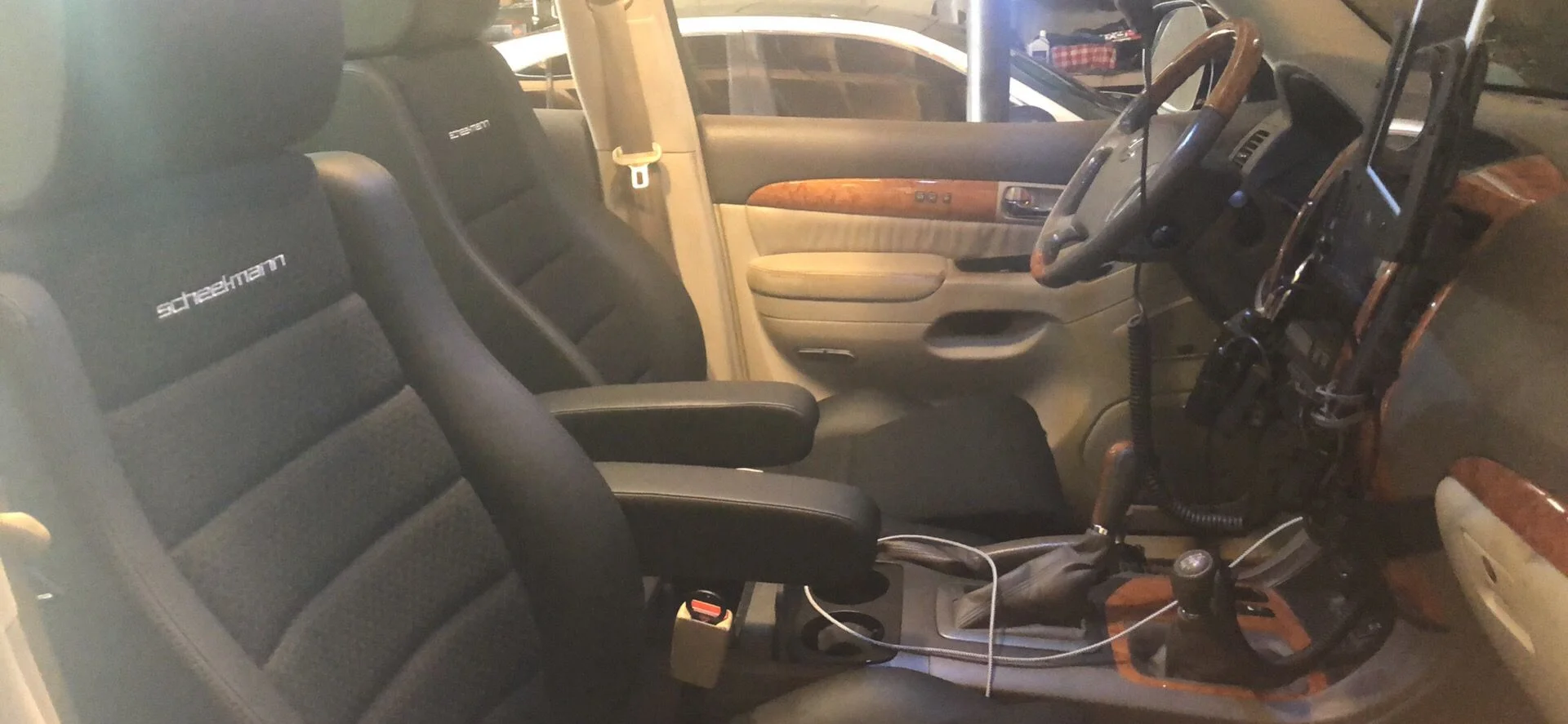

Dan/Vlad is rather tall and he seems happy with the ScheelMann seat he got.....maybe an entire replacement is in order.

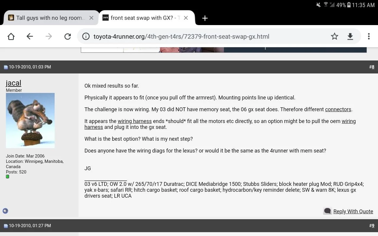

I re-found the conversation over at the 4runner forum. Someone swapped in a GX seat and stated it was a direct bolt in. If the GX seat is a direct fit, and the seat extender fits a 4runner, it only makes sense the seat extender fits the GX...

I re-found the conversation over at the 4runner forum. Someone swapped in a GX seat and stated it was a direct bolt in. If the GX seat is a direct fit, and the seat extender fits a 4runner, it only makes sense the seat extender fits the GX...View attachment 2112650
those are my thoughts... and furthermore, the seat extenders are returnable if they don't fit, so i'll probably end up taking the plunge and seeing what happens.

Prado WILL fit the GX on the floor no problem. The seat though? 🤷‍♂️. I did the SM and they are amazing. The thigh support alone!

SM look good though...

dan, i ordered rail extenders, but i do agree that the gx seats kind of suck for tall guys (they seem to be about 33% too small).
those SM seats do look pretty fantastic. which model are those, and what options did you spec? i was fiddling around on their site before, and they get pricey, quickly.
