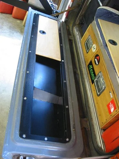

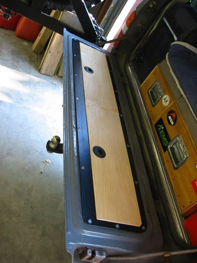

All that wasted space inside my rusty ol’ tailgate was bothering me so I wasted my Sunday and made this.
Thought I would post it ‘cause I’ve never seen one before.
Now I know that the reason I’ve never seen one is because it's kind of a waste of time, and you don’t gain that much space.
enjoy :cheers:

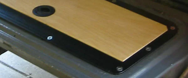

shoot that looks perfect to me. i've been needing a storage option for my extra bungees, compressor hose, zip ties, all kindsa random items but didn't want to commit to a large pull out system for the back. it still sturdy enough for a couple people to sit down on for camping/tailgaters etc?
and whats the black surround, i'm assuming metal but the fit looks almost to perfect to be made in your free time on a sunday.

What wood is that, Birch?

Since the main structure is made from angle iron it is still very strong, actually its stronger than OEM. I had the classic caved in tailgate and I used this to straighten it out.

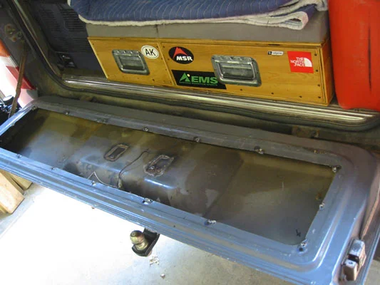

The main thing is to keep access to the internal door mechanism so whatever I put in there needed to be relatively easy to remove, that limited the size a bit. The box is 48” in length but only 3.25” at its deepest, and that is right up to the outside metal.

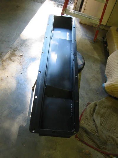

Here's a pic of just the box outside of the gate. Basically the rim is made out of angle iron, the top bit has a 2" leg to clear the latch mechanism and the rest is just a few pieces of 16ga. I cut the tailgate out with a jig saw and welded on some 1/4-20 nuts to bolt the whole thing on. Oh, and some 1/4x1/4 rod makes the lip for the lid to rest on.

I would not suggest cutting a hole in the tailgate without planning to reenforce it a lot.
Once the center bit is cut out there is pretty much no strength to the tailgate anymore.
