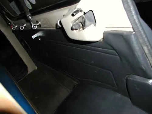

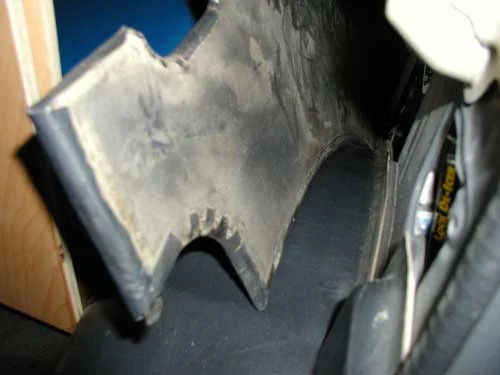

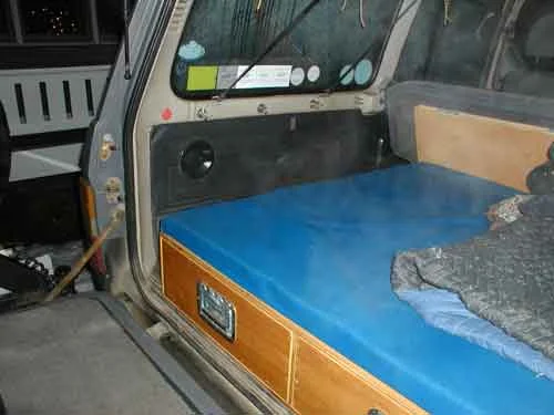

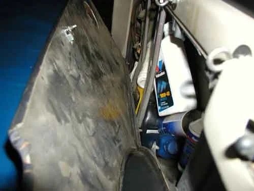

Ok it is only a bit below freezing and my dog is all warmed up from his idea of wrenching, so I took some pictures.
Everything looks dirty cause of the flash, in the light everything is neat and clean :grinpimp:
First, my dog wrenching, then the crapy pics.

Umm, they're called bungee cords, they're good for holding stuff :D
Actually, yeah, those are the best thing I've done to the cargo area, no more stuff sliding around.
You can see some stuff strapped to the side in this pic
