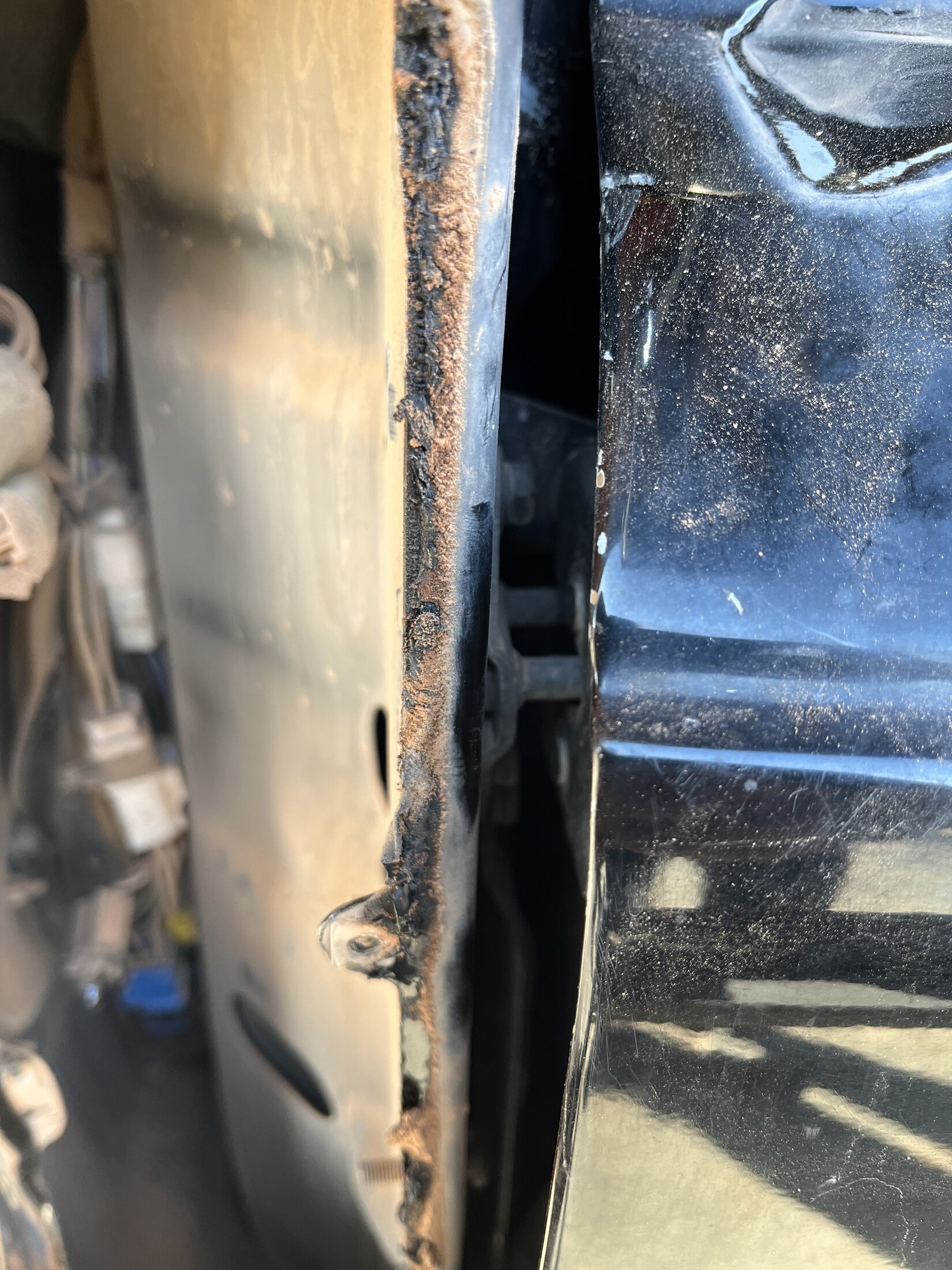

Doesn’t seem like unbolting the hinges will help either.

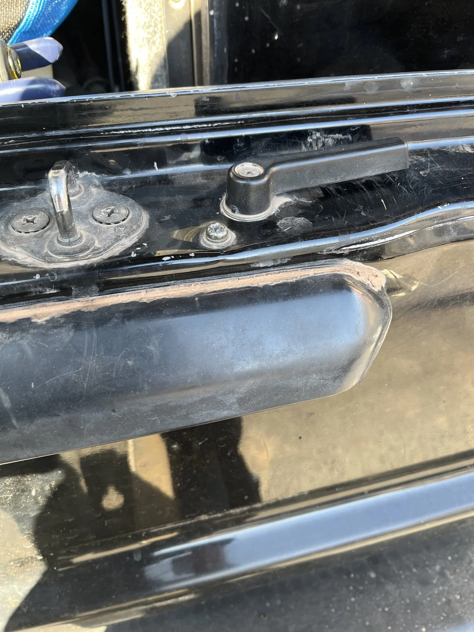

So I removed the 2 screws on the tail gate handle to get some extra travel and no dice.

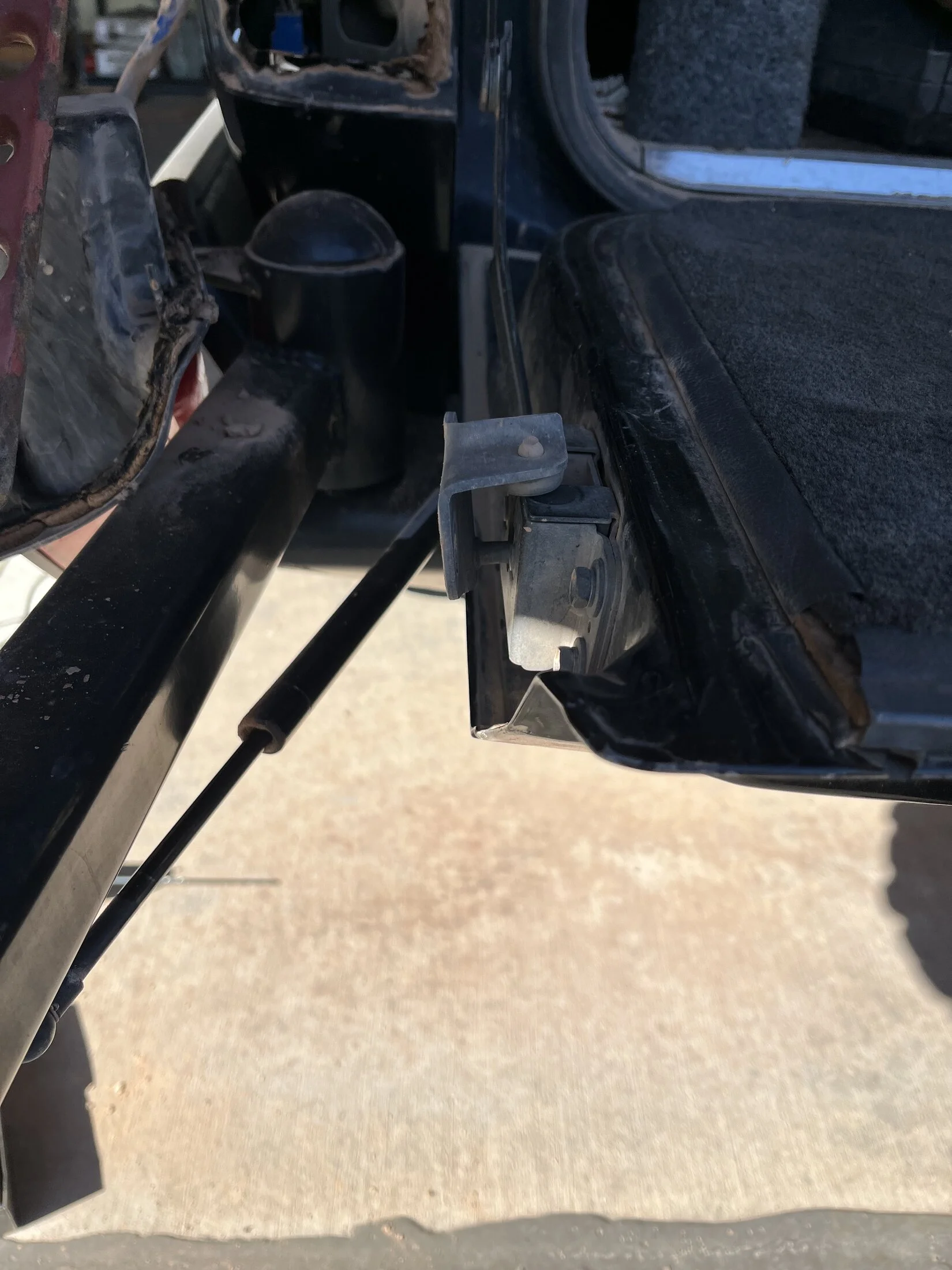

So next I removed the tail light ( broke the lower Philips screw tab a little 😕). Now I have access to the back the the door post bolts.

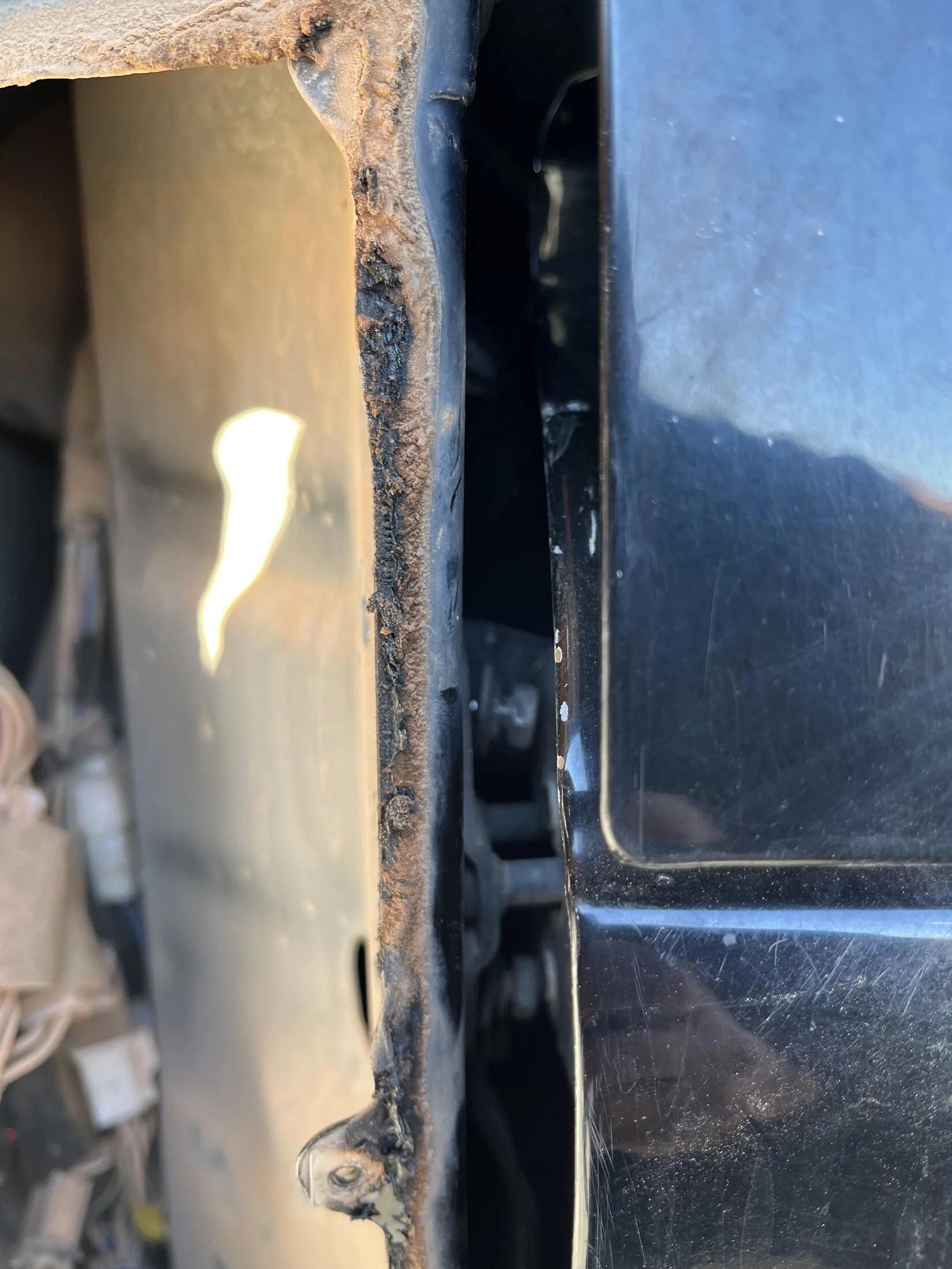

I might be able to slide a wrench between the tail gate and the body to crack the 2 bolts loose that hold the door post on. Then drill them out and hopefully they unthread. This is the side of the tail gate that would not unlatch..
Hopefully the is enough travel for these bolts to thread out all of the way.

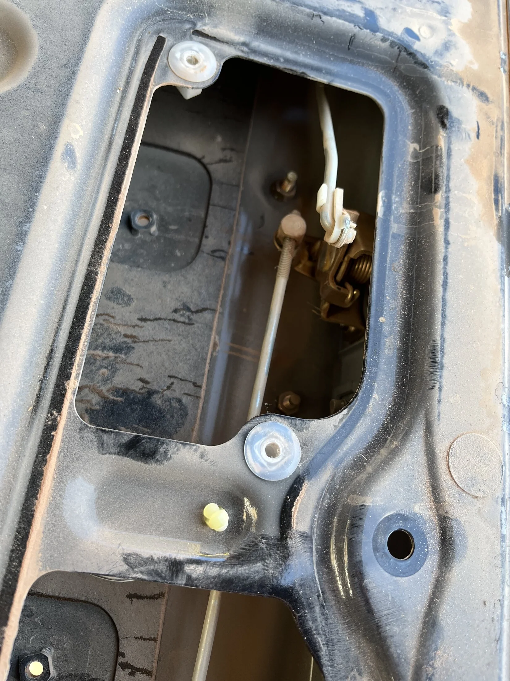

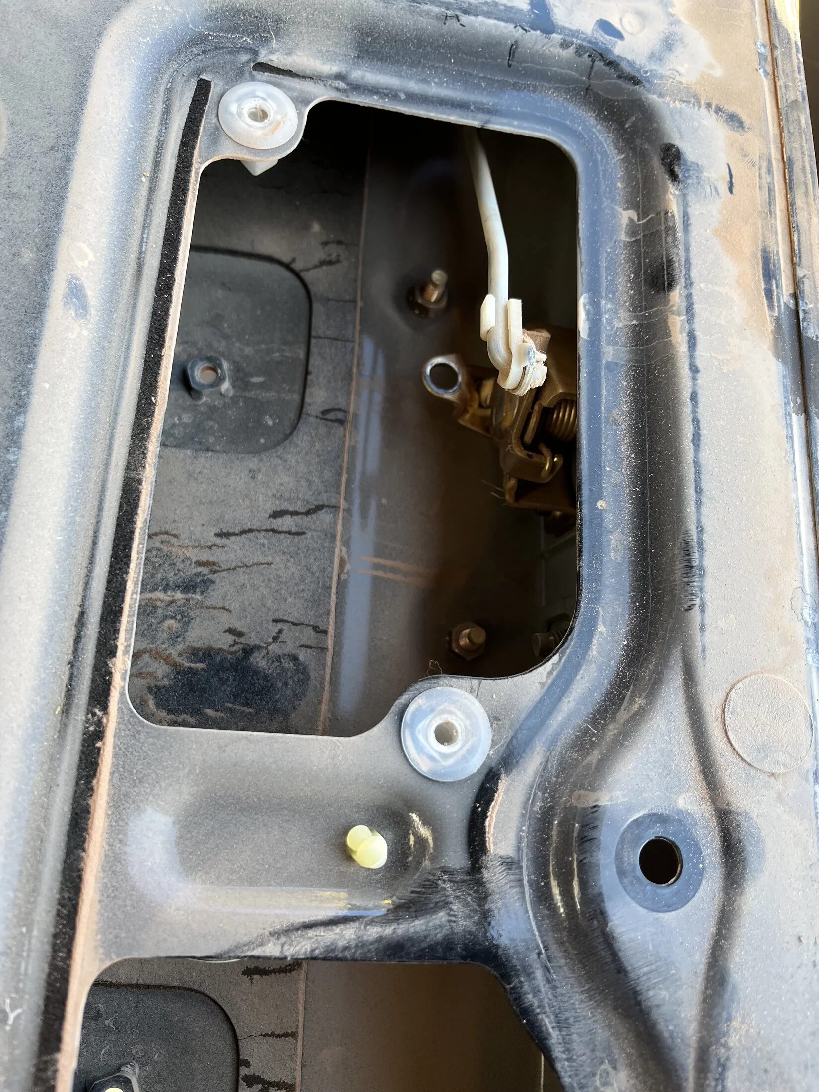

The platform has been in there for 8 years. I was able to sneak a 10 mil wrench in and loosen up the the latch post bolts and open the tail gate. The plastic keeper on the rod end that hooks up to the lever was deteriorated and the rod fell out.
I will have to go to the hardware store and get some hardware to reattach the rod end.
