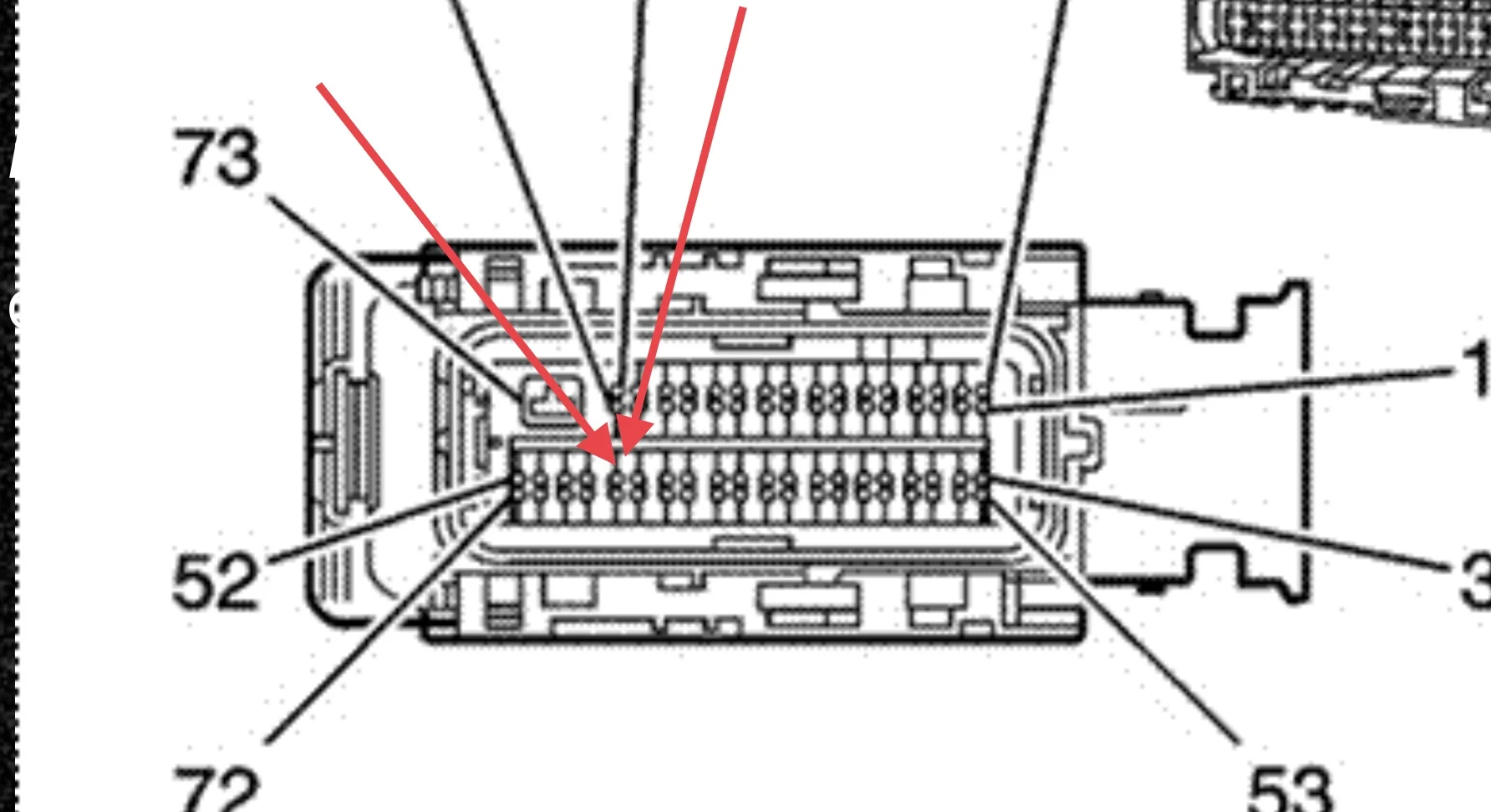

Does your ECU have the tach signal wire or not?
Should be Pin 48 on the X1 connector.
The tach signal from the ECU can be manipulated in HP Tuners.

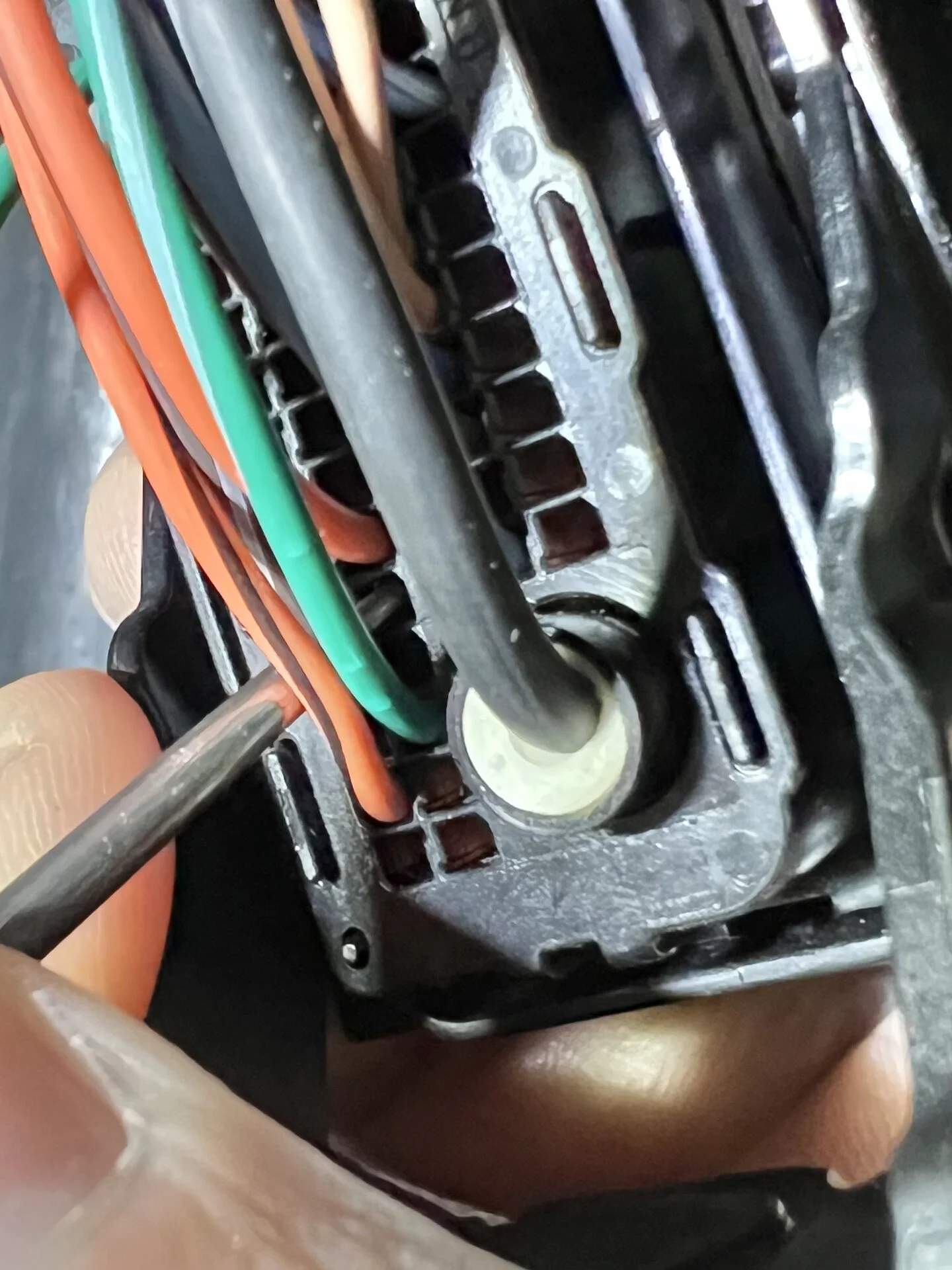

Just pulled J1 and the tach slot is empty
well, there you go
If I pinned this straight to signal wire. You’d mentioned tweaking the ecu to read proper. What were you referring to? (Meaning within the tune)
you could attach that wire to a tachometer or a signal box like your Dakota Digital module but you won't get anything if it isn't enabled in the tune file options

Reading back through this to follow up for anyone in the future. Matt you were correct. I dug into the LT1Swap website when it was LS1Swap (guess from memory) and the flashed stock ECUs like you said the signal on X1 pin 48 wasn’t there. I stopped at the tuners and he didn’t believe me. He connected and looked up and said huh go try that. That fixed my signal to the Dakota.
