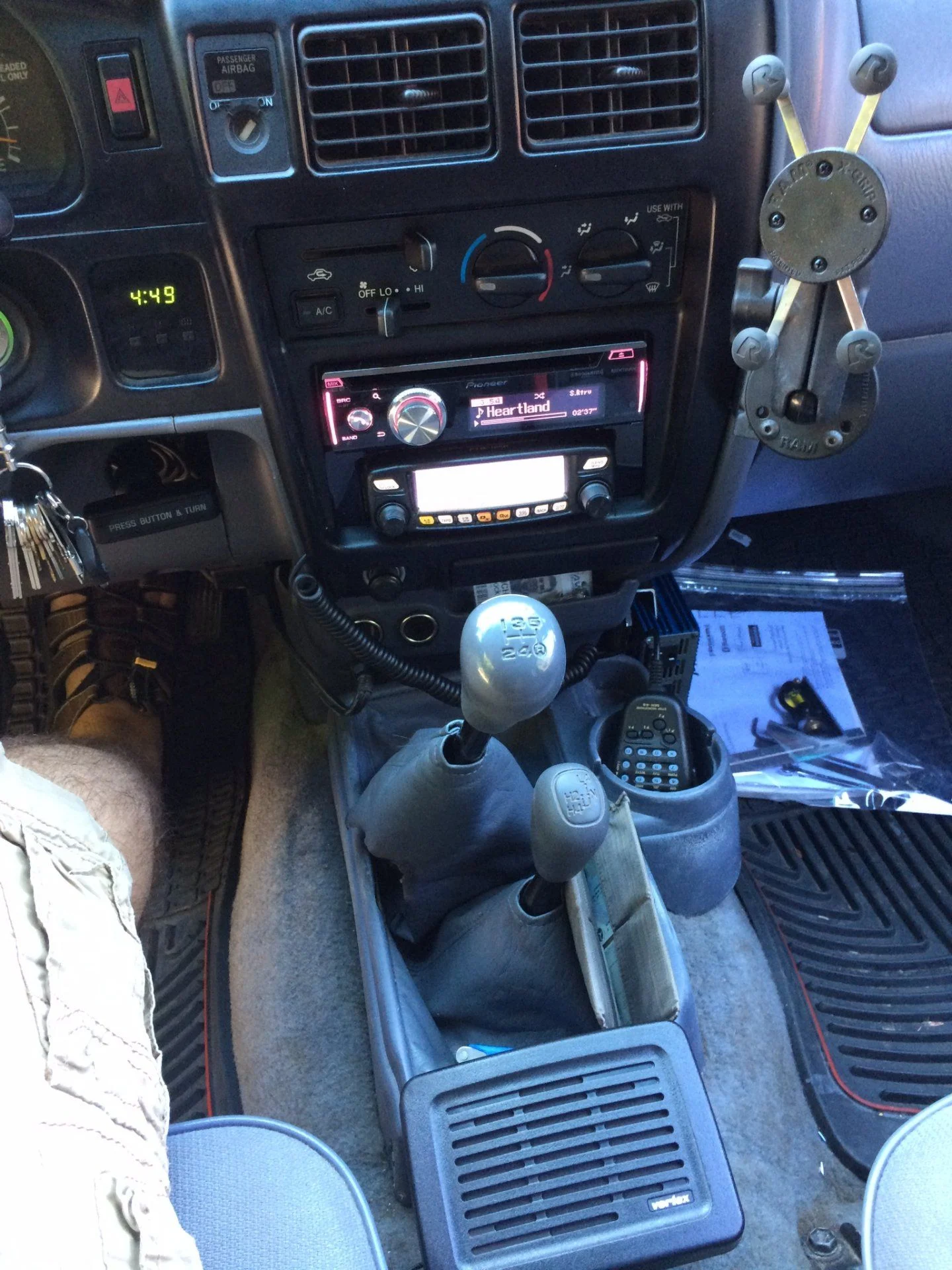

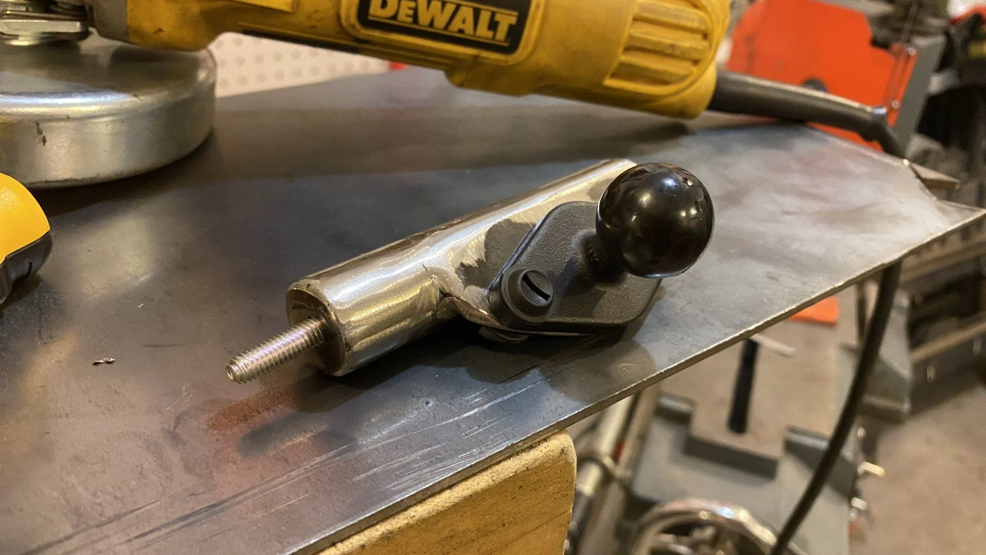

In my Taco I ran a bracket made by Panavise that bolted to existing radio mount bolts. The trim gaps were large enough that the bracket fit. I installed a ball and a IPad tablet mount that worked well. Pictured is just the X grip. This is what I ran for non trail use.

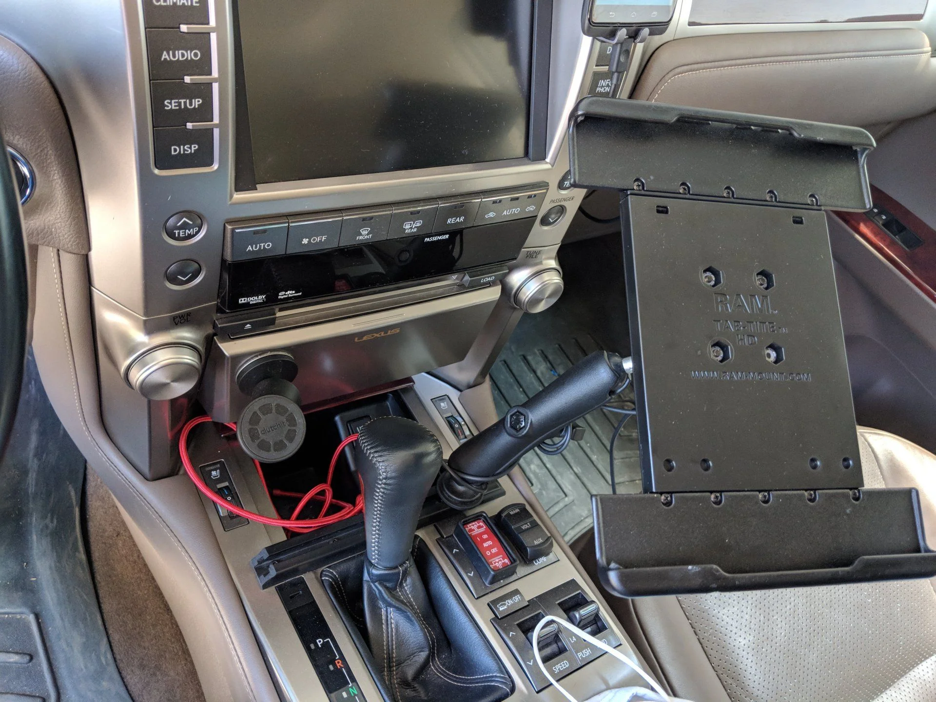

The Stubble solution (console side mount ram ball - picture in post #32) : Phone/Tablet mounts - ClubLexus - Lexus Forum Discussion

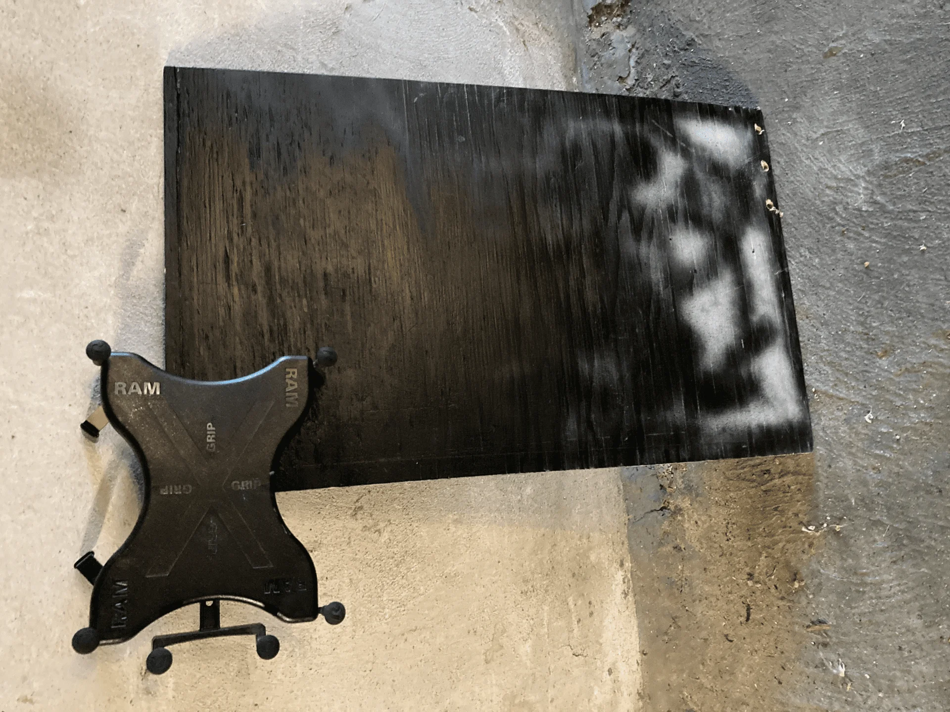

I'll have to share a picture of my "make do" chunk of plywood with RAM tablet mount from last week's trip.... it should cause a few chuckles, and I didn't quite match the stain of the wood trim (amongst other challenges with this inelegant approach)

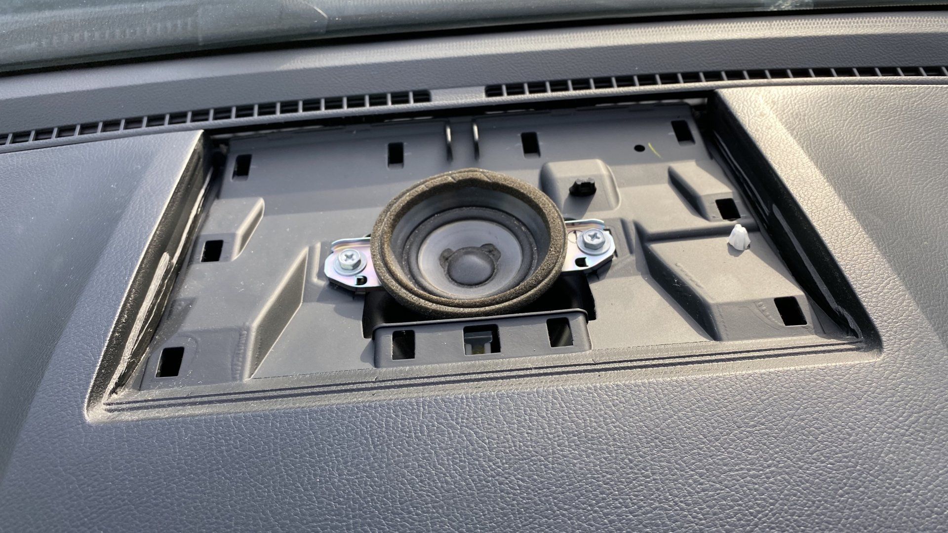

One thought I’ve had was to remove the center speaker and use the fasteners for the speaker as the basis of a solid bolted solution. Problem with that is your devices are still in your field of view.

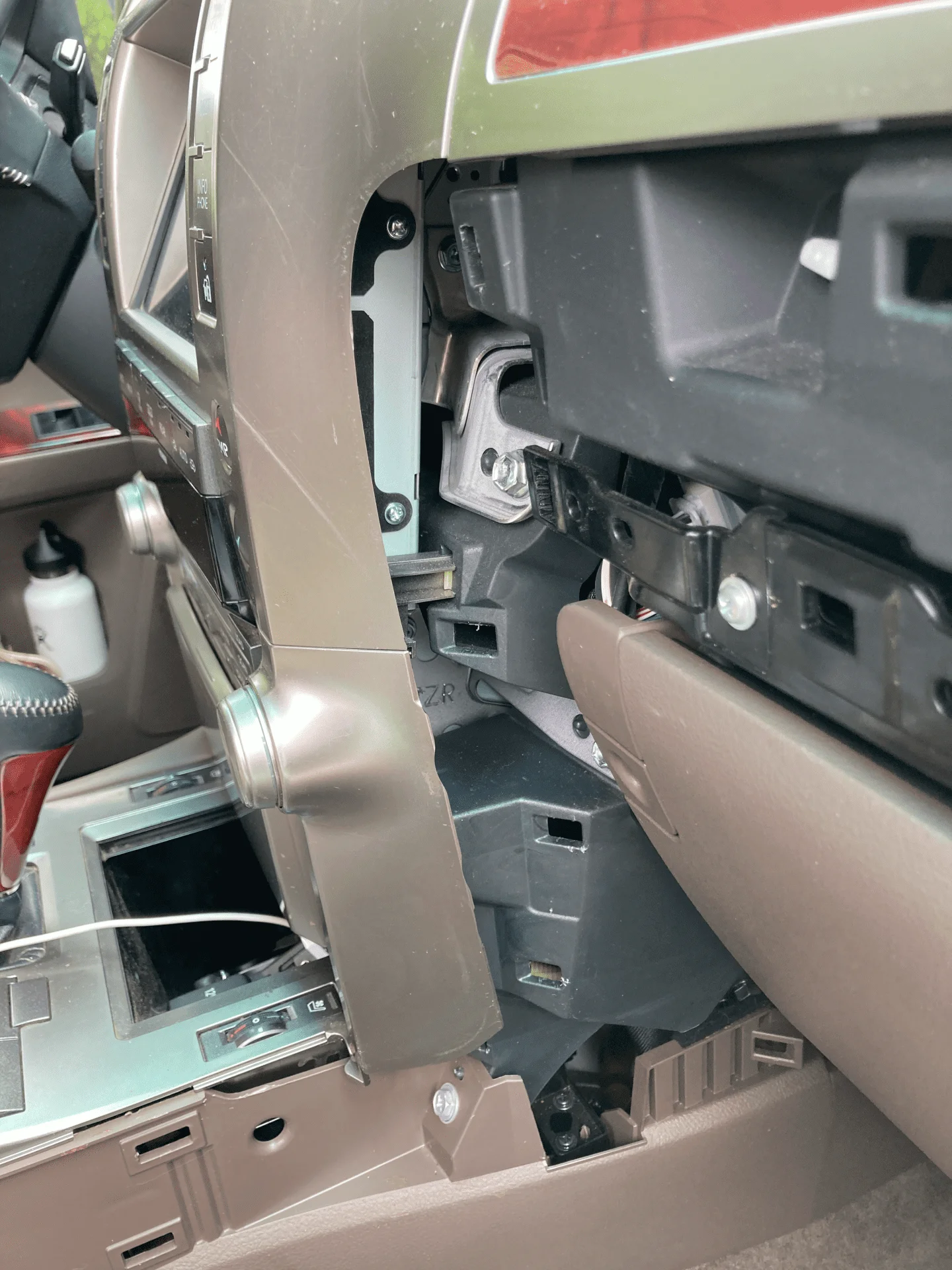

With trim panels removed, I think I can mount the base in this thicker plastic trim with some reinforcement (for a RAM diamond mount ball)

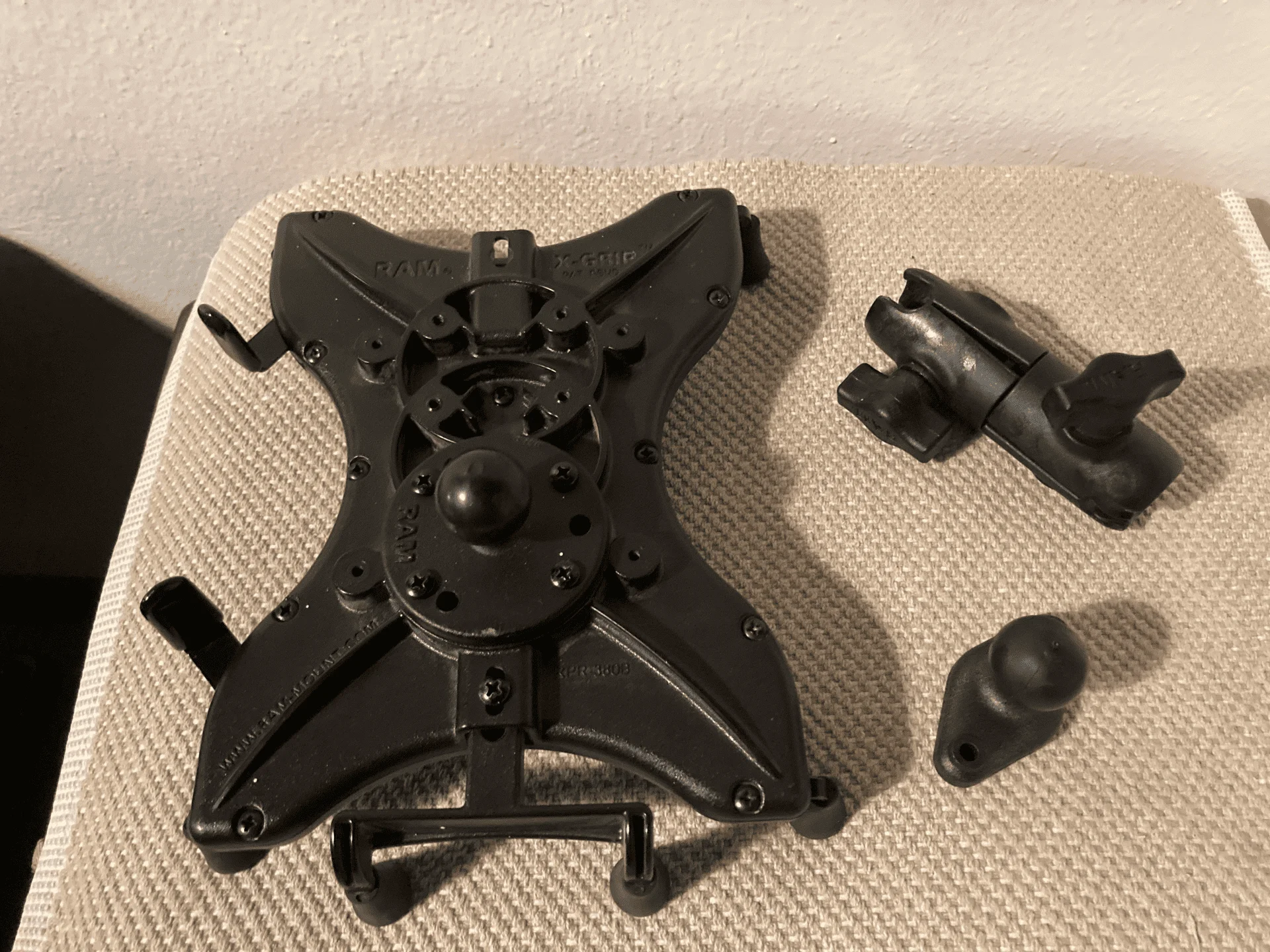

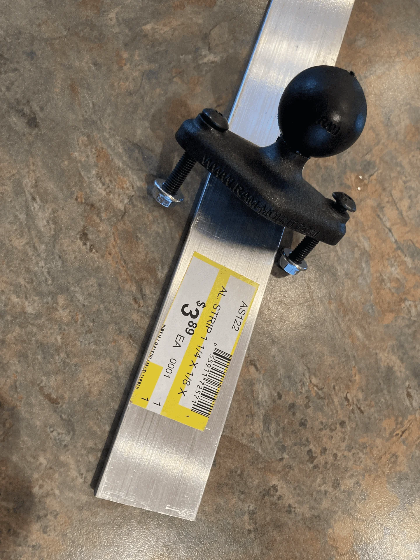

RAM X-Grip Assembly:
Three parts - X-grip, arm and composite diamond ball base:

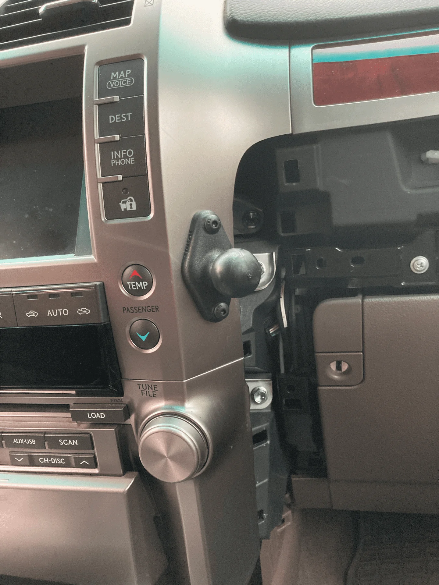

Composite Diamond Ball base with 5mm button head screws with flange head nut and aluminum bar

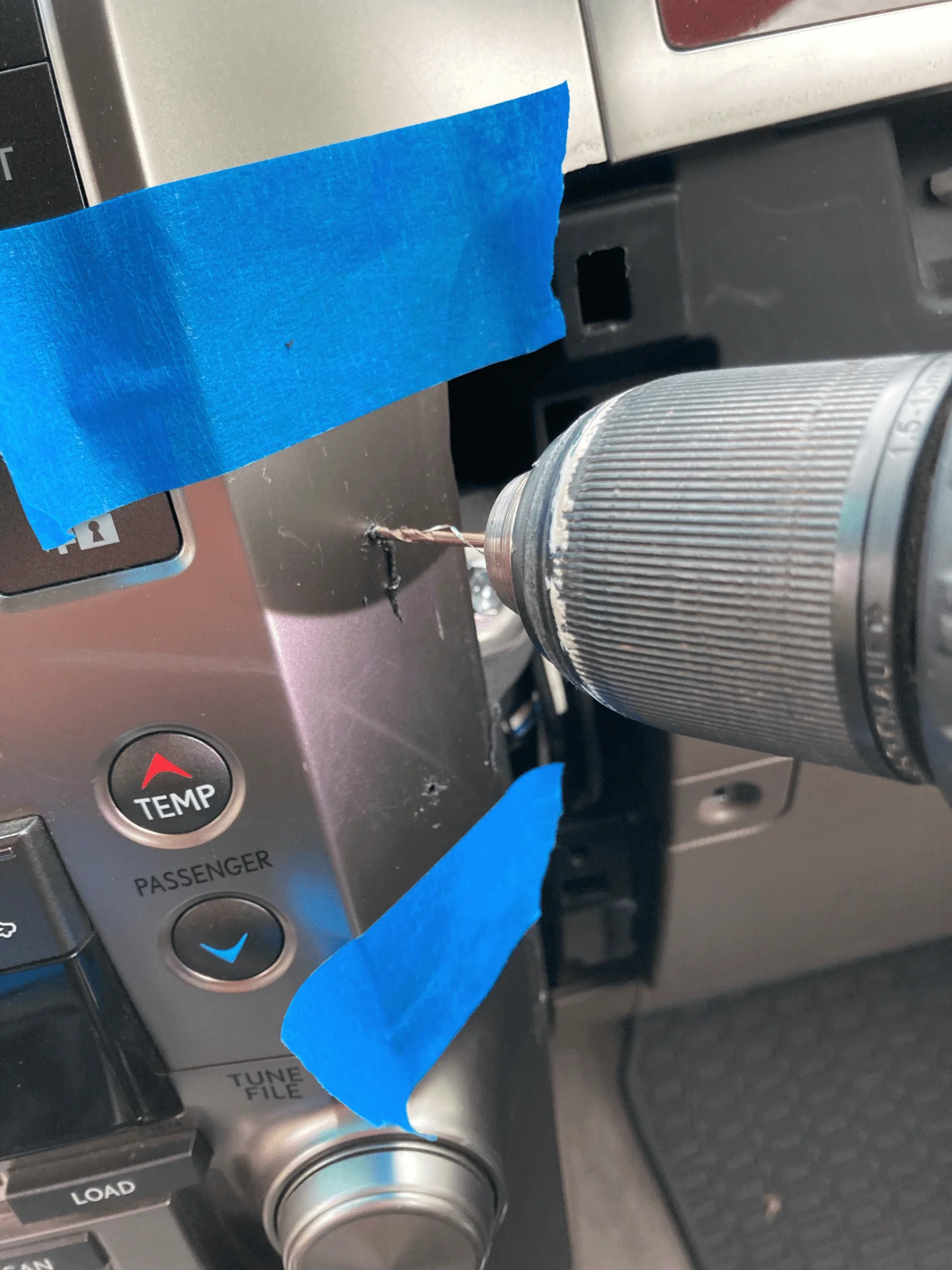

The exciting step is drilling into the dash... pilot holes first

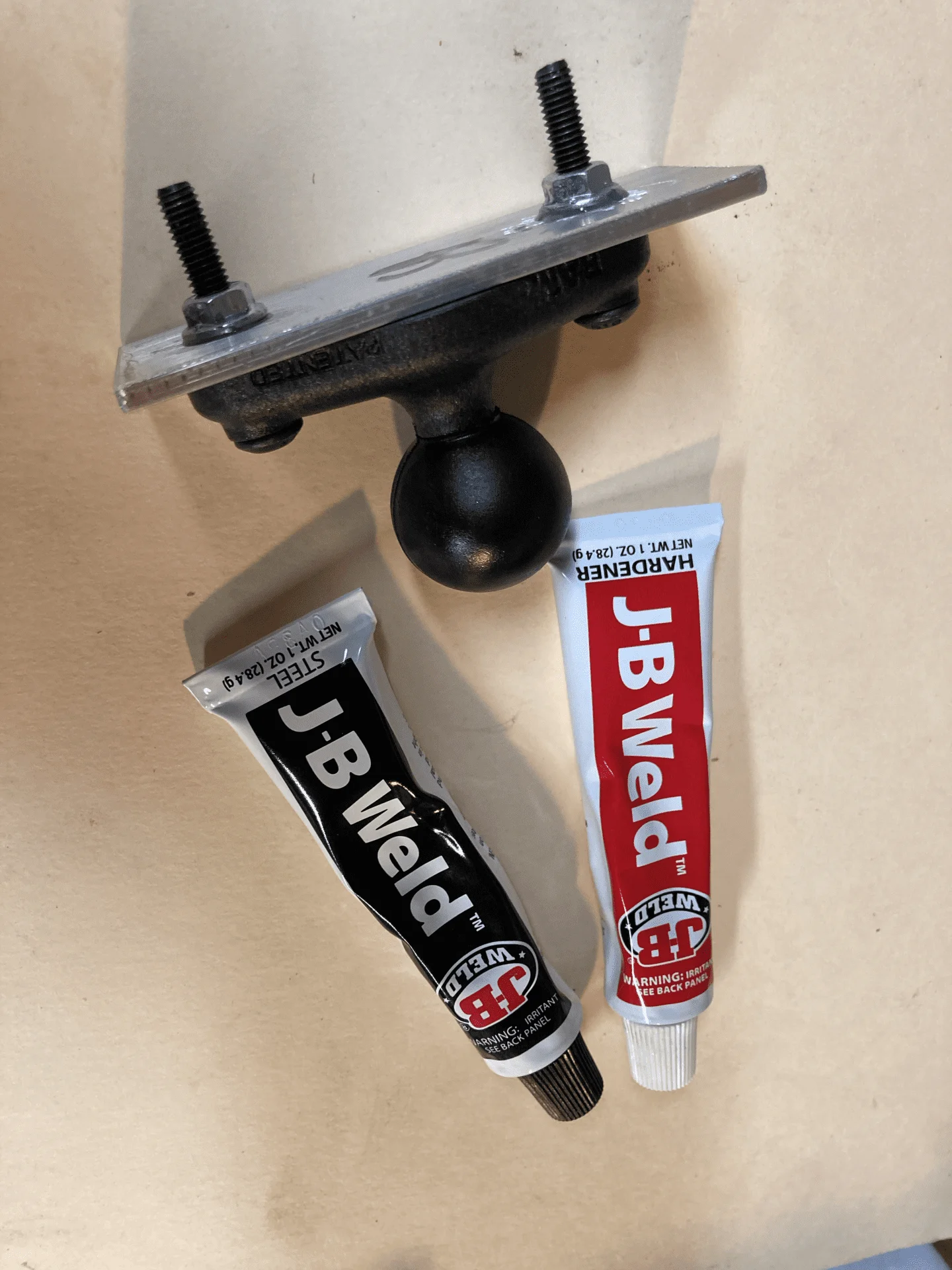

The backing elements with flange nuts mounted to aluminum bar backing with jb weld (diamond ball and screws acting as jib / clamp)
And diamond ball mounted to console as jb weld between aluminum bar assembly and console sets up.
So that's the progress today on this one banana job... I will test it around the neighborhood with tablet weight tomorrow to see how it performs and post the parts and my process if passes initial muster...
If it isn't immediately apparent, I jb welded those elements so I can remove the ball base and just have the two black button heads showing when I'm not running a tablet. My goal was functional tablet mount near line of sight for navigation, but without year-round black ball projecting out...
Sorry it this approach seems painfully obvious to others but there seemed little info on "how to gx 460 tablet mount"... Feedback on this approach welcome.
I like what you did here. I am excited to see if the aluminum backer will be enough to support the added stress over time. JB Welding the nuts on the back was a great idea. Should I decide to mount a ram ball somewhere similar I will definitely consider using this method.
This is turning into a slo-mo project with other distractions....
JB Weld set up overnight, and I got some better screw lengths....

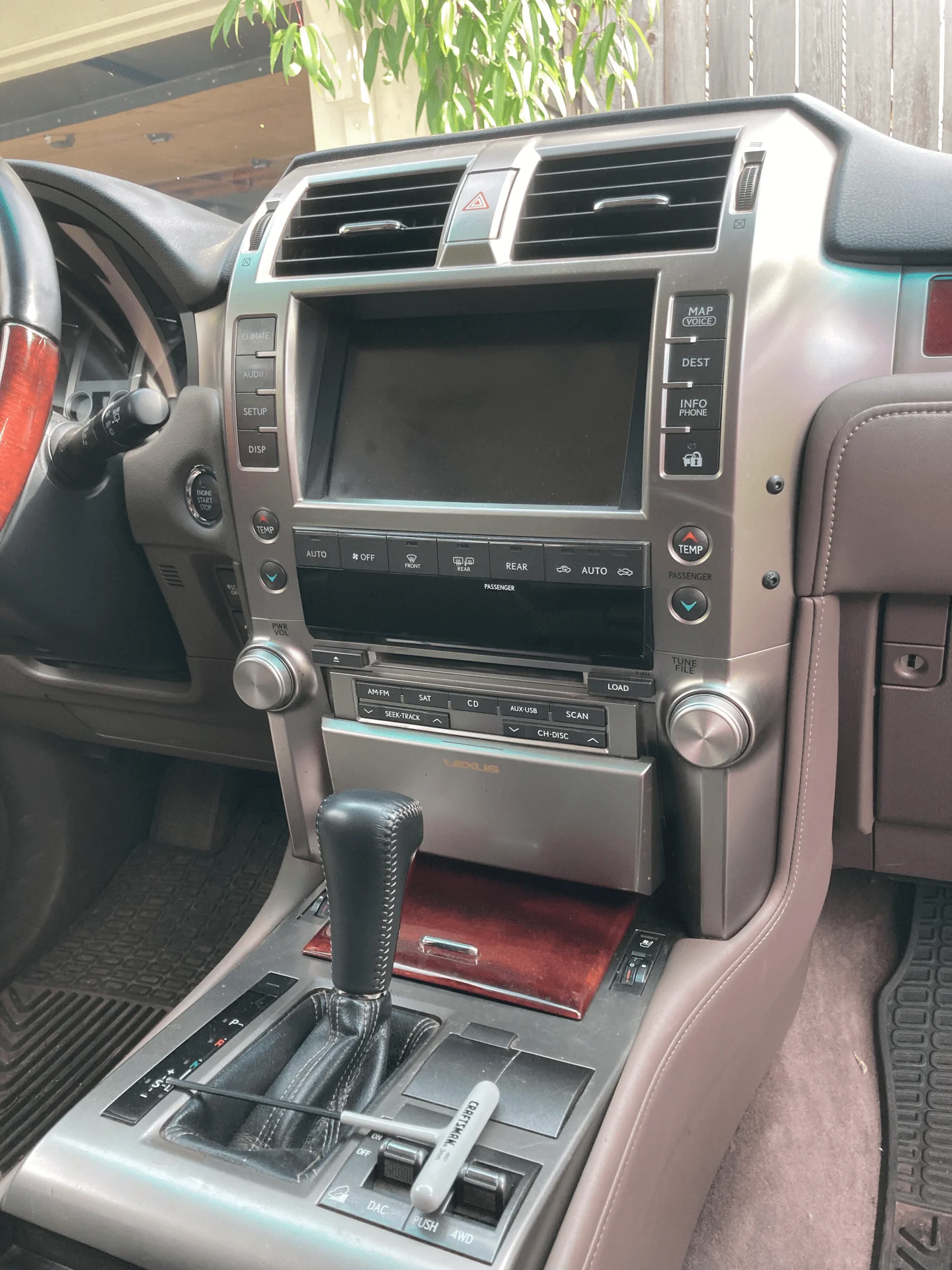

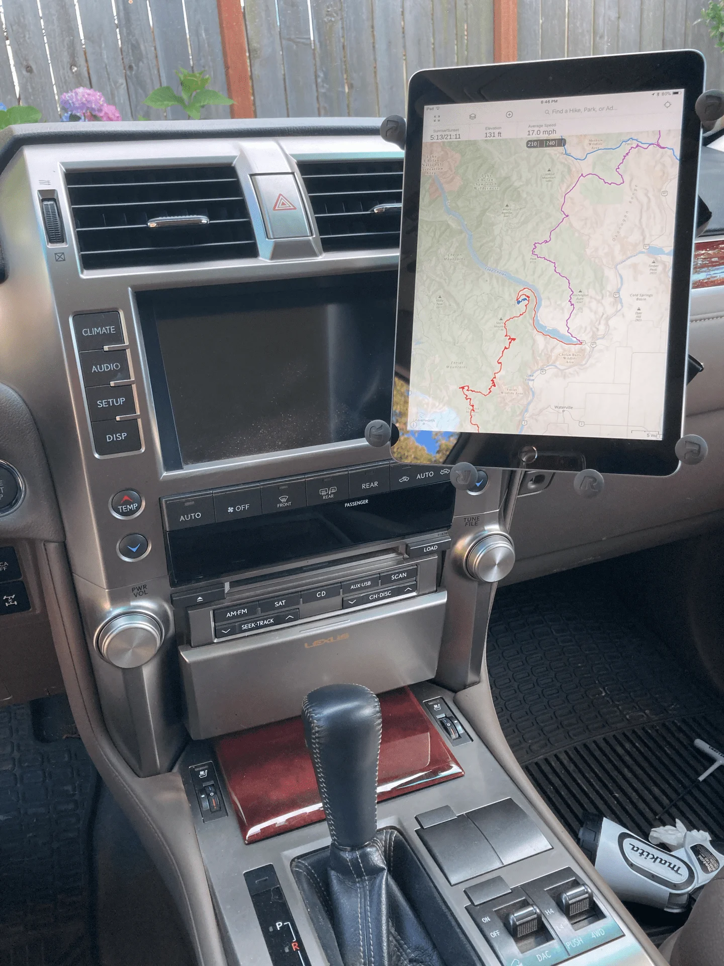

Here is the off-season look with two black button heads...

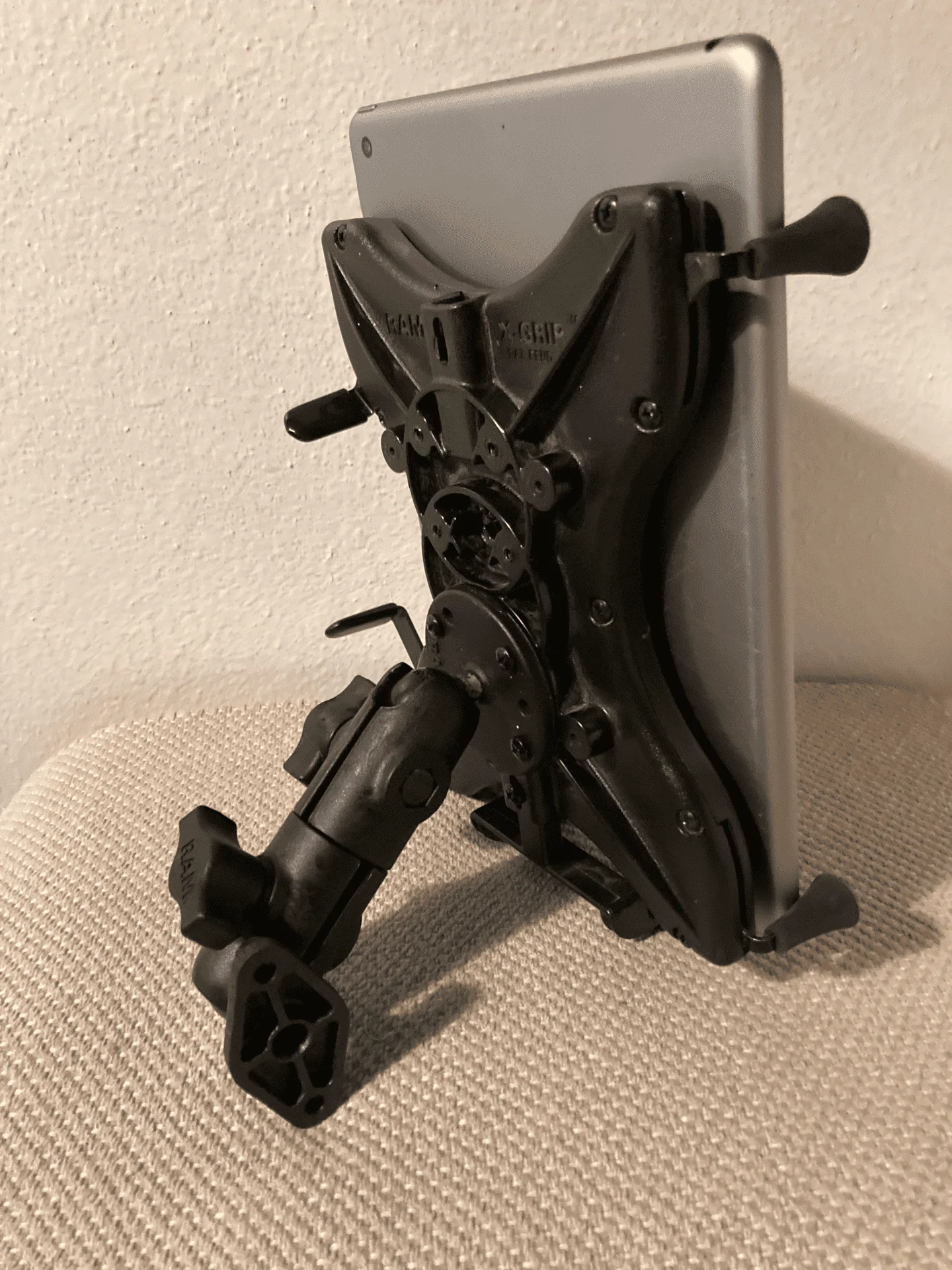

The RAM X-Grip set up without tablet :

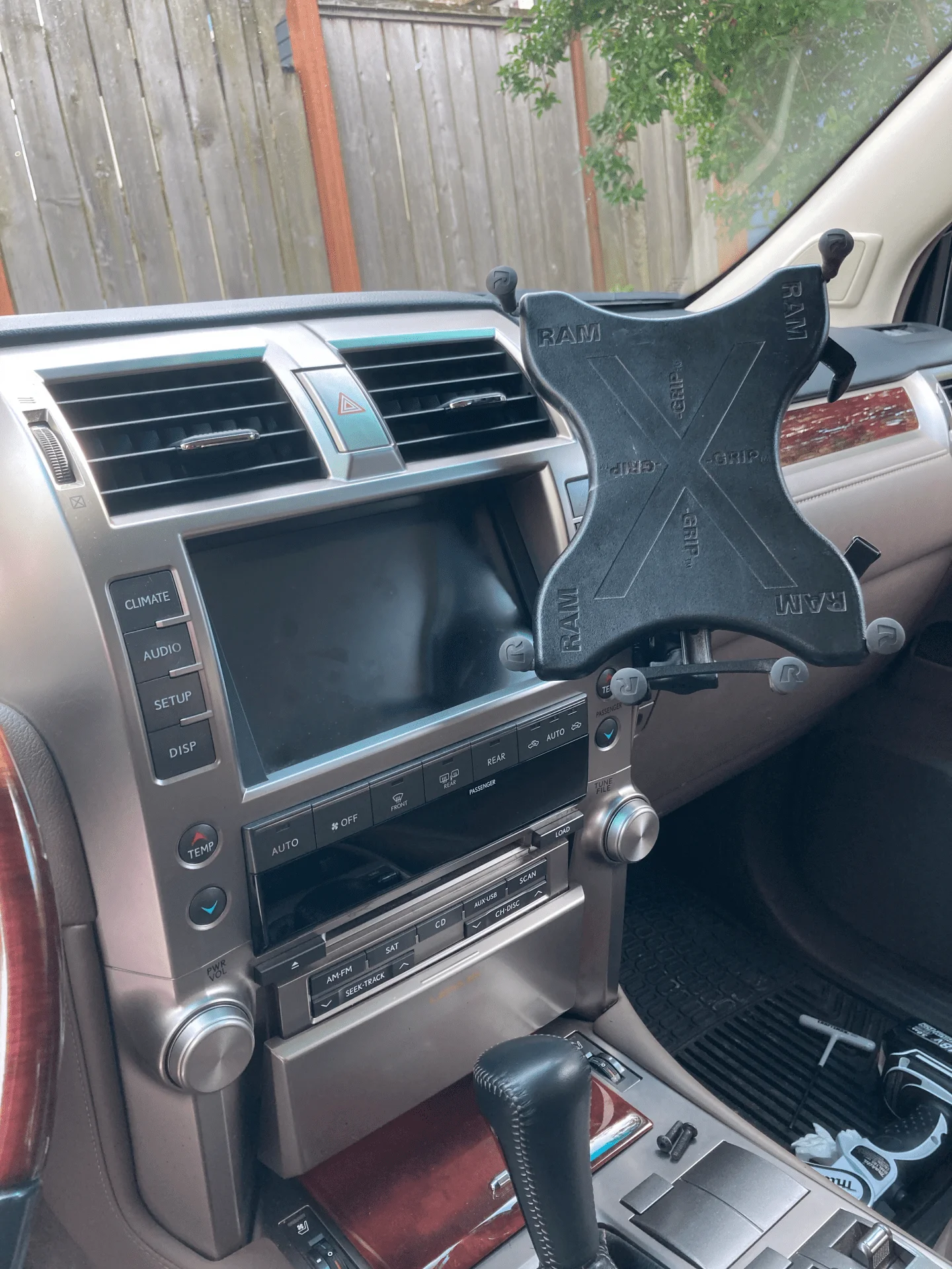

And this is the view with tablet (spaced to retain use of OE screen for climate and audio - I typically drive with the screen off / dark)
I still need to do a shake test with some backcountry travel...I'm also going to try a thin rubber layer under the diamond mount as a dampener.
Note that the diamond ball need to be mounted more forward (toward seats) to avoid conflict with trim.
