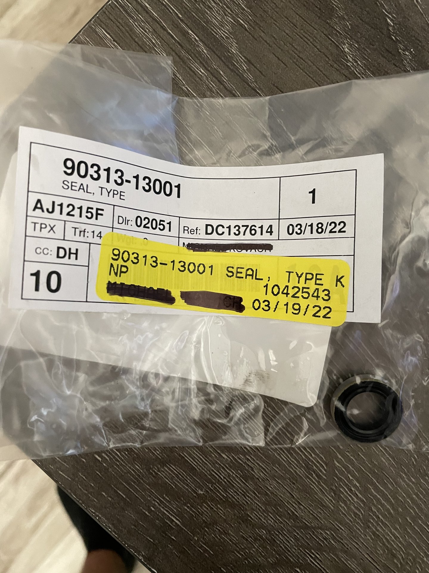

Anyone know of a source for the shifter seal that comes out of the top passenger side of the transfer case. It is Toyota part # 9031013001 and looks to fit 3 and 4 speed cases. NLA from Toyota.

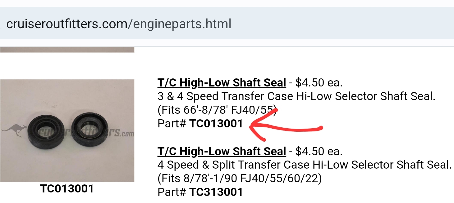

Check with Valley Hybrids or Cruiser Outfitters.
Yup, we stock them by the pound. NOK (same as OE), made in Japan.
I apologize for any confusion. The online parts catalog I order from occasionally has that as a seal from 8/78 to 1/80. My production date is 8/78. I took a chance and got lucky. It was match to what I removed and fit perfectly.
I also discovered (maybe common knowledge) this deal is the same for the inside of the vacuum 4wd shift shaft. So this same deal can be used on the transfer case for the hi/low selector shaft, vacuum 4wd shaft and on the 3 speed on column trans for both shift shafts.
