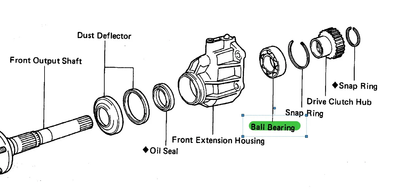

OK I've searched long and hard for the part number for the front output shaft radial bearing on the HF2A T-case. Ended up ordering the wrong one. Can someone please help me with this part number?
Replaced by 90363-40083 for others who are searching.
Also, it can be found on Amazon: Nachi 6208Z
Not the parts expert but IME it means the original bearing number was superceded (replaced) by a new number. That might mean the bearing design was changed or just that the bearing manufacturer changed from the original 30 years ago.
IMHO if the original bearing is still available from Toyota buy that bearing as they will be high quality.
Here's a link to Partsouq to a search for the original part number. Note that the original part number is not
available but the new part number is:
Here's another link for example:
