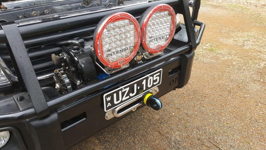

I put 150' of 7/16" Amsteel Blue on my 8274. I have the XP 6hp motor and +76mm drum, no problems, I almost always use a snatch block. I also carry a second 150' length of 7/16" for an extension when needed.

2016.08.16%20-%201040.04%20-%201877%20-%20Dyneema%20sppol%20onto%208274_zpskw6oktgz.jpg
