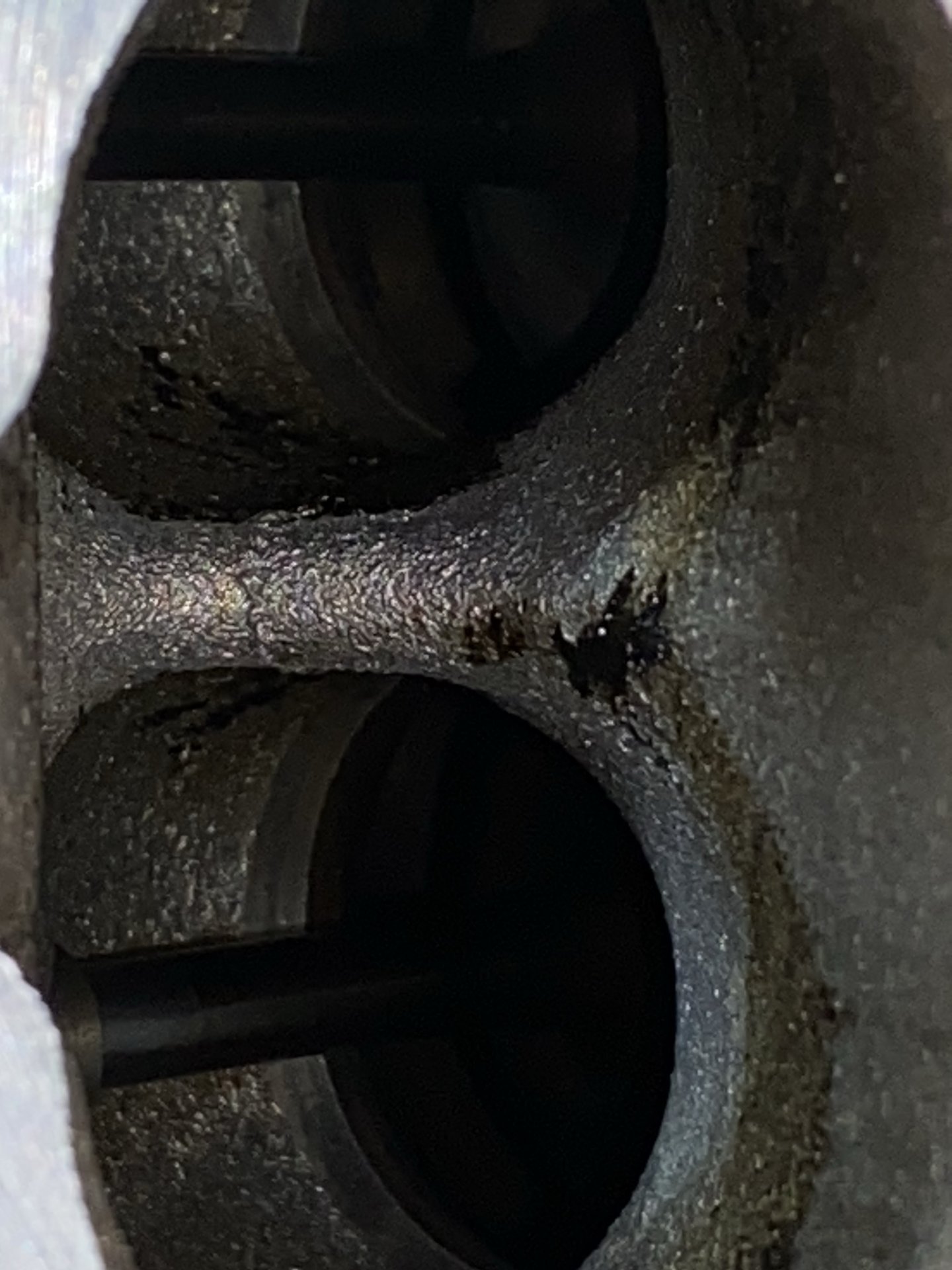

Very import to health of cylinder/compression. Clean top of engine spotless before pulling intake manifold. Stuff shop towels in each intake port, to keep out sand/dust. Vacuum out heads intake port before reassembly, getting ever spec of sand and dust. Replace all gaskets. Nice touch is to replace seals fuel inject seat in the intake manifold.
Tip: Run 44k (2 can full tank, with as many cool down cycles as practical) &, seaform fogger (1/3 can at a time hot engine, through PCV port on intake, and shut down engine. Letting cool 30 minutes to soak in and than high RPM HWY run), than Chevron techron, than Cataclean. You'll have very clean FI's, & intake ports, cylinder, valves, pistons, rings and CATs. Do High RPM runs for ~7 minutes during and after each treatment. Than BG EPR engine flush (2 cans) just before oil change.
I did not wipe out these intake ports. After above treatments they were clean. I sent out fuel injector to FIS. Chuck at FSI was shocked at how good spray pattern of every FI was, pre cleaning & rebuilding.
164K miles engine.
Shop vacuum hose, taper down with smaller hoses. I get up on engine a vacuum each port of every speck. If compression bad, it will not be my fault.
