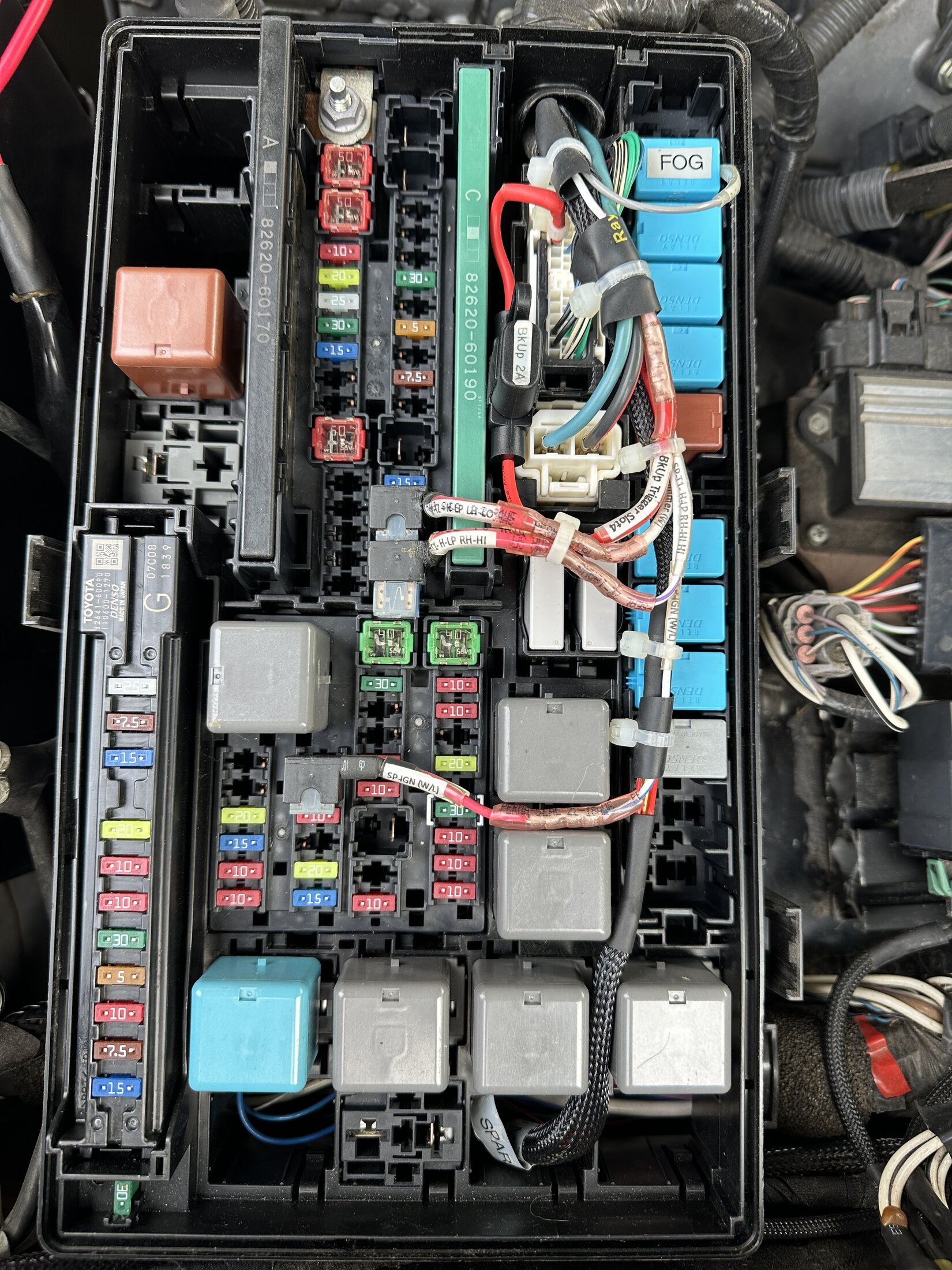

I'm using a 1/4" gland fitting to route wires into the fuse box. Working well in the location nearest to where I've mounted the Switchpros vertically on the inner fender behind this box.

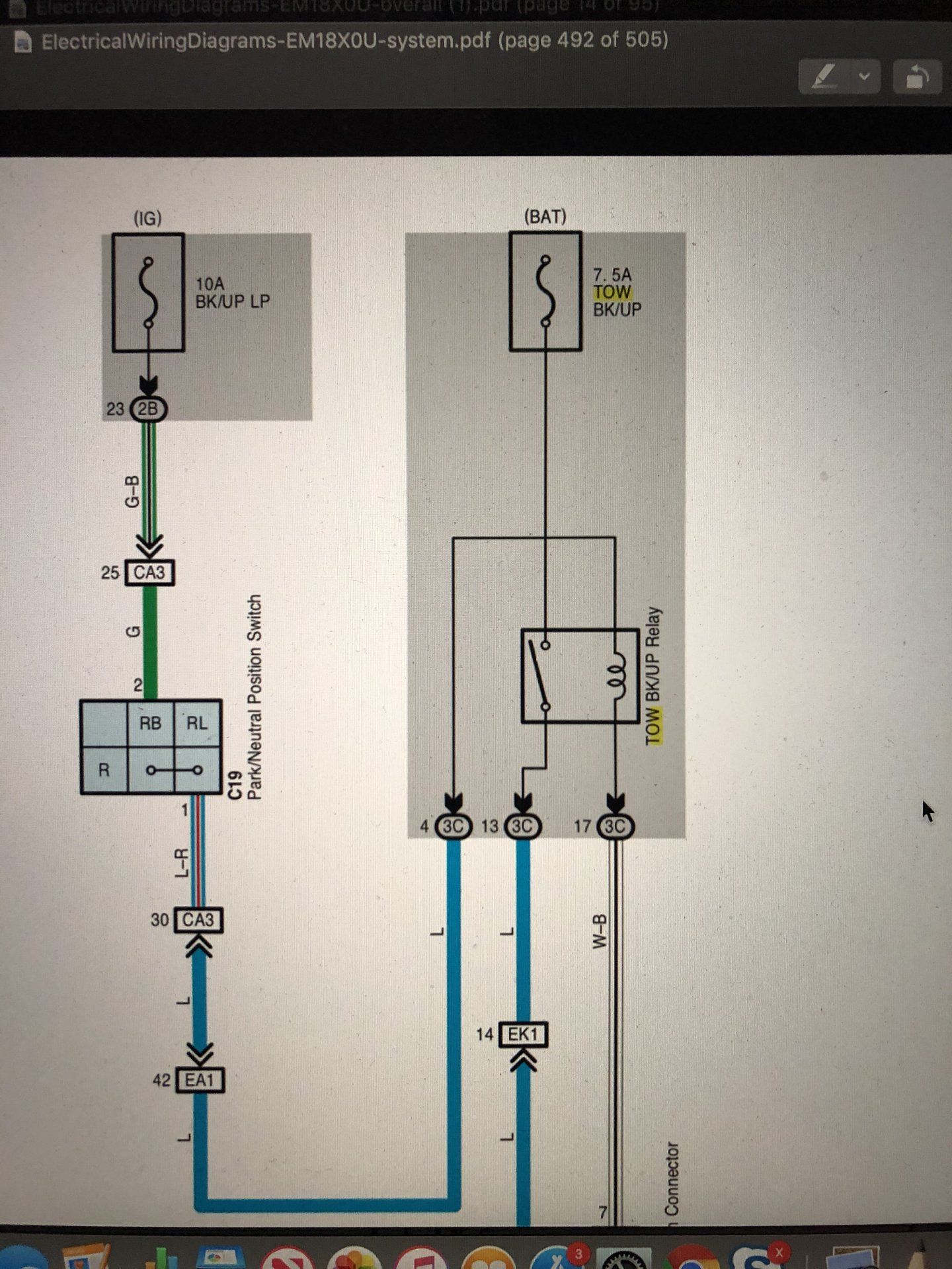

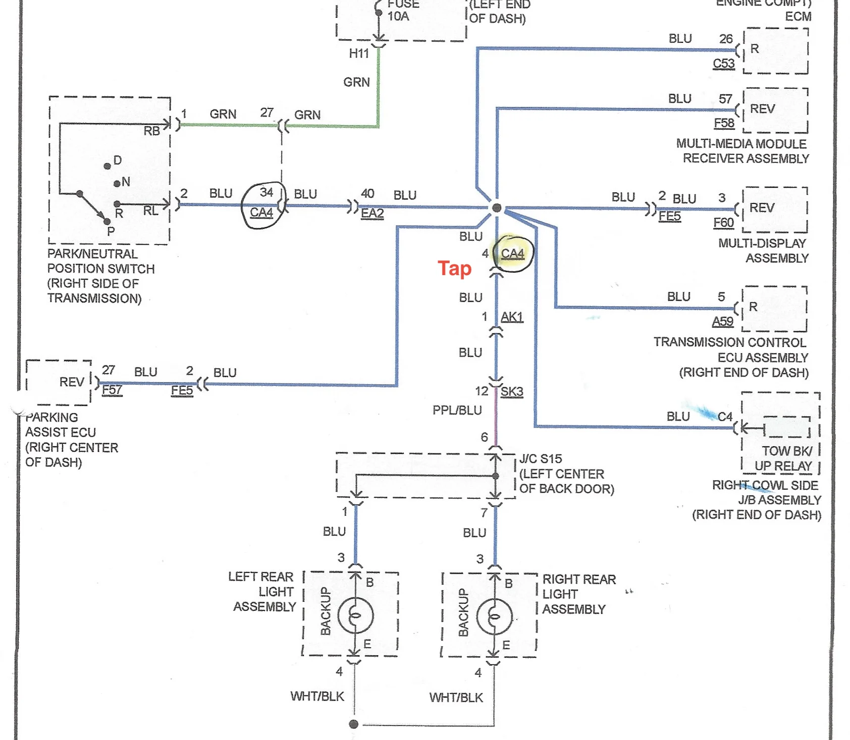

Sorry I’m not seeing where the reverse light trigger is picked up? Am I missing it on here somewhere?

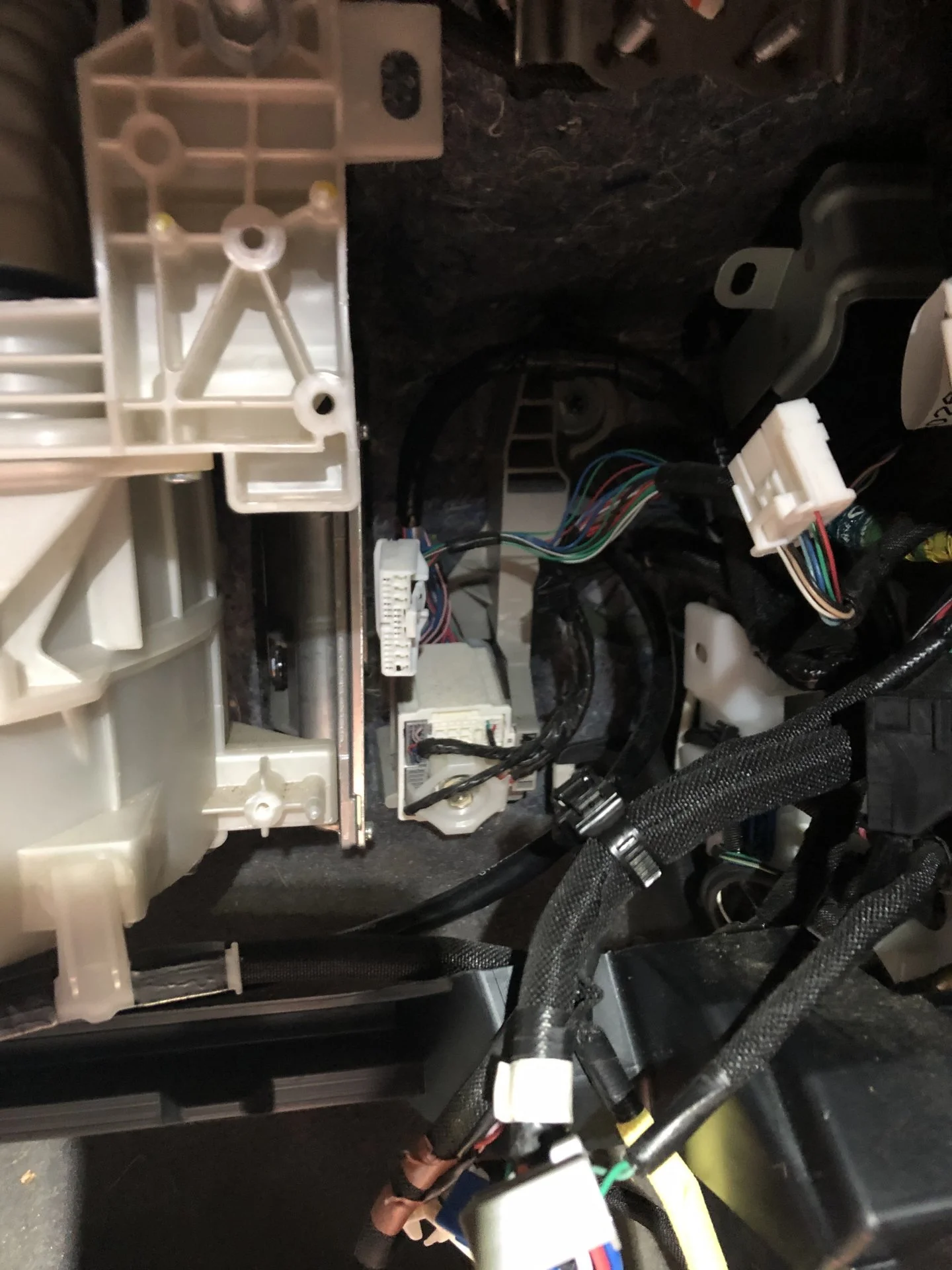

Not sure there is a convenient one if the underhood block. Here's one solution:

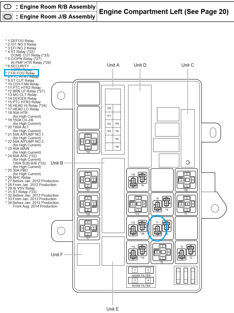

That's what I did for the fogs as I wanted to move control to within the Switchpros.
If just looking to tap for the signal, can probably pinch a wire on the relay or fuse. Or add a fuse. Depends on what you're looking to do.
Yep I feel like I’m being pranked, lol. I have looked through the post multiple times, I see you reference it in #1, but don’t see it anywhere else. #4 seems to have been deleted and looks like something may have been mentioned there.
It might be filtered out/blocked for whatever reason between you and others. I'll copy the content here:

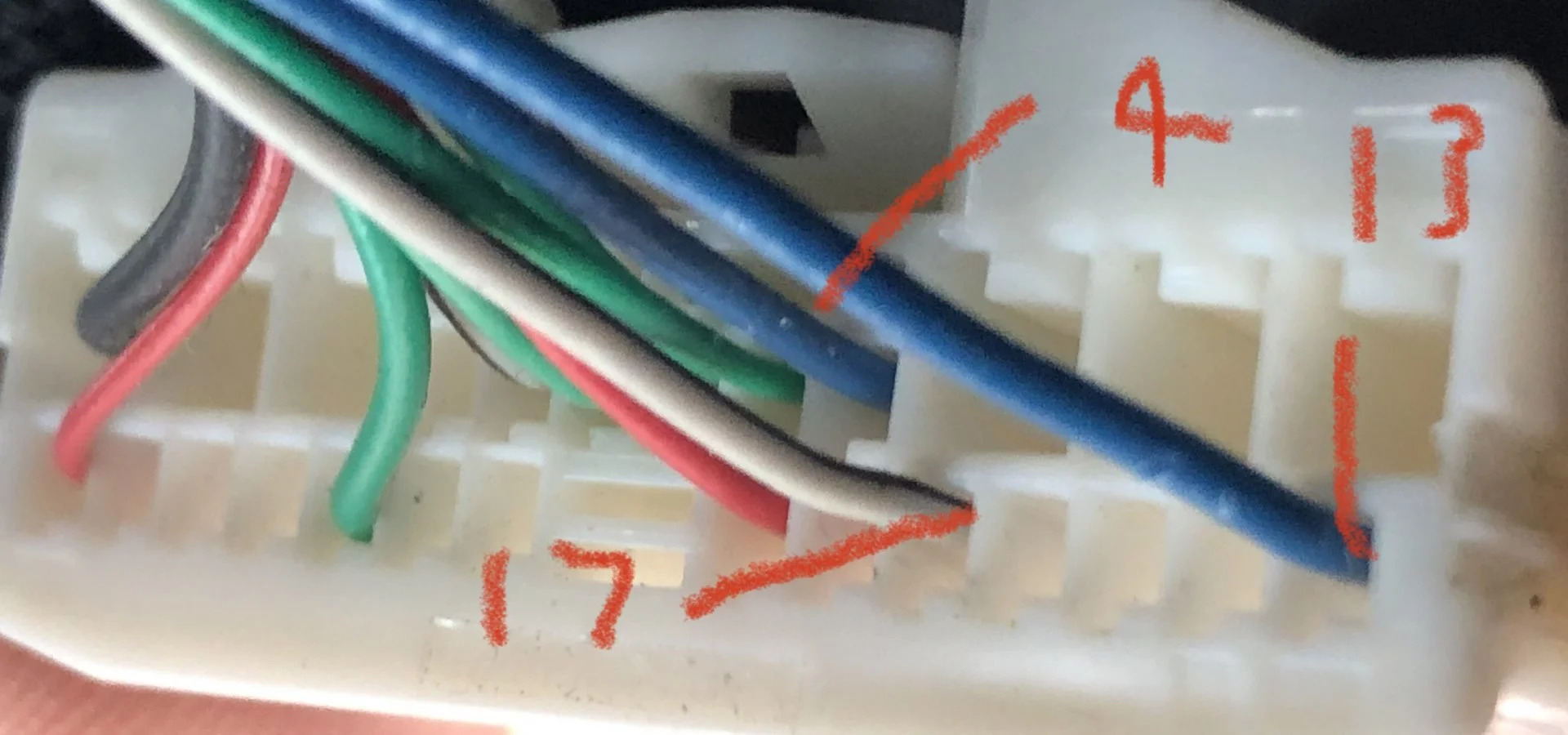

Yes, you are correct. I'm tapping into the wire that comes out of the trailer harness reverse relay behind the glovebox. I tapped into the blue wire coming out of pin 13

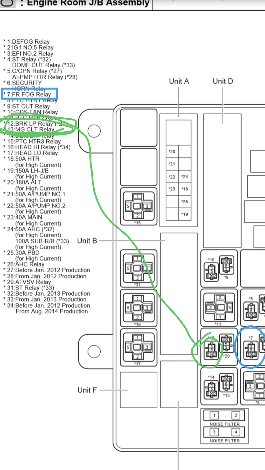

A simplier way if one doesn't want the switchpros to know state and have override turn-off functions... leave stock relay in place and just drive FR Fog #3 with whatever channel to power on at will. No need for the pink trigger wire allowing it to be used for other triggers.
This is probably equally applicable to the SQOD thread, but is there a better way to accomplish something like this other than jamming the desired Switch Pros trigger wire in the FR FOG #3 as you put the relay back in? Electrical isn't anywhere close to my forte, but it seems rather simple
I soldered mine onto the Fog Relay tang.

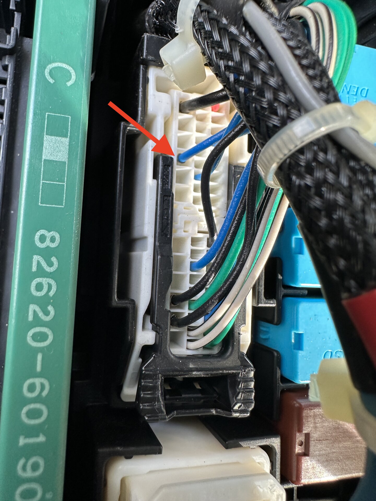

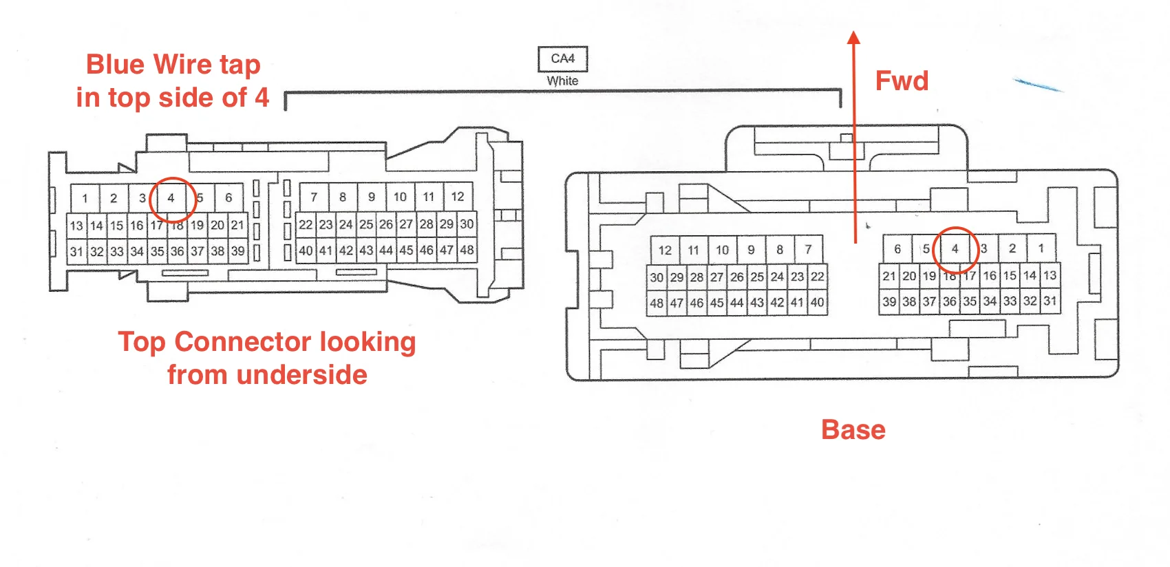

I found a new position to tap into the Backup Ltg power signal. At least on the Post 2016 LC's and LX's. Connector CA4 is located within the engine compartment Main Fuse Box, tapping Blue wire in Position #4 give an easy access signal.. Tapping in engine bay FB rather than under the dash allows for all signal/tigger functions of Hi, Lo Beam, Fog and Backup lights along with Batt and IGN power taps to be accomplished. I have not yet found an ACC source under the hood; usingFuse Box under drivers knee (LHS drive), at least on the 2017+ vehicles position SFT LOCK-ACC is unused and available. ECU-ACC No.1 is also an Accessory power slot, but i prefer not using critical fuse slots.

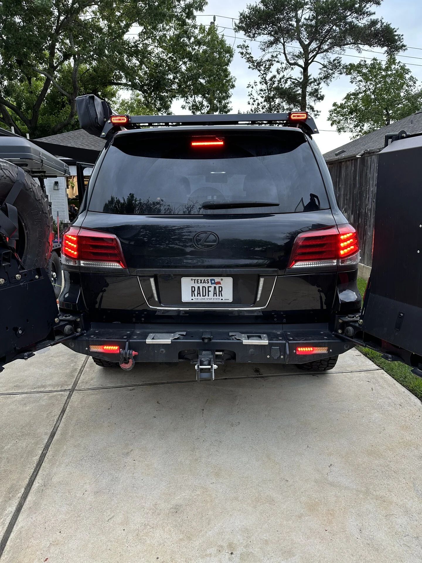

My Rigid scene lights have a red halo, so I stuck the halo lead into the stock #12 relay (just like the fog trigger mentioned in the first few posts).
Wiring is routed around the rack and then down the windshield C channel. The main LEDs are wired to a button on the switch-pros…
