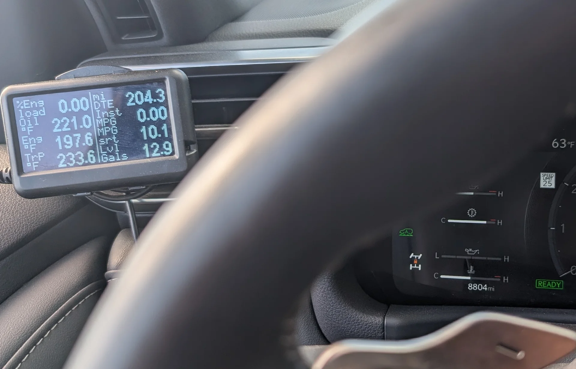

Well...
Near the top of a 5k ft climb. All wide gravel roads so I stayed in 4 high. TrP is the pan temp, the dash gauge maxed out at 245 F pan temp.
Had to pause for a few minutes to let it cool down. No towing, only mods were sliders and roof rack. Guess I'll stay in 4low next time.

Were you in 4low? I see your Centerdiff locked.
I can almost guarantee it is.
The 200 will do the same thing at long periods of time off pavement in 4HI if at slow speeds.
Nope, 4h because it was basically a gravel road. That may have been the problem...
What was your average speed during the climb? Wondering if it would've helped using s mode to keep it in a gear the transmission locks up in.
