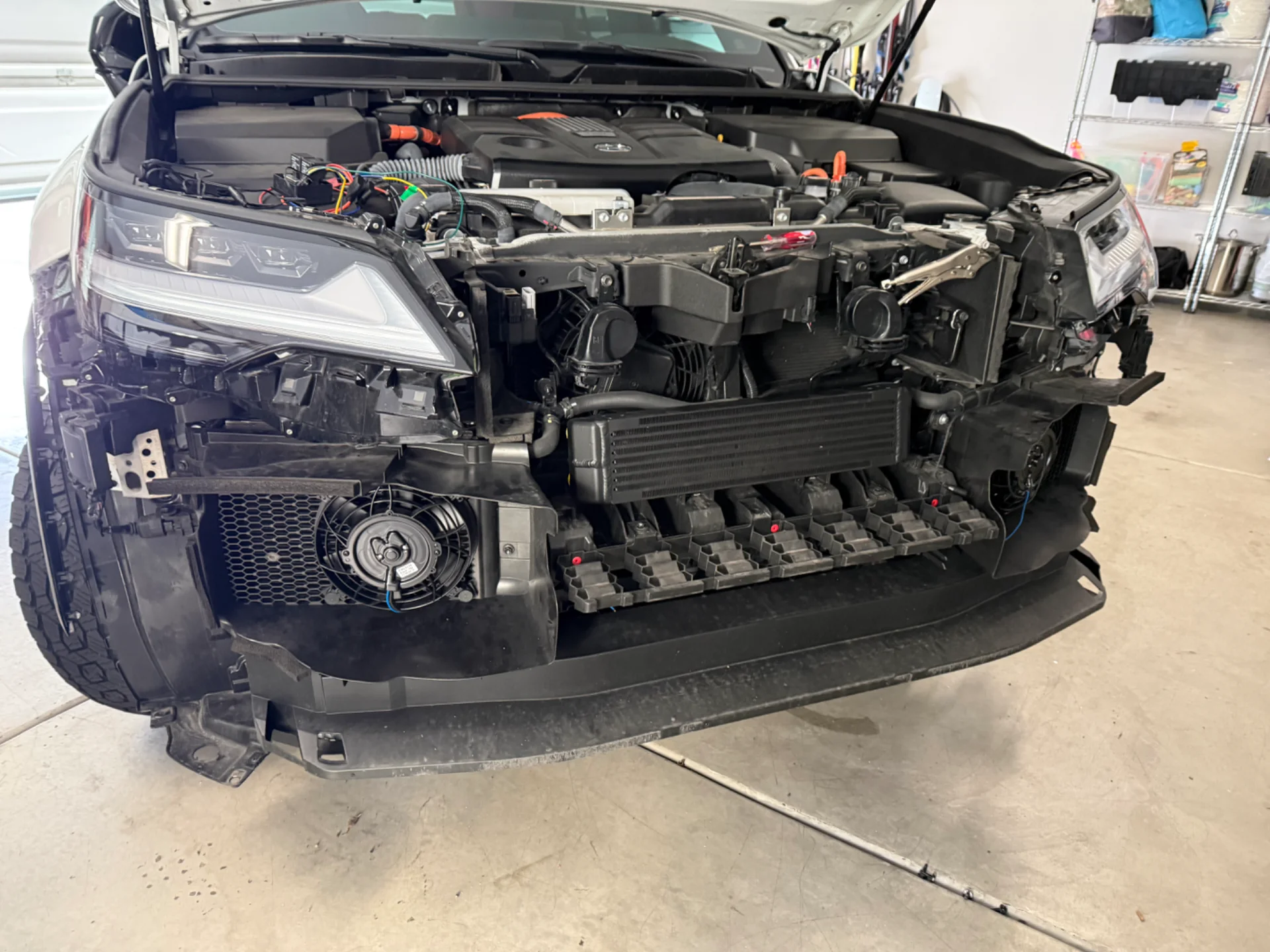

@LWC do you have additional pictures without bumper specifically showing the crash bar location and mounting setup.
I found a hidden winch setup for LC300, which replaces the OEM crash bar with steel winch plate crash bar. Working with the vendor to confirm if it will fit LX.
Link and video of this winch plate is provided below.
The crash bar locations are not going to be the problem, the overhanging nose of the Lx is since you are going to want the fairlead mount holes to pretty much be touching the backside of the plastic.
