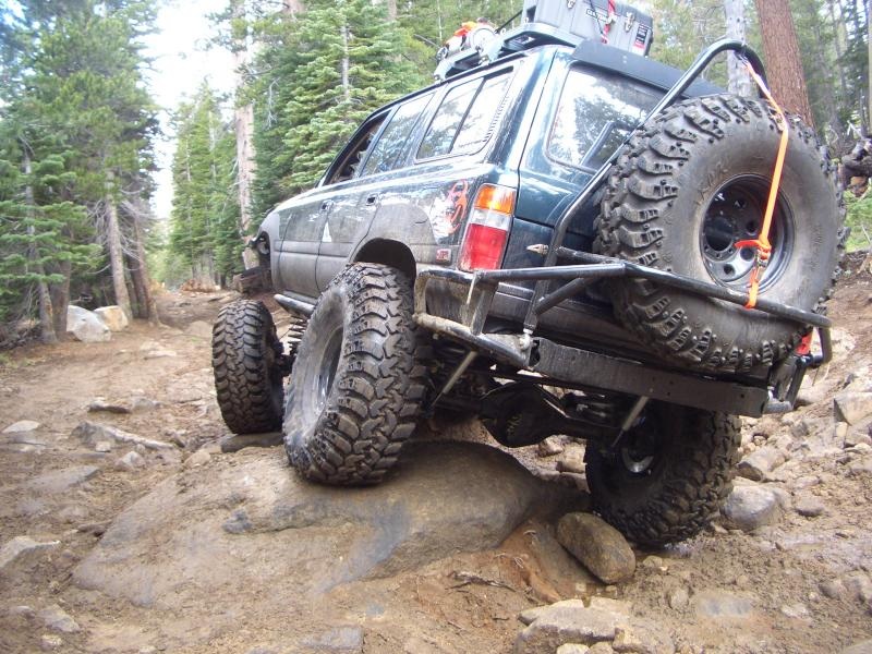

This is not an 80, but I like the design. Thinking I may copy it in the future.
