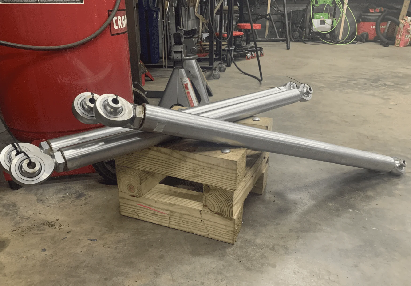

Also - got the links in from Wide Open Design and slapped the FK heims in there.
Then grabbed a buddies lift and dropped the new links in! If anyone needs any 4 link links & enduro joints or Barnes heims you let me know.
Fit and finish of the FK heims is amaaaaazing. They're so much tighter tolerance than any other heim I've had on the truck. The vibrations above 65 have gone away and also the "clunk" on takeoff has gone away (which already let me know that there was another joint about to fail in my previous setup).

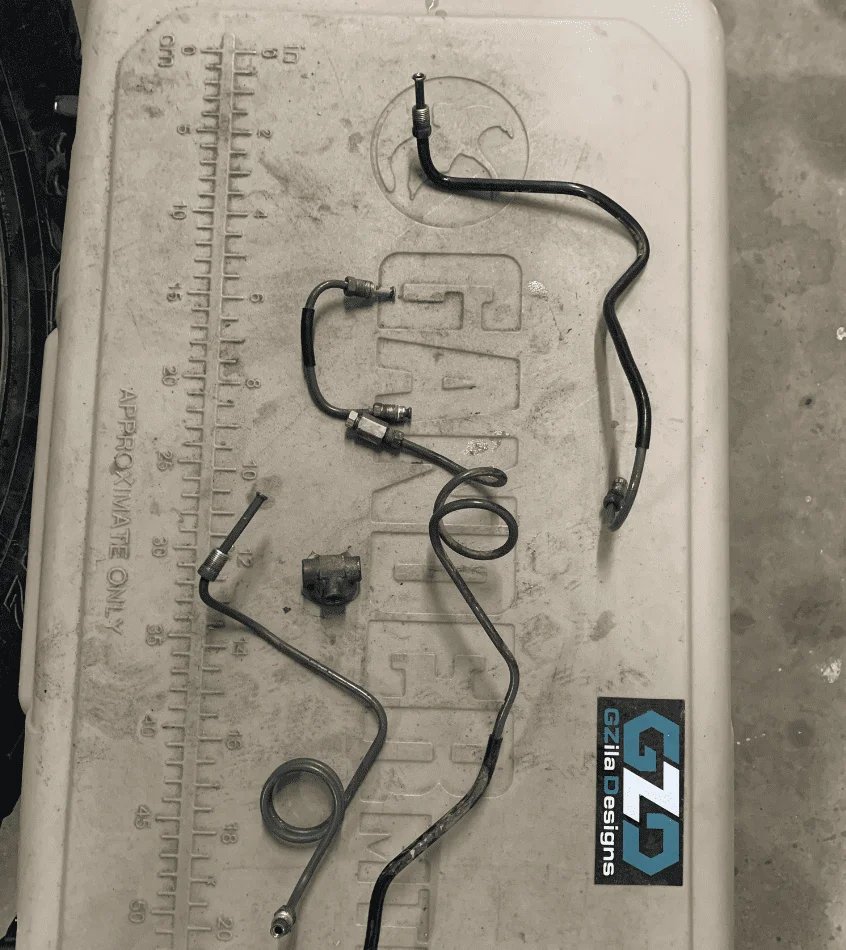

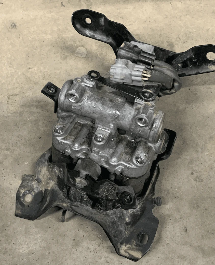

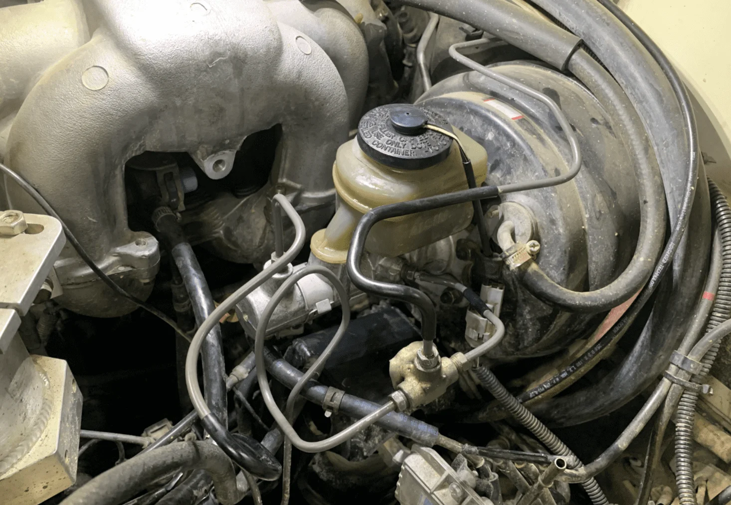

Went ahead and deleted ABS, my brakes have always been spongy, but they've been going downhill recently and I think it may be the ABS as a culprit. There are many great writeups on here and I chose to use this one:
All in all - couldn't have gone any smoother.
Finished product:
Bleeding the system was notably easier and the pedal feel is great.

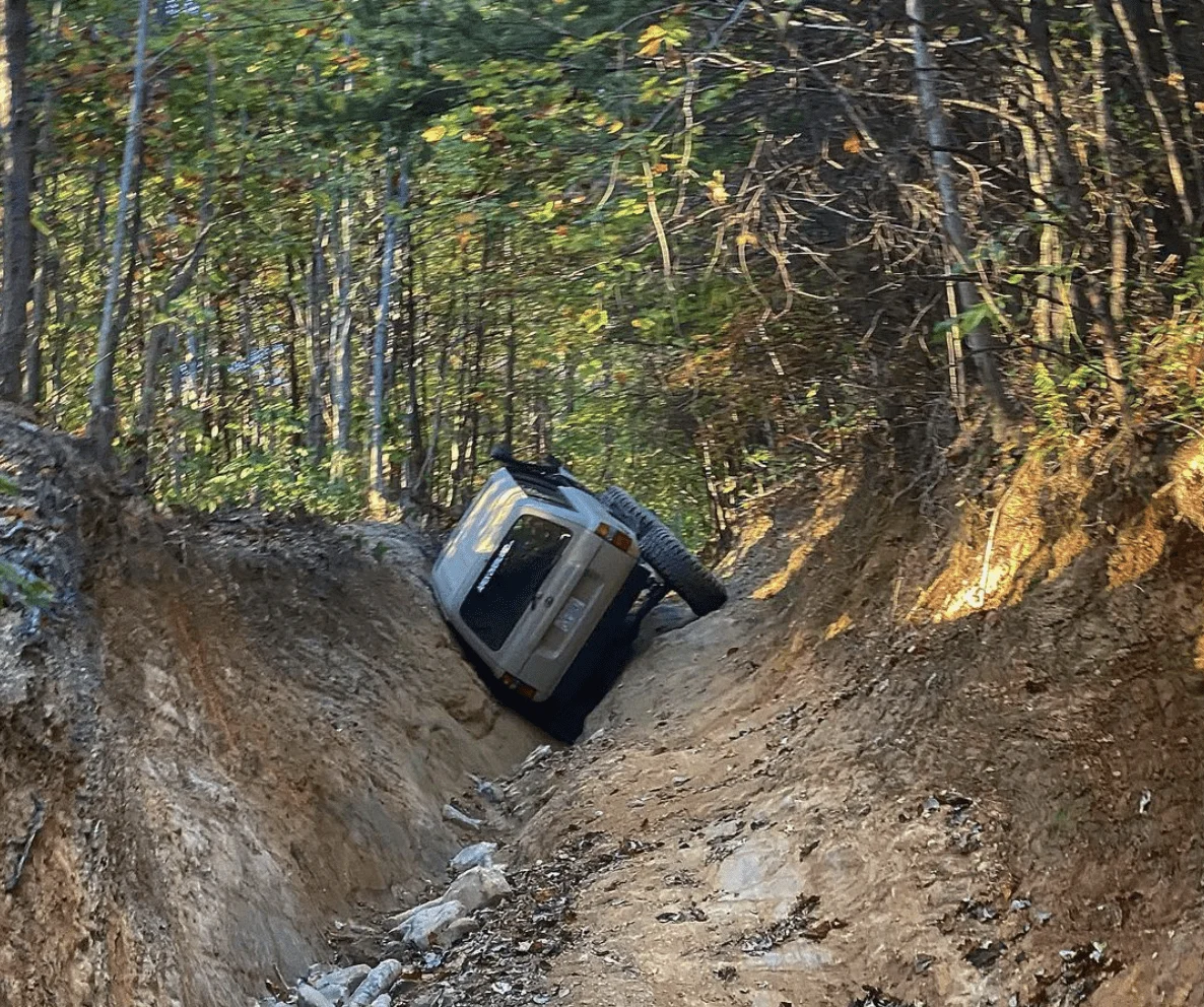

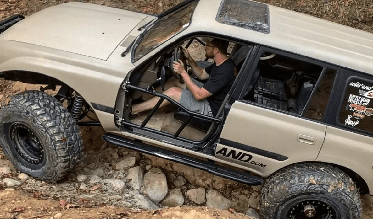

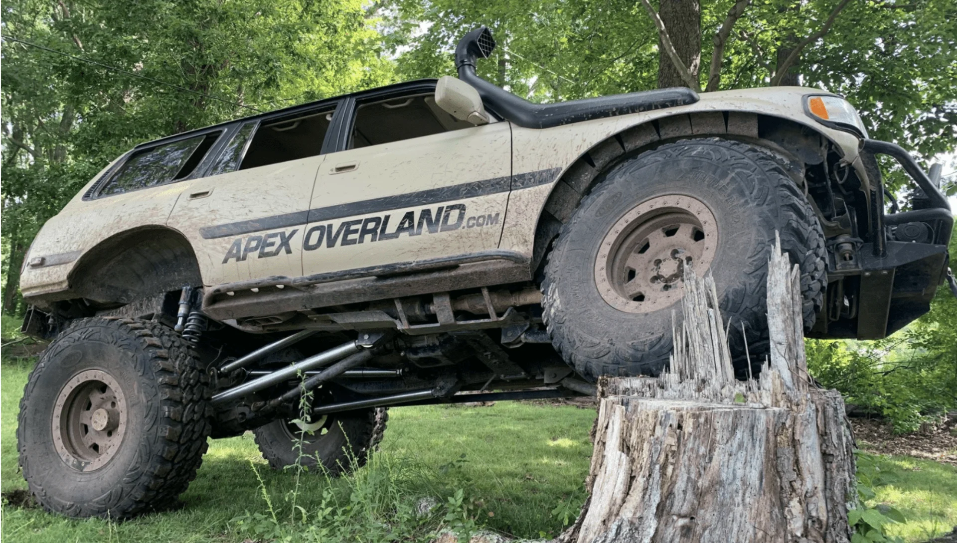

So wheeling season this year was epic, even though it started late due to Covid I made it out to Windrock way more than I typically do in a normal year and we had a freakin blast. Tried new trail, put my truck into a wall, leaned it on a handful of rocks and really appreciated my tube doors (in the pouring rain, in the dust, in the heat... and in the mud).
Got to finish the year competing in the southern overland challenge at Uwharrie this year on Team Apex Overland. Had a blast, beat the truck up... could only drive about 45mph for 1.5hrs home because death wobble. But she's all back together now!

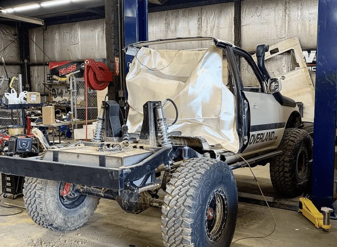

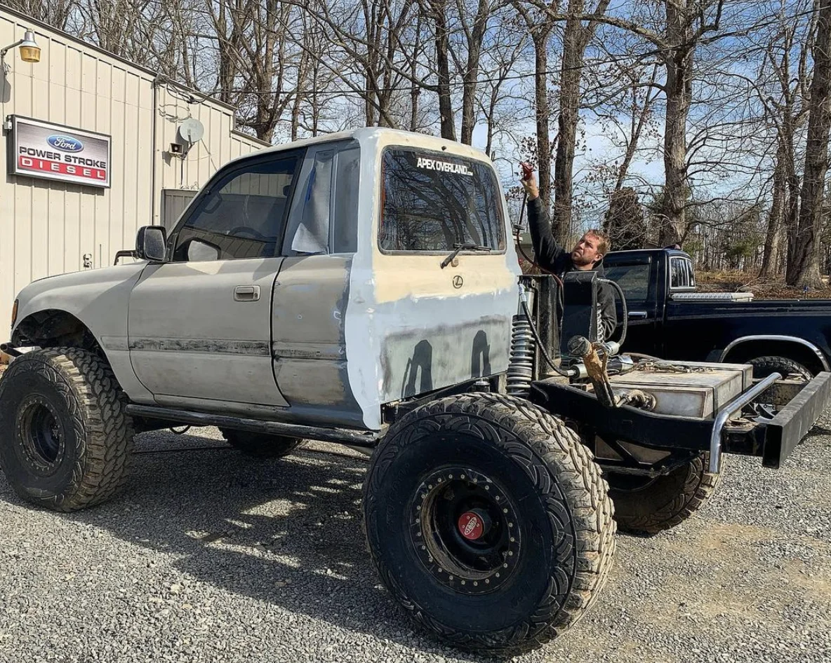

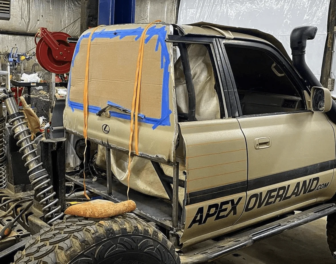

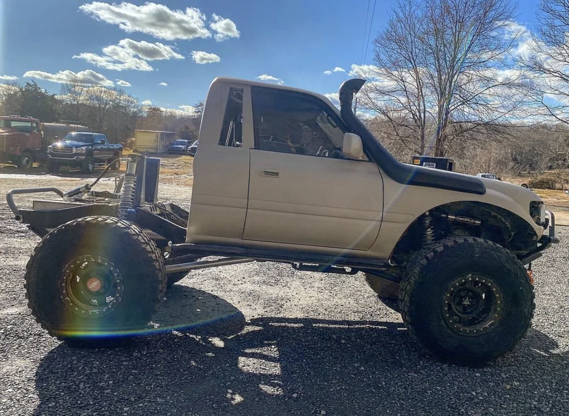

Yep you read it right... ole brown is gonna shave some weight. We're in the process of UTE chopping the truck.

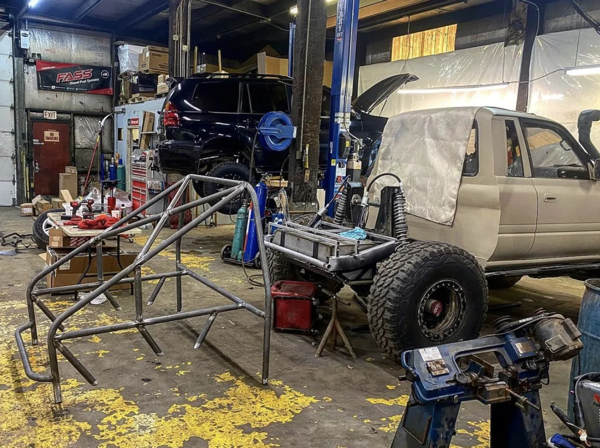

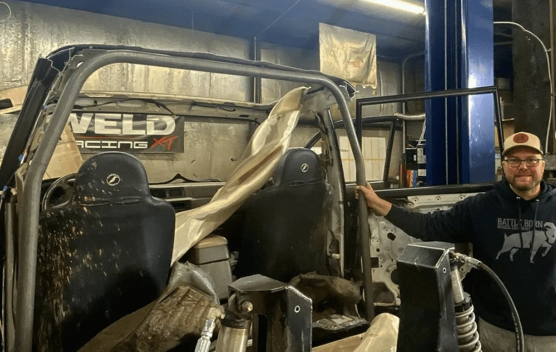

I got a chance to bend my first ever roll bar with our JD2 Model 32

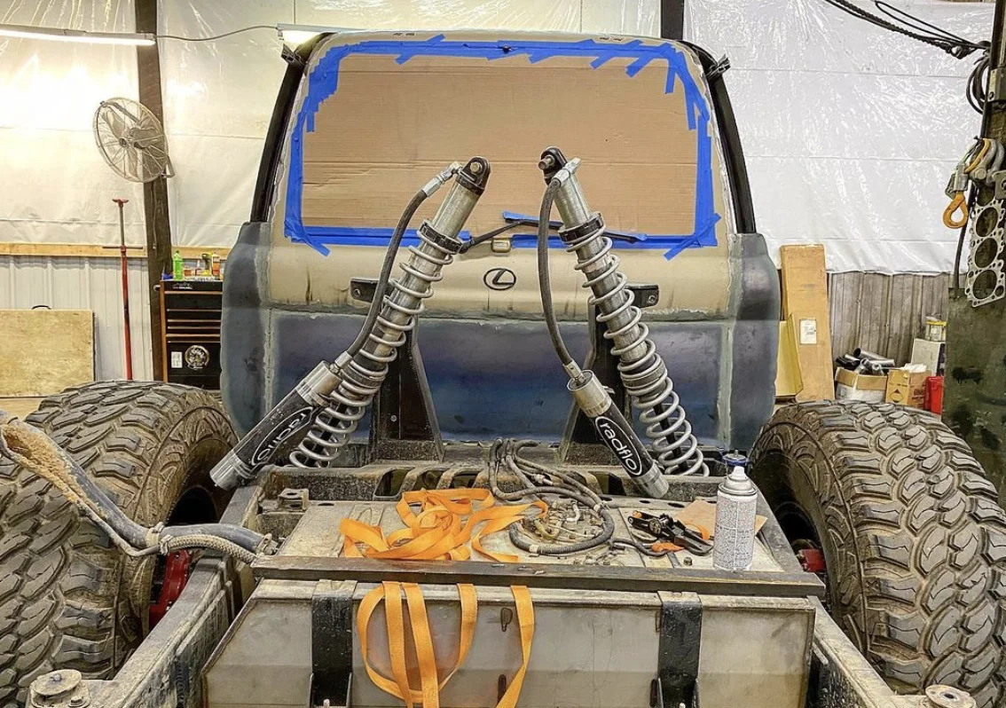

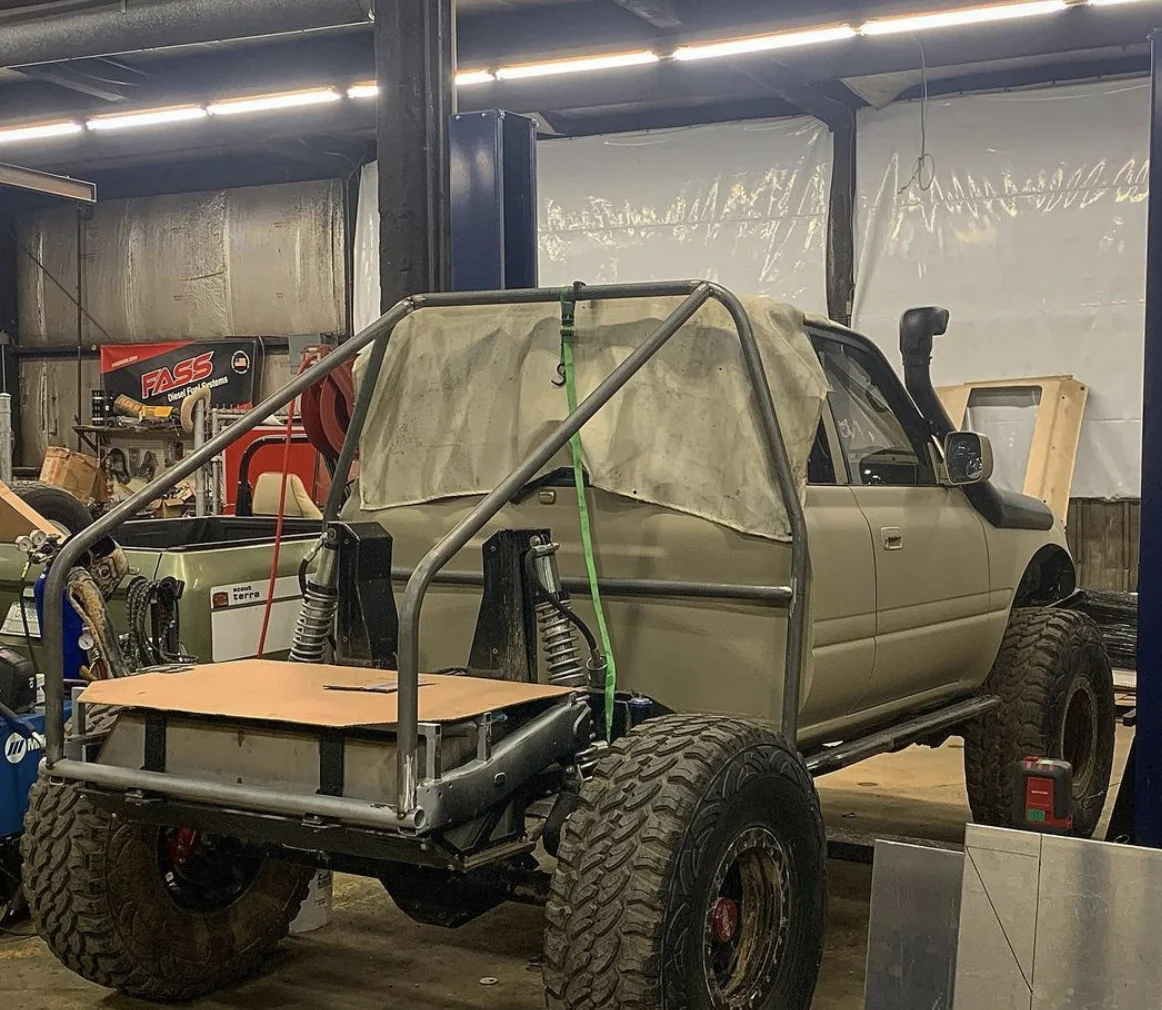

Goal is to utilize the hatch, retain rear window wiper (cause cool factor) and then build an external cage / bed for the rear where I can hard mount storage boxes, hi lift, spare ...etc.

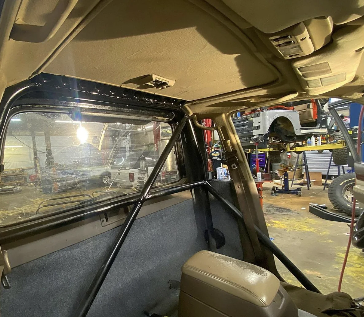

As of this very moment the floor is in, and the internal bracing for the body is together. Inner roll bar has been hard mounted, gusseted beside the seats and built out to hold my harness through the seats.

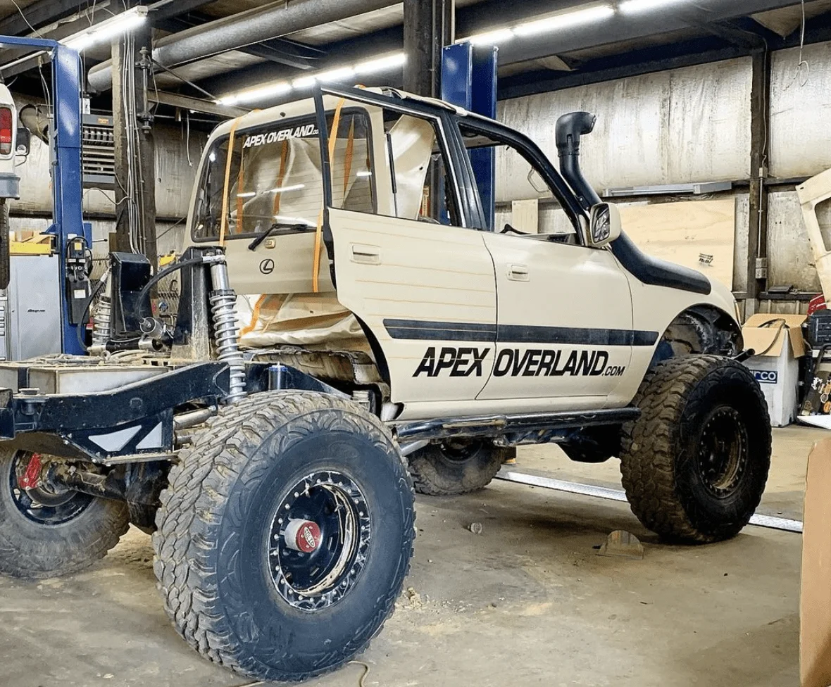

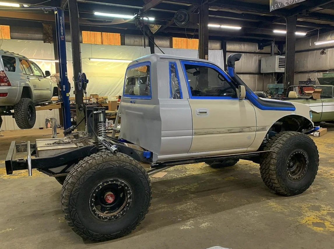

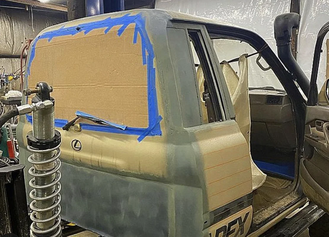

Wow where to begin, last I left you guys ole brown was in half and the body work was beginning to start.
I can take no credit for the body work - all my friend Josh at Apex Overland

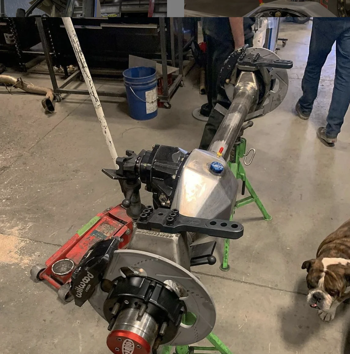

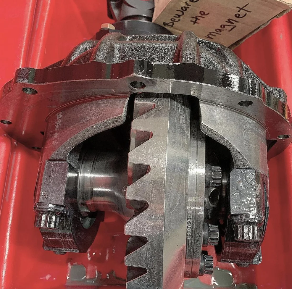

While the body work was going down I worked with Randy Rodd over at Jimmy's 4x4 to start sourcing 2020 KoH parts to put together a spidertrax front axle utilizing gearworks 10" stuff.
^^^ This will be a project for another day as once I install these 10's w/ 6.20 gearing, I'm about done w/ road trips. She'll go trailer queen.
Josh did truly epic body work, I love how it all came out
Here is a quick look at the interior once the body got filled in. We did a sunroof delete but fit the factory trim all back in because pinkies out. This internal roll cage is not designed to be my life saver if in case I were to roll. You'll see what we built in the rear soon that is all tied into the frame. This was used to support my harness straps and also stitch into the body to make it very structurally sound again.
Here she is back on her own weight again and all bare metal has been primed. I brought my tube bender over to Apex to start working on the only part of this build I'm decent at. The bending & cage work.
Prior to painting going down I got a sweet surprise from the dudes over at gearworks. A matching HP10 w/ 6.20 gearing and their billet automatic locker.

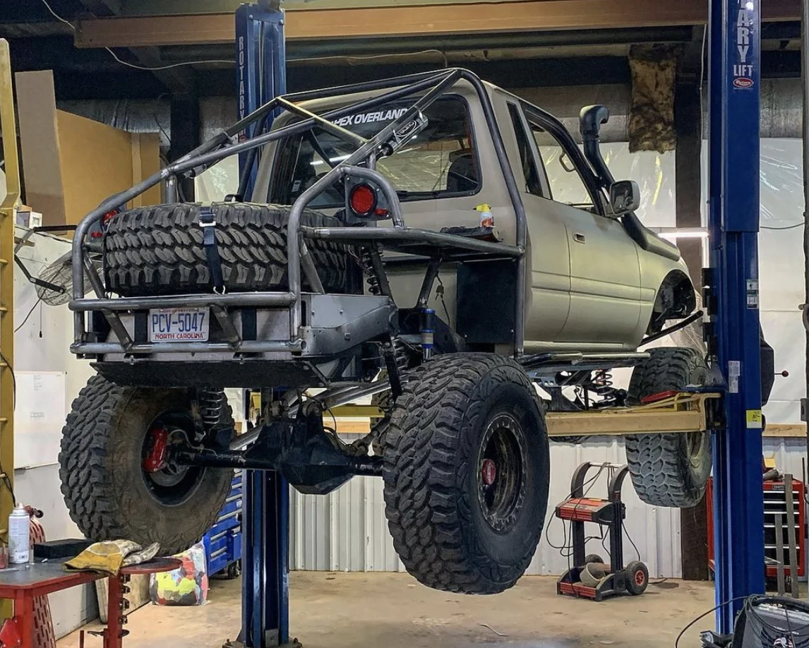

Then the fun began. Goal for this chop was to have a take on an aussie style UTE and also more modern truggy. Wanted to utilize the area above the gas tank as a flat storage area for spare tire and then an area inside the coil towers to the body where I could do some wet/dry storage (NOTE - this is still in process)
Cage completed and finish welded, now time to tie it into the frame

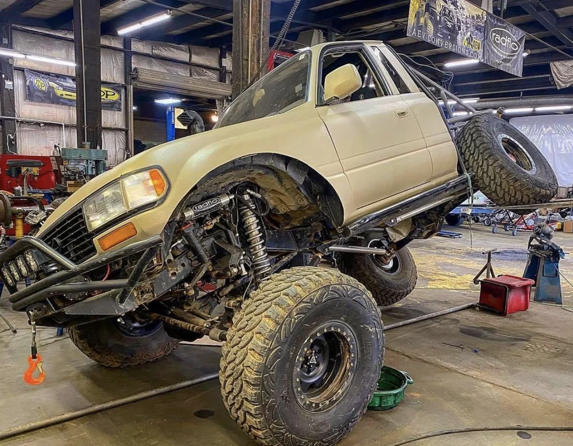

Here is a flex test to make sure I measured correctly for the fender flares. Perfect clearance... for 40s... I may have some rub if/when I entertain 42s
