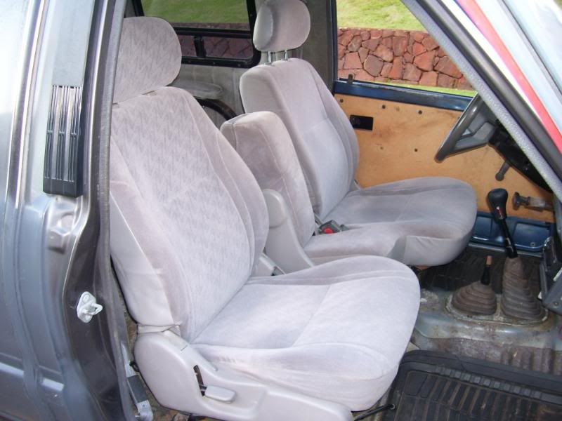

The 60/40 seats came in 89-95 Toyota US SPEC X-cabs and some single cabs. Seats 3 in front and don't forget the seat belts. It's a direct bolt on with no mods. I had these in most of my minis on 2wd/4wd trucks. I've personally seen them in only grey in color. The tans came in the 96 and up tacos. I did have the tan 1 in my 87 custom cab, but did have to mod the holes.
I used the same seats in 2 different trucks. The seats are tan and came from a 97 taco.
