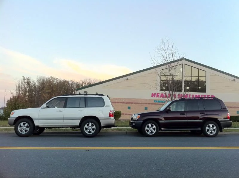

I went the full OME route with my 1996 4Runner years ago. I loved the look, but the ride was terrible on a stock weight 4Runner. With my 2003 Land Cruiser—which spends 99% of its time on road—I opted to keep the factory ride but gain some lift by installing a rear coil spring spacer and cranking the front torsion bars to match. The rear spacer is 1.5" (38.1 mm), and the front torsion bars have been adjusted to bring the Land Cruiser level (about 2"). Front suspension droop is good at 65 mm. I love the look, and the ride—even with the new 275/70-18 BFG AT KO's aired up to 50 PSI—is great! The 275/70-18 measures 11" wide and 33.25" tall at 50 PSI—it is the perfect size for this amount of lift.
