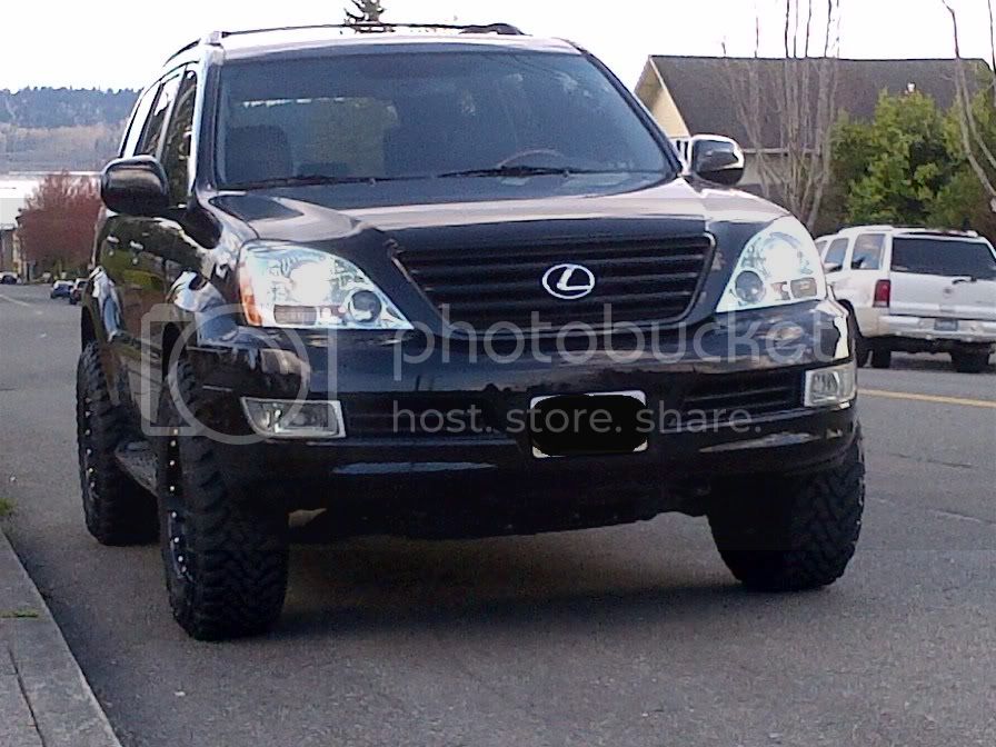

Here are some pics of my truck.

They're called the XD Strike sold under the ubiquitous kmcwheels.com brand (you can find specs and a bunch of other info there). I got the 17x9 setup to accommodate the smallest Toyo MTs which still required trimming. Nothing drastic and well worth the effort! Toyo MTs are the quietest riding MTs in the market (on par with BFG TA KOs).
Dig the wheels and tires... Needs a lift though. :)
