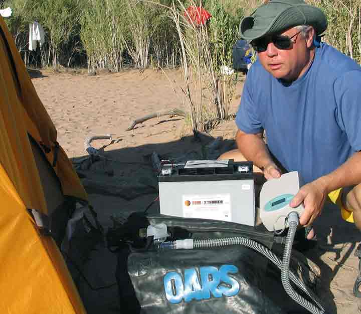

This guy took his cpap with him on a four-day rafting trip in the Grand Canyon and seemed to have a good handle on it. His machine was a dedicated 12V.
Cpap to the Grand Canyon
