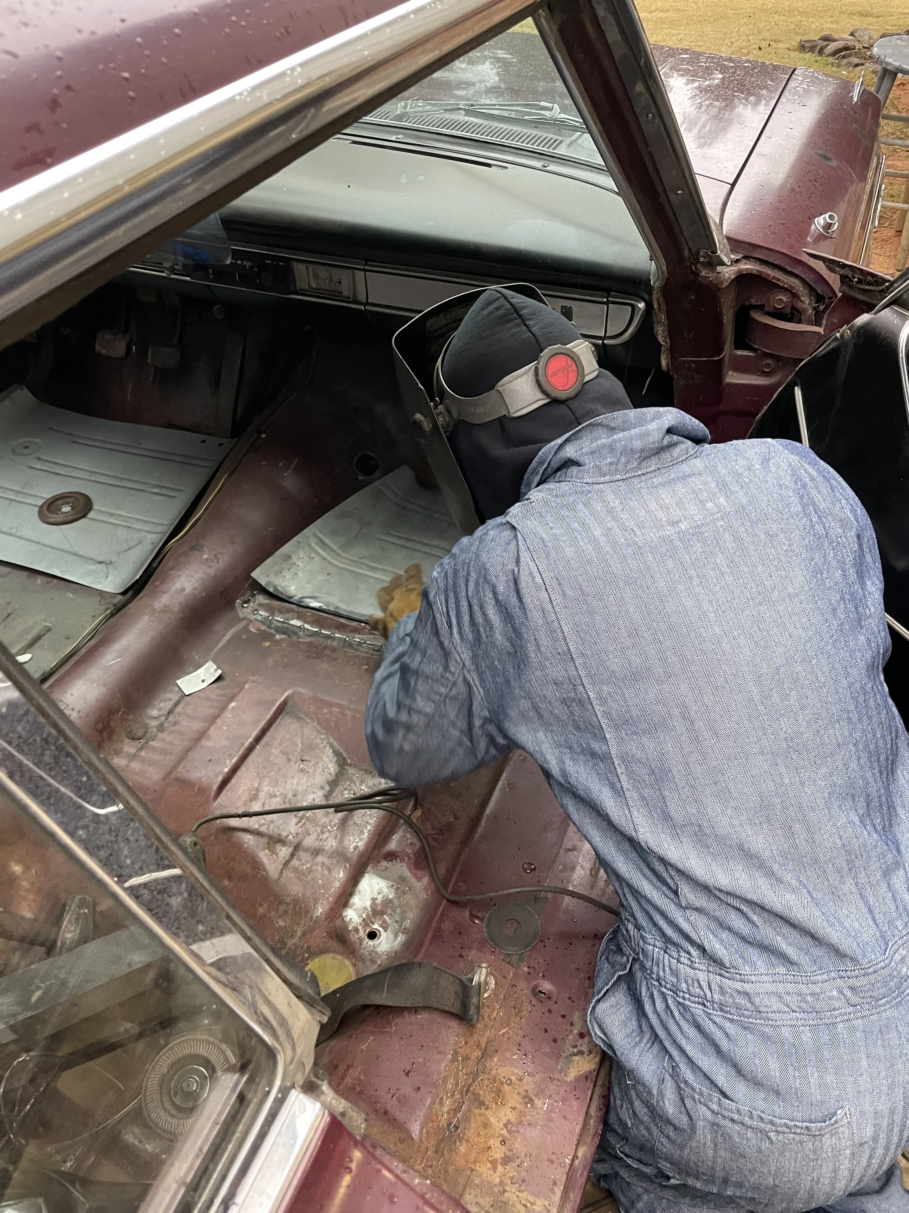

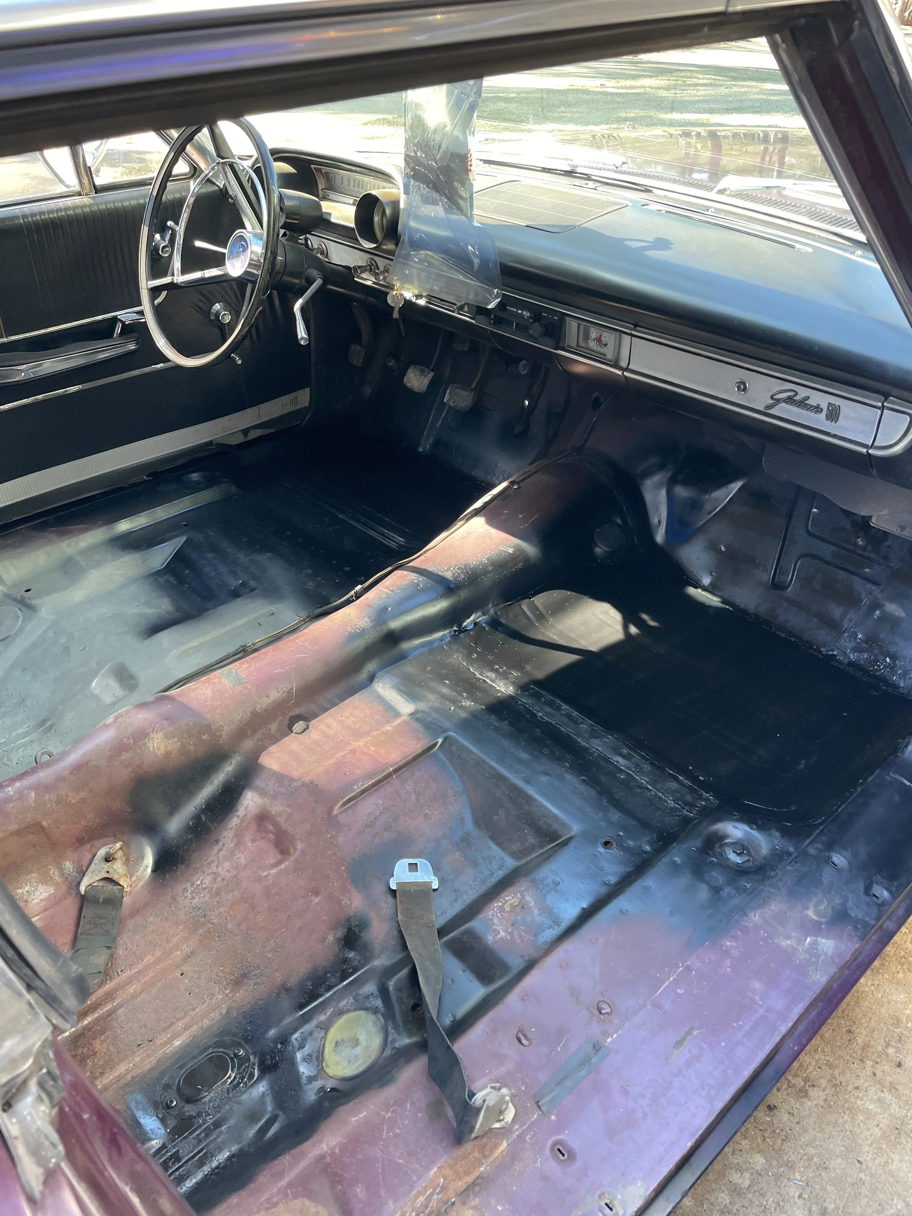

The photo above makes it look really nice but is kinda deceiving. It was a pretty solid car but needed floor pans upon initial inspection. It was also missing carpets, headliner was in tatters, and there was some bad rust in the deck lid seal channel (very common). I drove it down to the shop and immediately dug into rust repair.

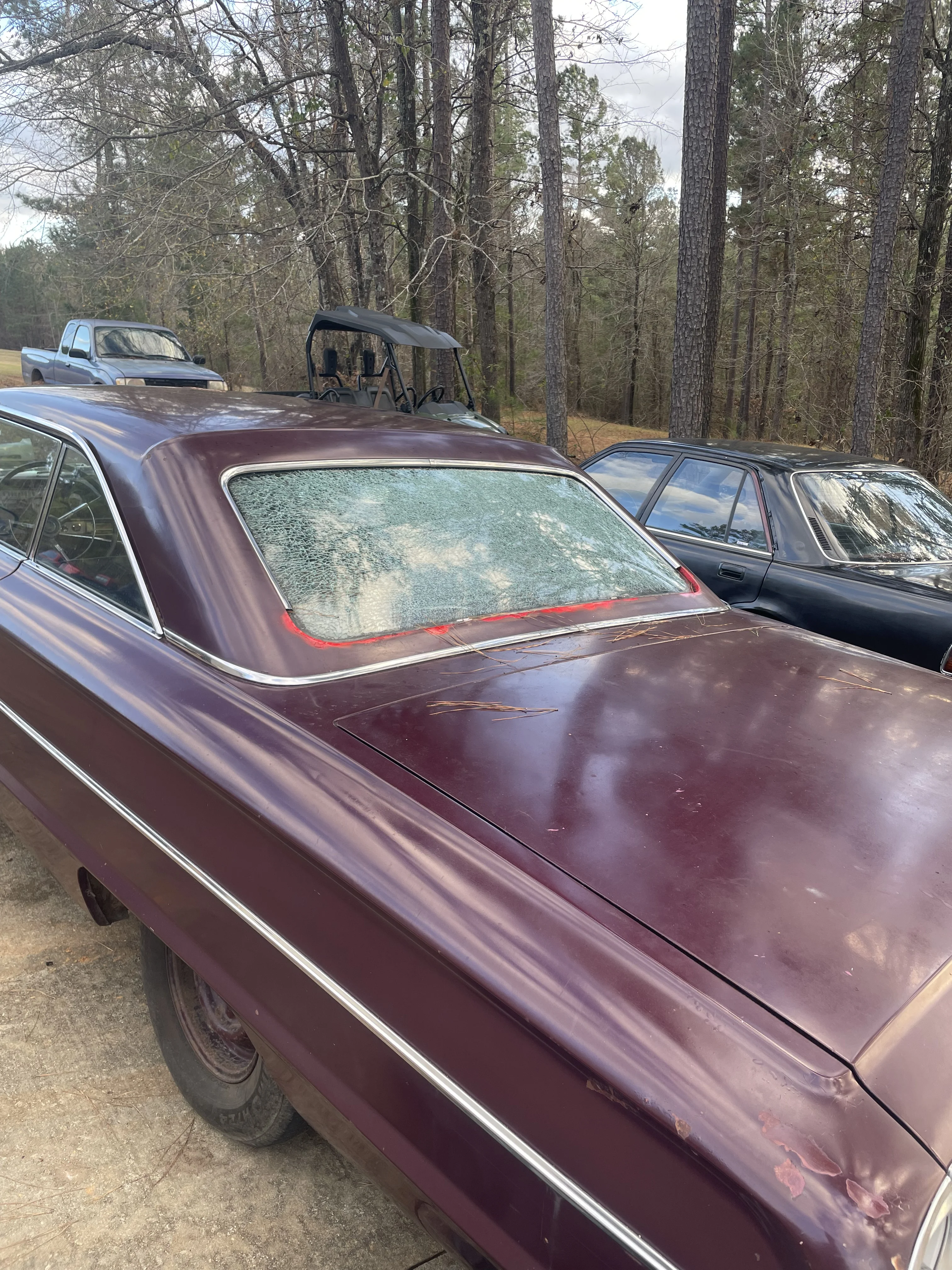

There were a couple of pinholes that I could see around the rear glass. No worries, I'll just zap them real quick and good as new! Shoulda seen that coming.
full
Once the rear glass busted I got pi**ed off and just left it in the field for a long long loooong time. Basically built the entire F250 in my signature during my hate break from the car but now that the truck is running and driving... I just might give the boat the second life it so deserves.
