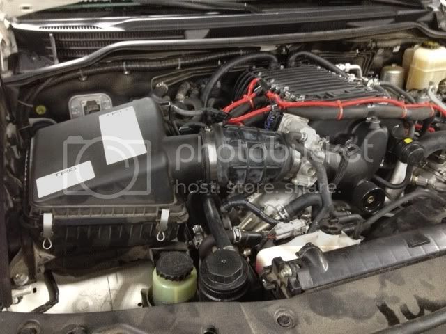

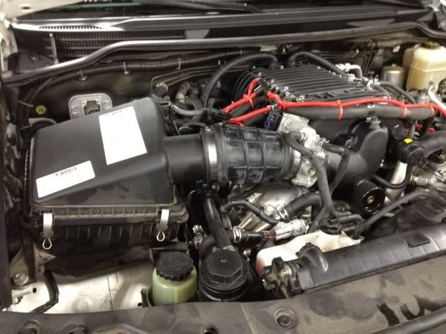

This afternoon I dropped off my Land Cruiser at Sparks Toyota in Myrtle Beach to have the TRD supercharger installed. I'll post pictures once I get it back.

I just called Sparks Toyota, and they are in fact installing the TRD supercharger. Voids all warranty, but who needs warranty on a Cruiser! I'll be interested to hear Igop thoughts on the results. Sparks expects to finish the Cruiser today. And I may be driving my 2009 out next week!
Impressions
The truck is strong and gas mileage was around 24mpg after filling up and driving around town.
The only issue I noticed is that the transmission is a bit slushy and it is more noticable due to the increased power, but IPT will be taking care of that next week.
Overall, I am very impressed and highly recommend the upgrade. The Land Cruiser no longer has to work to accelerate and it feels a lot smoother. Working with Jamie at Sparks was a pleasure and they took great care of me!

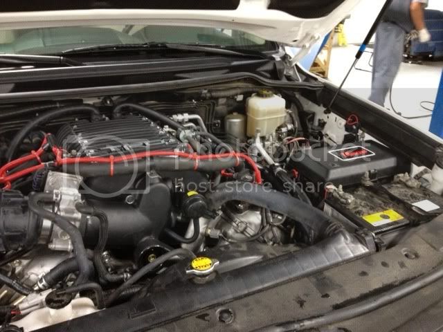

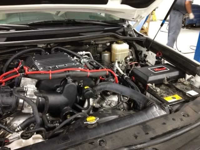

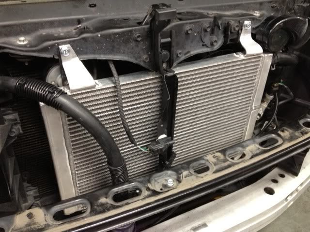

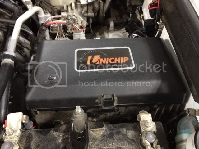

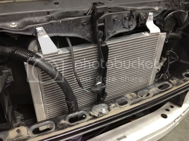

Overall it took about 20 hours of labor, there is a bit of fabrication that is needed. The Tundra kit is very straight forward and there are easy instructions to follow. That is not the case for the Land Cruiser.
We did our homework and once we had lgop's ride here we were able to do more digging and make it work like it should. For power output I'd say its pretty close to a Supercharged Tundra, it did feel a little heavier but then again it is a little heavier, as well as running with full time 4wd. But I would say it's a lot better than it was before and if you were to put a stock supercharged LC vs a stock supercharged Tundra it'd be a close race. The 5.7 responds very well to the supercharger and runs more efficiently. The top end is AMAZING, but you can feel a big difference in power the second you touch the throttle. :steer:
If done at our shop here we can do it out the door for no more than $8500, that includes the Supercharger, Supercharger Fit Kit, Programmer, Fabrication, Labor, Tax, etc). Besides while you're waiting you can enjoy a little vacation at the beach :D
