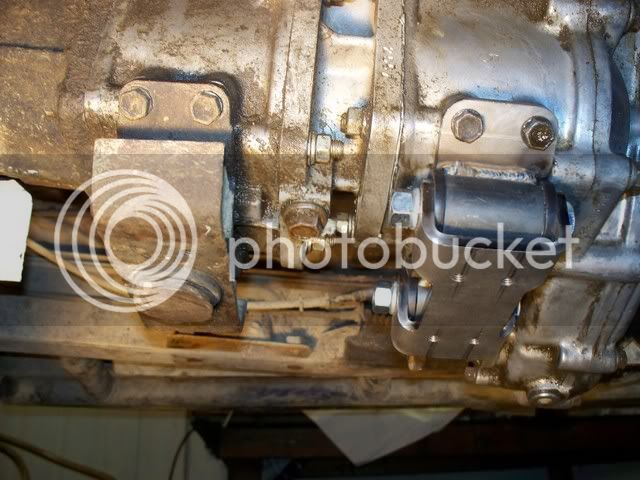

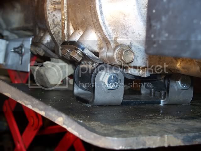

I run Sky's crossmember with dual case and a 4.7 gear in the rear case. After tearing up a transfer case mount and an engine mount I started looking for solutions to eliminate future driveline issues. I replaced my engine mounts and welded chain links to them. I also put a brand new factory mount on the rear case. I still had pretty much the same driveline play. My driveline brake disc was hitting the sides and rubbing. I decided I still needed something more.
Options I considered:
FROR crossmember ($299)
Toyota heavy duty t-case mount from Marlin ($110)
4xinnovations super duty transfer case mount ($75)

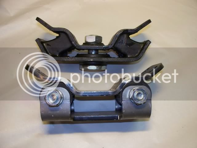

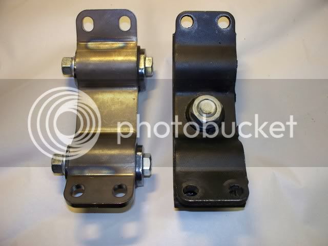

I wasn't ready to spend $299 to replace a my Sky crossmember when there is nothing wrong with it. I found out about the transfer case mount 4xinnovations designed and was impressed. Decided to give it a try.
Features:
*Energy Suspension Poly round bushings that will not split.
*Thicker steel plates that are laser cut and CNC formed for the best fit possible.
*Direct replacement mount
*If you need remove your transfer case or transmission you now only need to remove the two bolts from the bushings
The verdict:
The product was shipped and received in a very timely manner. 4xinnovations customer service is excellent! The mount is of very good quality. Installation was a breeze. Now my driveline is firm, vibrations greatly reduced, and no more rubbing or excessive play. Definately worth the $75 to upgrade and have no worries.

I can definitely see where that would be a better design than OEM and looks a little easier to service as well. Are those leaf spring bushings the bolts run through, or are they made specifically for that part?
That I can not answer that for sure. I know they are Energy Suspension bushings that can be purchased from a dealer that sells Energy Suspension bushings. For more specific information I would contact Adam at 4xinnovations.
