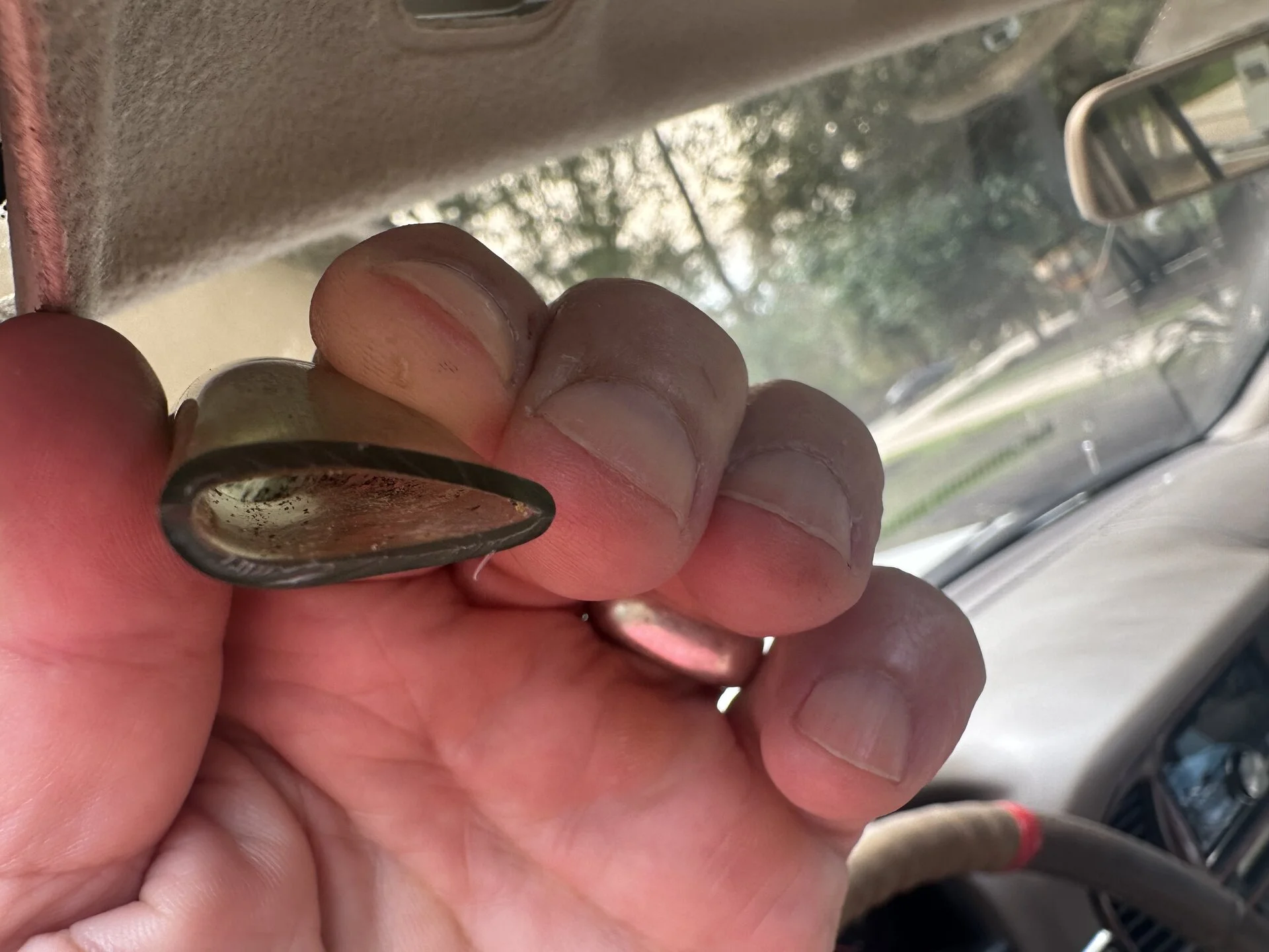

Does anyone know the inner diameter of the sunroof drain hose?

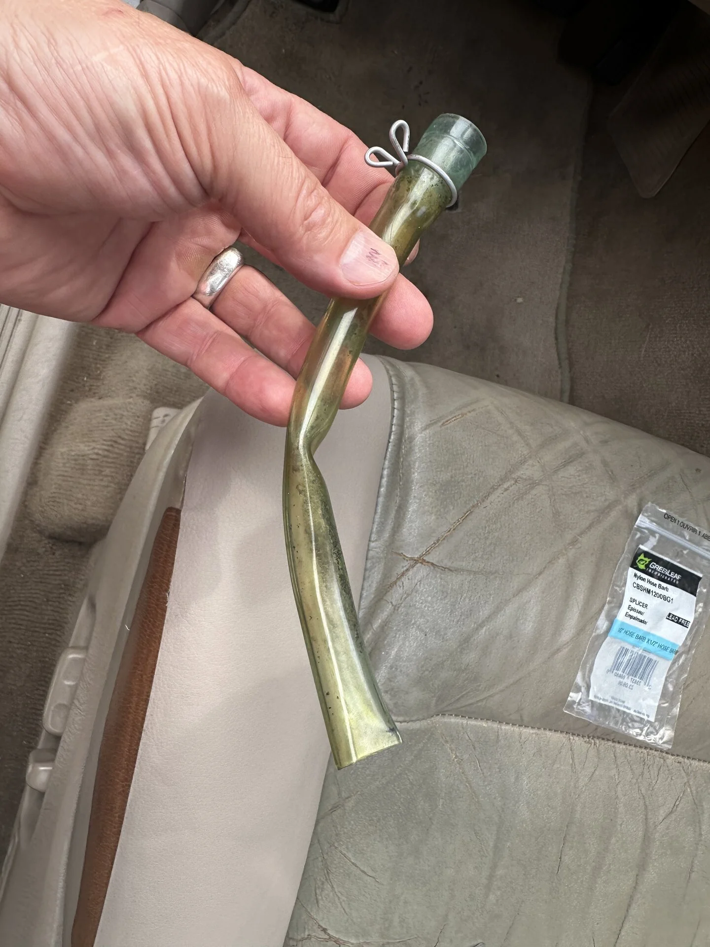

My driver's side front drain was chronically clogging, so I inspected it through the A-pillar and found the hose had been pinched between the roof and headliner. It's been like that for so long that it doesn't want to return to its normal shape. I was thinking I could cut it and insert a rigid coupling as a stent so it won't collapse again. The outer diameter seems to be about 5/8 inch or 15 mm, so I am guessing the inner diameter is 1/2 inch. However, I'd like to confirm the inner diameter before I start cutting things so I can make sure I have an appropriate connector.
I searched for the part, but it seems to be discontinued maybe because it is just standard hose material.
For anyone who has troublesome sunroof drains, you may want to check that they aren’t pinched. I could never get a weed whacker line past the first 8 inches or so.

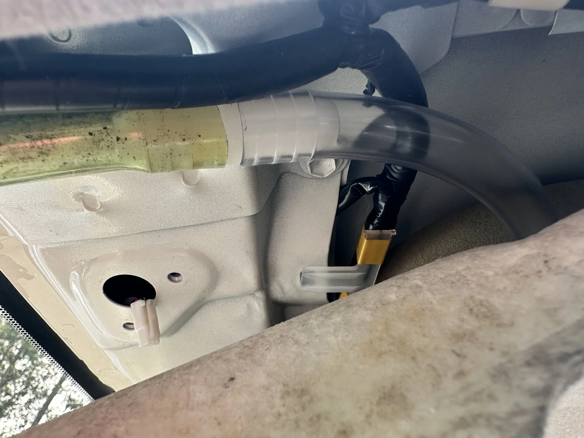

I added a 1/2 inch nylon hose barb where the pinch occurs and it’s made a huge difference in drainage.
The channel where the hose runs between the sunroof pan and the A pillar is barely big enough for the hose. So if the hose gets positioned incorrectly, it gets pinched. Mine had been like that for so long they were permanently deformed. The nylon hose barb should keep it from happening again.
I had to remove the trim on the A pillar and remove the sun visor to pull the headliner down just a bit. I replace the first 8 inches or so with 1/2 inch inner diameter clear vinyl tubing because there was a secondary pinch as well.

I found the issue, almost all 4 drain hoses are extremely pinched in several places and there is hardly any flow through the hoses.
Unpinching and cleaning them fixes it for maybe a month if I am lucky. I will need new hoses.

Thicker material will not solve your problem. Use the OEM hoses you have and route them so that they will not become pinched. This is possible, becuase it's the way the system was designed, and literally thousands of trucks were produced this way. In a very few instances, someone missed something, or installed a plastic trim piece improperly, and you have what you have.
If your hoses have taken a set, over the years, slip a wooden dowel in them and warm them with a hair dryer or heat gun on low. Let them cool with the dowel in place. This will fix the crimp problem.
If you want to replace the front hoses, by all means, do so. It'll at least be clean.
