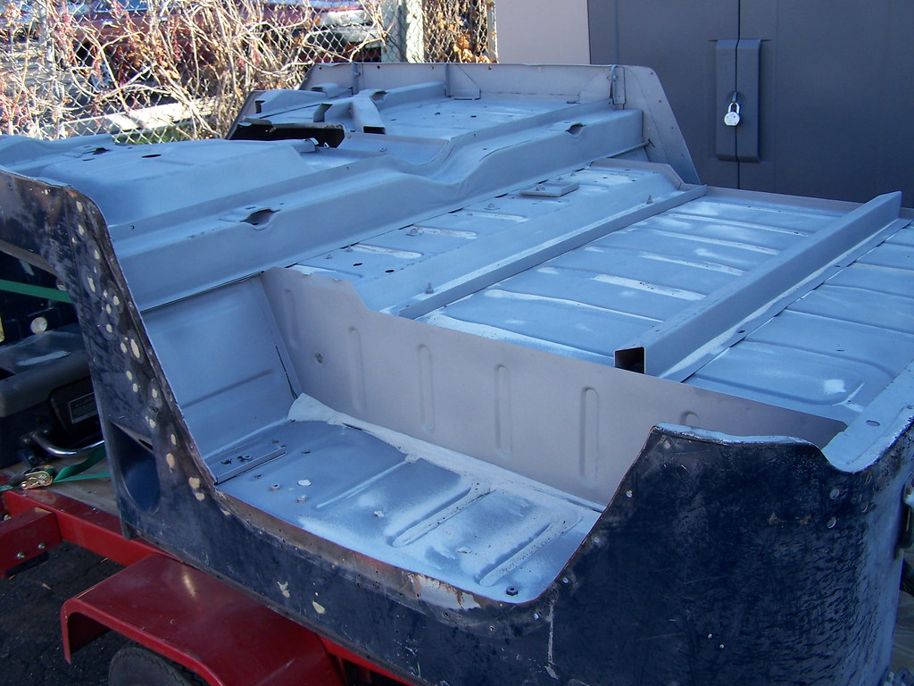

There has been much chat as to what not to use for my undercoating on the 40.
What would any of you suggest I use, I have been happy with POR-15 products, A lot of locals pooh pooh it, Im trying to drag out what they do like, But in the mean time I would like to hear what any of you have to offer.
This is what I am painting...
Thanks :cheers:

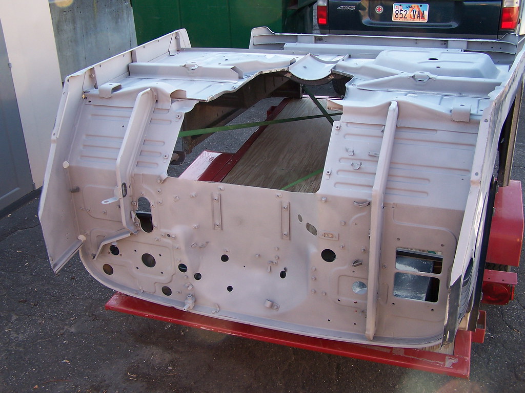

I am going to go with the SEM bedliner product myself for my 69 project. I do think however that the POR product would do an outstanding job. That stuff is tuff! I have used it on my frames...
my god man, that is a fantastic blast job. My guy is using a heavy 2-component urethane primer as tuff as undercoating. I can get the name if you like.
That blast job needs to be a reference for those in the future looking to see WHAT it should look like;).
I see not grey
I see no dark spots at all.
And it appears whitish:bounce::bounce2:pefect.
Go with the 2 step that he advised above:D

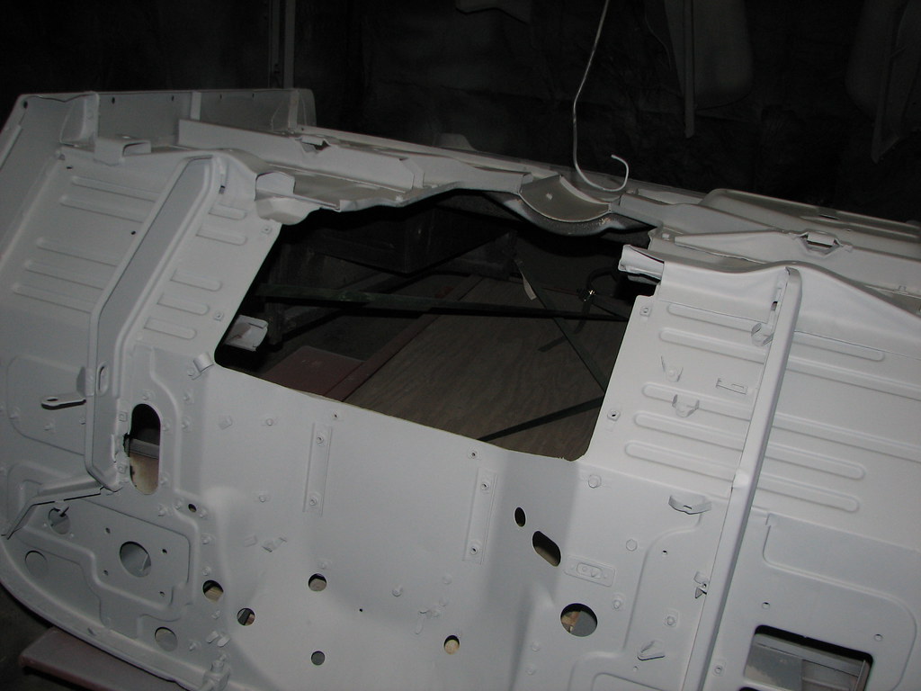

I bought some 5 Star High Build 2K filler primer/sealer, Its a 2 part epoxy paint and topcoat
I hope it works, The guy at the paint shop said people have been very happy with it, Its grey, But I was told I could paint it what ever color i wanted to afterword.

again-You have a fabulous subststrate to work with. Most of these people have crap(like me). Any kind of a 2 component primer/finish will work. "Etching" is a body man misnomer unless you have bondo...
Thanks :cheers: I guess the money I paid for it 12.5 years ago has paid off :cool:
I walked into the garage for the first time since Mon.....all looks great I may give it another coat on the fenders and bib, But all the rest looks fabulous! The smell on the other hand is STILL overwhelming...

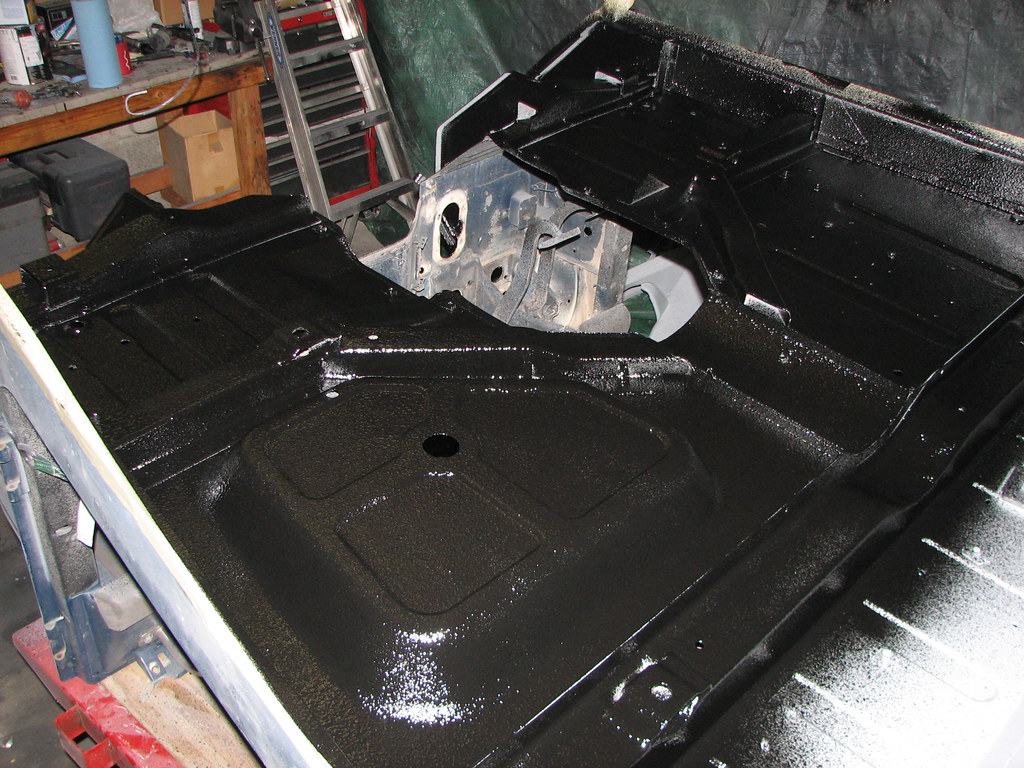

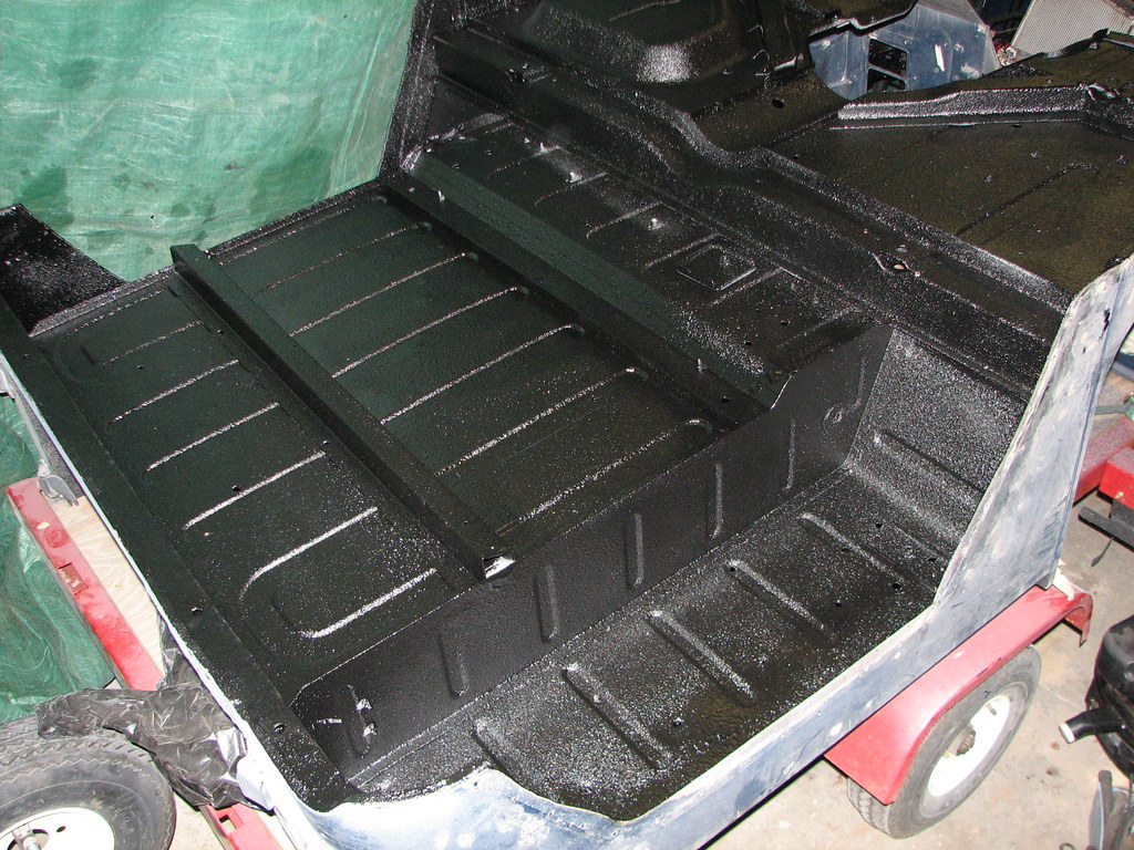

Thanks for the info, I used Hippo liner on the inside of the tub, I just wanted a smoother surface on the firewall, I could really care less how smooth the underside is, Painting it all at one time is going to be the key issue.
Thanks again :cheers:

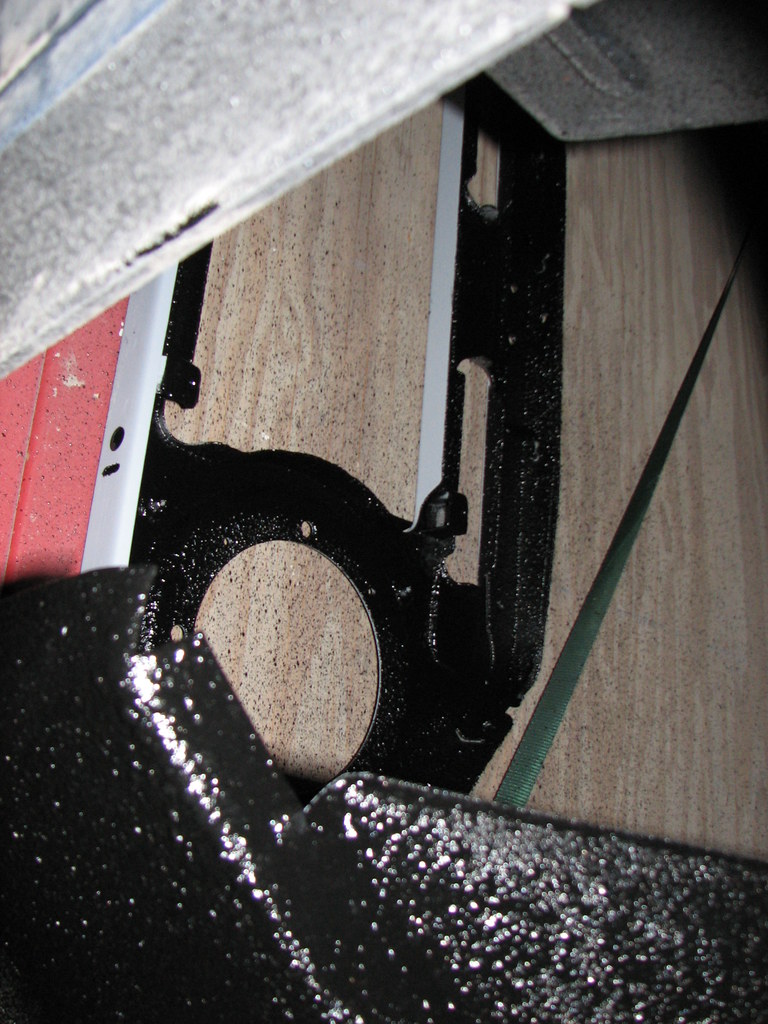

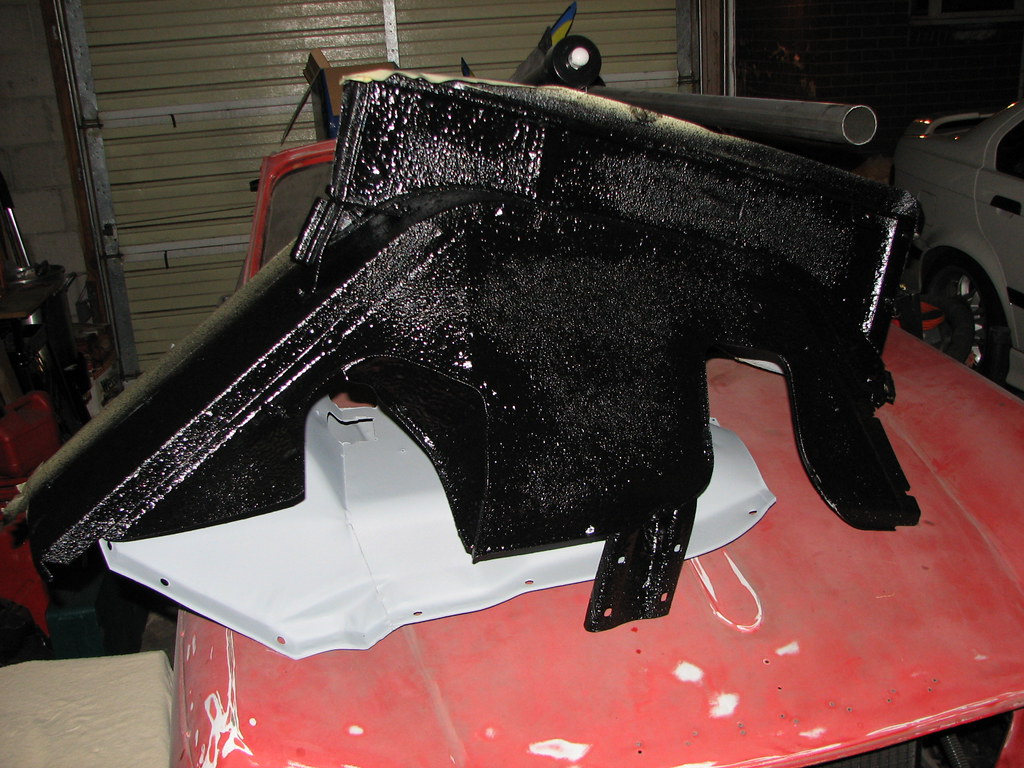

Been a busy week so far, I got another mix of hippo line and only finished about 1/3 of what I wanted to do...
As you can see, I still need to get in the nooks and cranny's, But Im happy so far.
I think I may need at least 2 more mixes, To get the fenders, Bib and trans cover finished.

I was thinking that I needed another coat of primer on some areas, Then I wasnt sure if I wanted a smooth finish or a glossy finish from the paint, I went with the Hippo liner and as you can see its not smooth and kind of shinny, I dont like painting, I know the hippo is fairly idiot proof, So I went with that :hillbilly:
I hope I answered your question :cheers:
