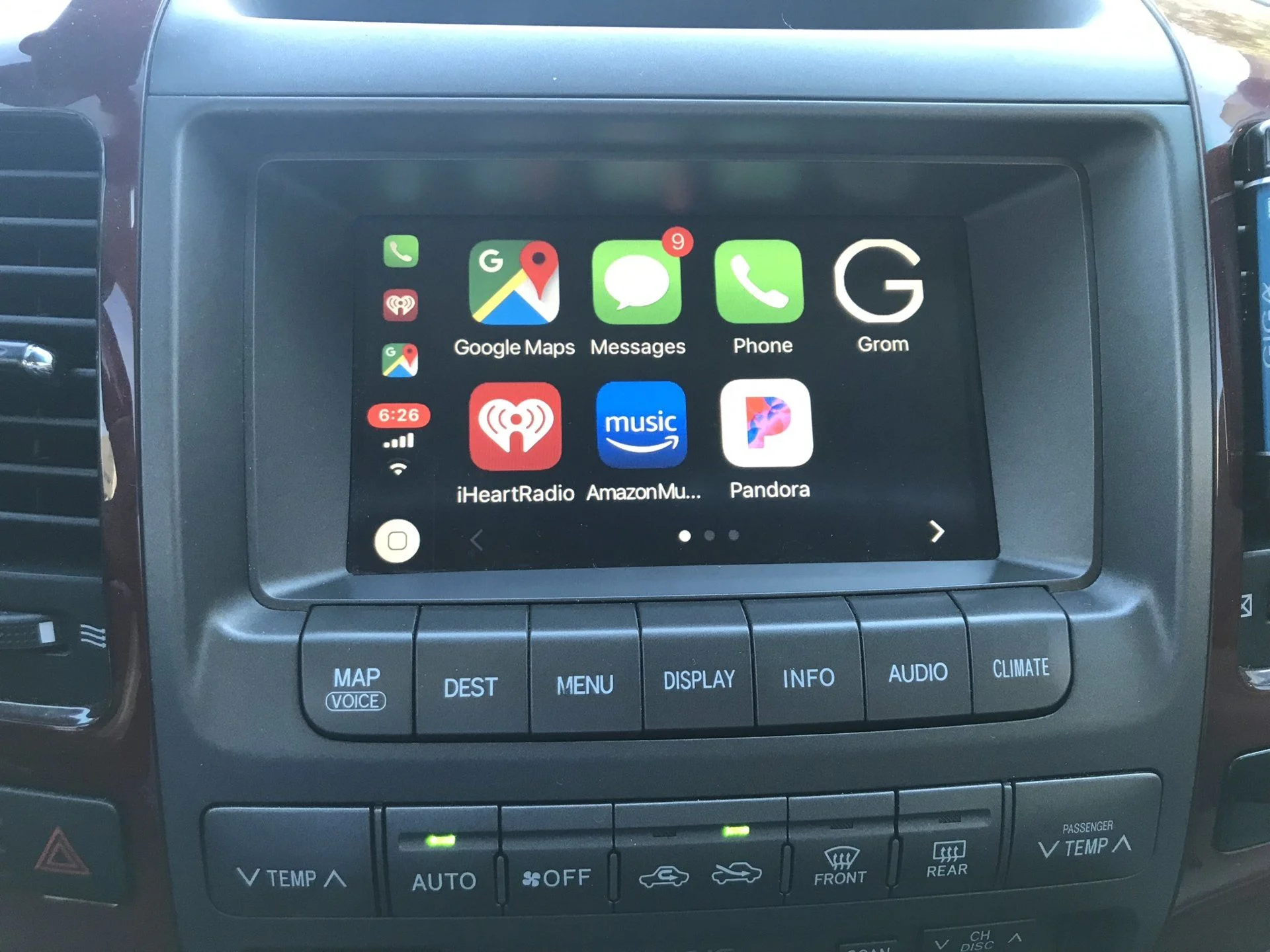

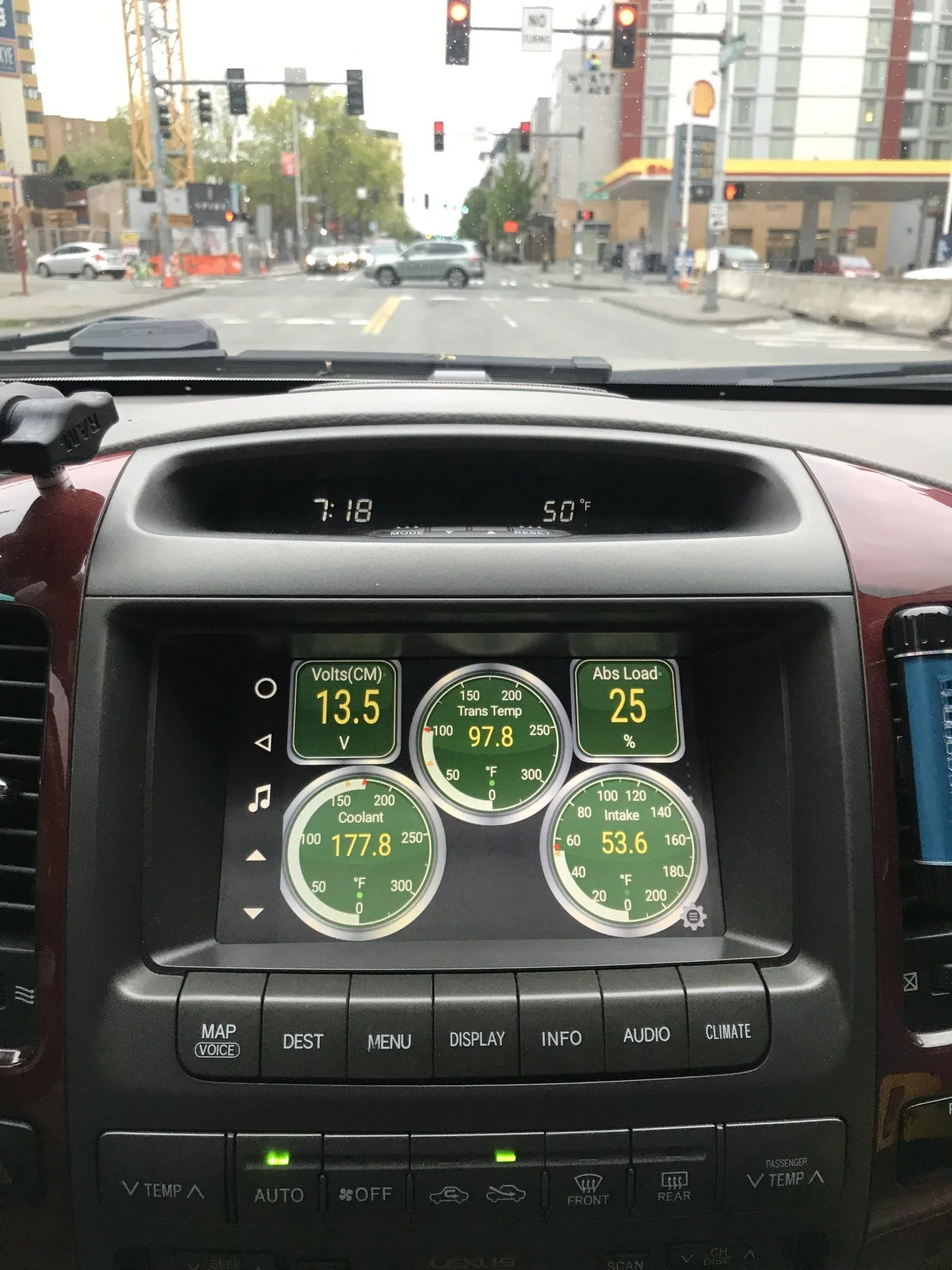

I have an ‘08 with Nav plus the GROM VLine2. For us it’s amazing. Google maps, iheartradio app, Amazon music app, TorquePro...
I’m sure others have a longer wishlist for their infotainment system than us but I don’t understand the time/money/hassle of swapping out to none Nav.
*edit: I understand the pre-2007 Nav units have a far inferior screen. I would understand wanting to upgrade that.
The quality of the display in 07+ models is vastly superior to the 03-04 and 05-06 versions. In addition, the display on my 05 is dim for a while when it first turns on - takes a while to warm up and become a proper brightness level.
The Vline v2 is also a relatively recent development. If I had an 07+ and the Vline2 had proper Android Auto support (which I think is coming), I would've likely gone that route. However, my display is so far behind an 07+ that it's not worth it.

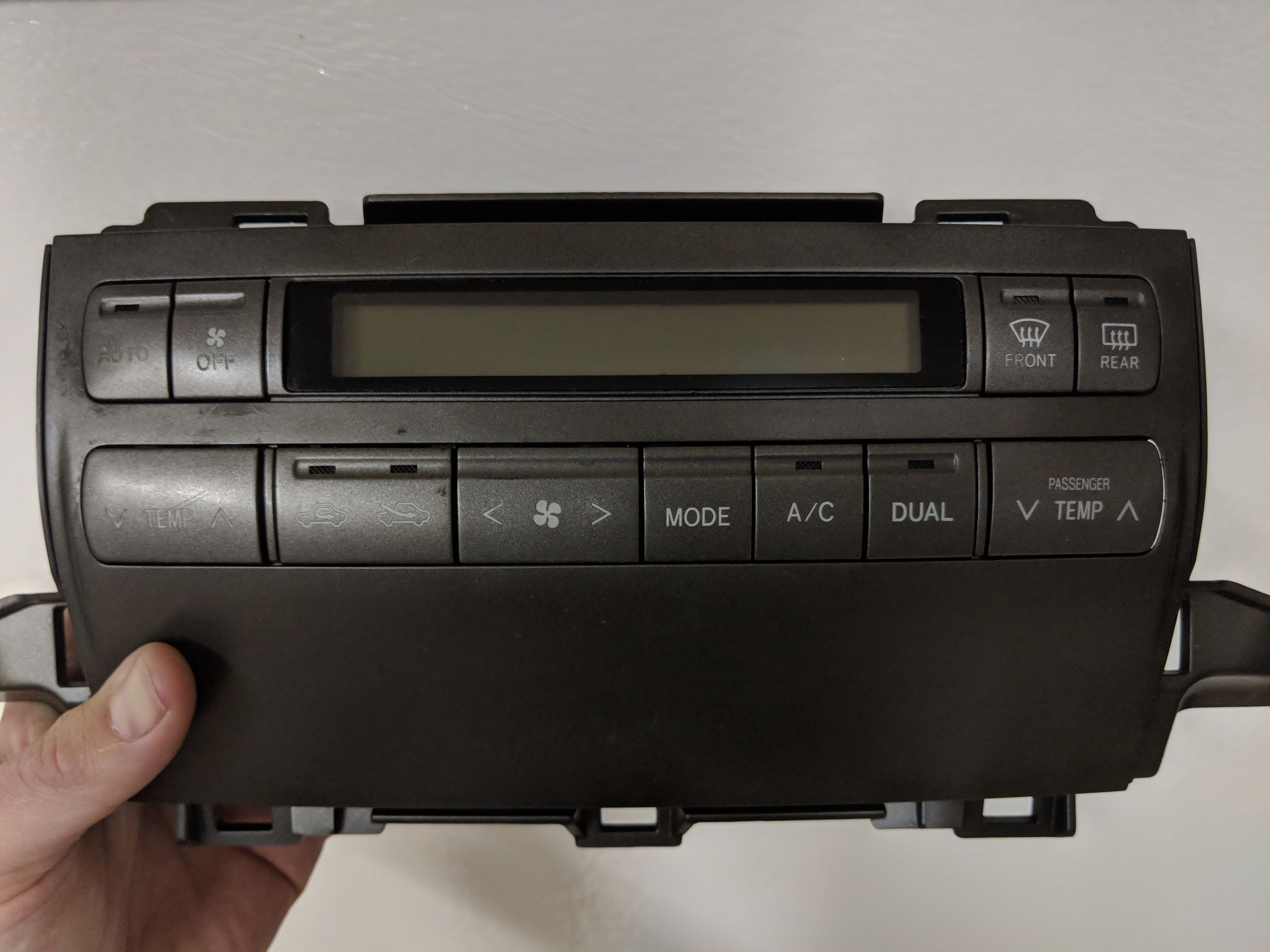

***Spoiler Alert*** The HVAC replacement controller costs $1300 according to this guys write-up.
Looks like ill stick with the Y2K Nav
Yes, correct for a new one. I purchased a used unit on Ebay with a warranty for less than $200.00 delivered. The conversion is fairly straightforward and well worth it, in my opinion.

Your '08 has a noticeably sharper screen than my '06, so on yours the GROM looks okay. From what I've seen of '06 and earlier GX's running the GROM, it's not good....

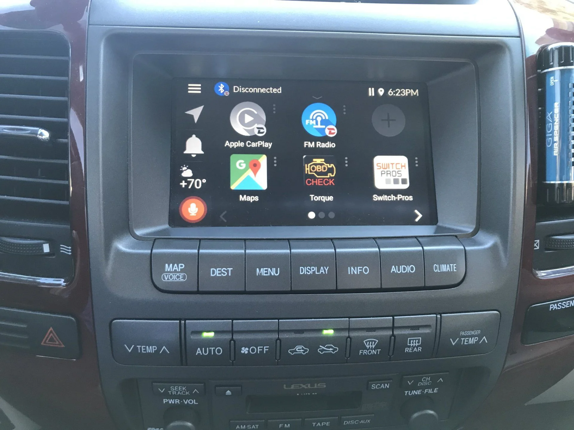

I converted to non-nav in my 2005 and the only thing I would do differently is _not_ get the Alibaba Chinese 9" Prado unit. I would just go with a standard double-din head unit. The angle of the screen on this unit really makes for some awful reflection and glare from the windows. I believe a more vertical screen, and a slightly more set-back-into-the-dash screen (similar to what a factory Prado Nav screen uses) would do much better. I'm contemplating swapping mine out.
interesting! i have the alibaba android headunit, so that will be going into my GX... i figure, the alibaba unit isn't too expensive, so as long as i do the heavy lifting on the climate control conversion, swapping to a different HU in the future should be pretty easy...
so going with the alibaba is a pretty low cost risk for me...
We added an anti glare film to ours. While not 100% it is much better!

I have a 2004 with Nav. I am about to pull trigger on a 2004 non-nav climate control unit from an online junkyard for $150.
If anyone has the wiring diagrams for a 2004 non and non-nav, please PM me. I'll buy you a beer, or send you a PayPay tip for your time.
Please post up your own updated write-up, or update this post. Thank in advance.

As far as stereo adapter, so for this specific 9" android from Alibaba, for the GX (and I think also the Prado 120), you need to also order the optional CAN-BUS adapter. With that adapter, it just plugs right in to the existing oem harnesses.
